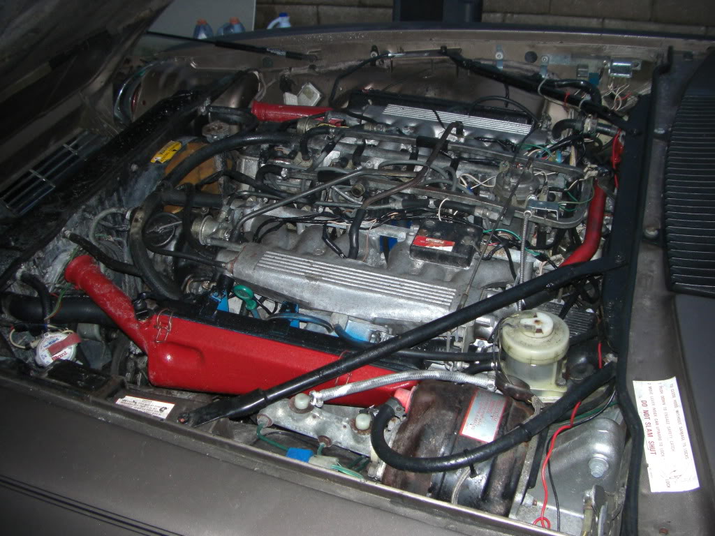

i hope. im going to go through all the wires on sunday and make sure theyre in proper firing sequence. im going to check the injectors for pulse and the harness for voltage. then im going to remove the distributor cap and make sure the timing is in the ballpark. any other suggestions? i know that one member (maybe JameyXJ6) was having some serious ignition issues a while back dealing with his amp and only running on 6 cylinders. i forget exactly.

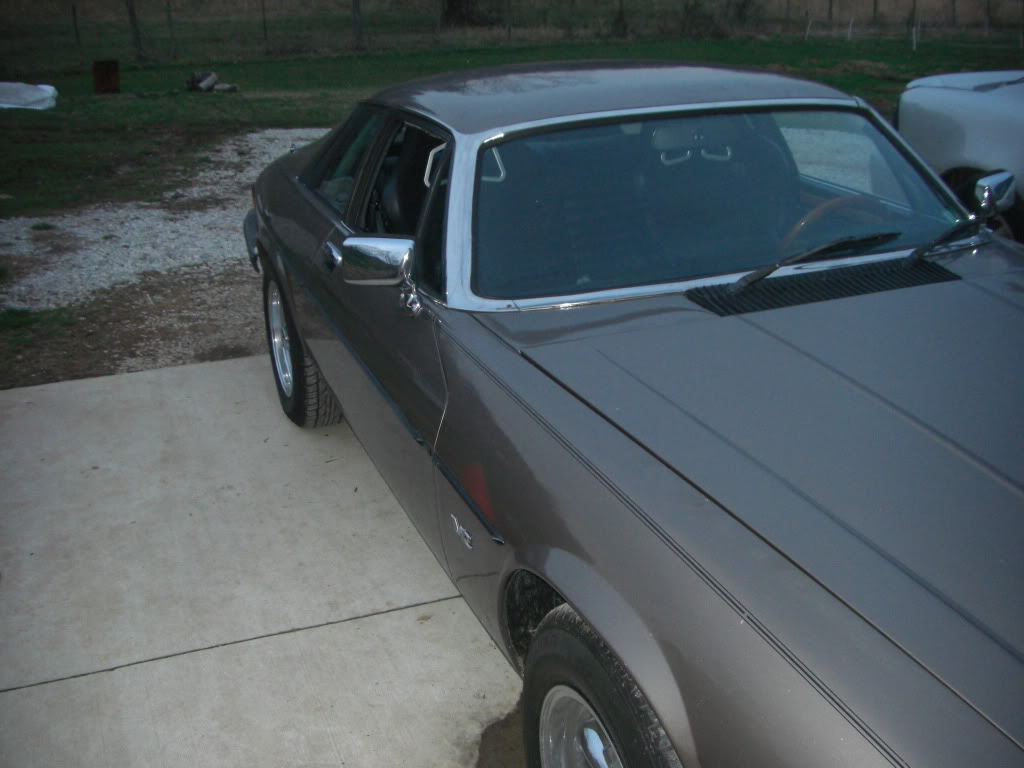

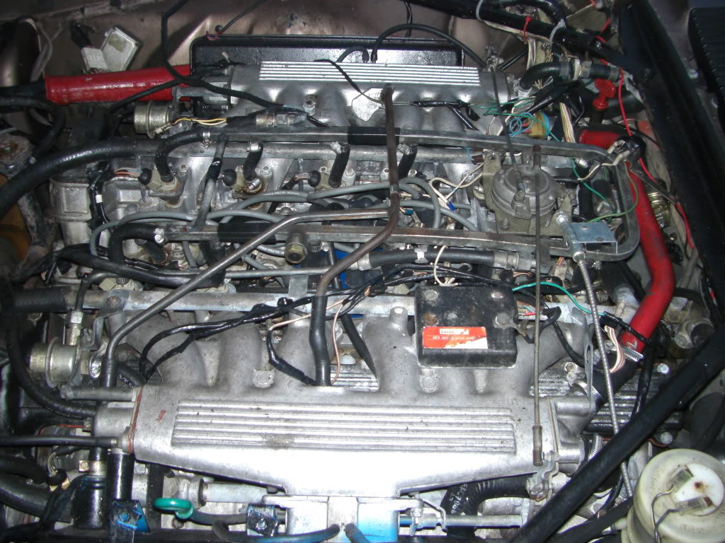

Sorry for the dark pics. i took these as soon as i got home (after being on the road for 12 hours)

Car looks nice. Congratulations

1. Backfiring - check O2 sensors, if one bank is not giving any voltage feedback to ECU, it will backfire and motor will make all kinds of knocking here and there.
2. You have some "custom" harnesses, I see. I would check if injectors are firing in quadrants, 4x3, by pinching actual injector body with 2 fingers, you should feel the pulse.
3. You can only check if cylinder is firing, or not, by unplugging injector, when motor is hot. When cold, cylinder "borrow" enriched fuel from the neighbor and manage to fire, even if their own injector is dead.
4. I see that someone already played with your fuel lines and put those little clamps on the short tubes, that go to injectors. This is nice, but I also see that your injectors are original color, so chances are that some of them are junk.
I have 11 good, old injectors in my stash, I soaked them and ran them with choke cleaner on the open air, they fire well, if you need a few, I can hook you up.
5. Lastly, check fuel pressure and how clogged your filter is, you might have so much junk in your filter and pump might be weak too.

90k miles, no rust that ive seen except for a penny sized blemish under the rear fenders. the rear glass leaks just a bit. $3,500 is what i paid for it. its got some Cobra type racing seats and a NADI TOURING stearing wheel thats brass with a wooden handle. the interior has been redyed black. the wood is pretty rough but the leather is very nice all around. original paint. turn signals dont work, rear running lights dont work, and the fuel gauge doesnt work. other than that and the engine issues, theres very little electrical issues. the kickdown needs adjusted, and the engine wont upshift unless you let off the throttle. could very well be TPS.
it has all new ball joints, rack and pinion, tie rod ends, etc. it drives extremely nice, very comfy, and suprisingly firm. i couldnt be more happy with my purchase.
i do have an OXY SENS light on, and only 11 injectors are pulsing. i havent switched the harnesses to see if the dead cylinder moves, or if the injector itself is bad. it has all new fuel lines and a new fuel pump. the swirl tank has been bypassed. the tank has been relined which is very nice. theres barely any gasoline smell in the trunk.
ive been assured that all the injectors were ultrasonically cleaned, but what good is the sellers word? some evidence that they have been cleaned is the new fuel lines.
if thats true, and given the fact that one injector isnt firing and the other 11 are of varying pulse frequencies in repect to each other, then i would say the harness is toast.
but i might vary well take you up on those injectors.
considering the fact that the performance increased slightly and the Bog went away once i disconnected the line to the ECU, then im certain its a fueling issue.
ive also been assured that the oxygen sensors are new. so if thats true then it would have to be a wiring issue to the O2 sensors, or he couldve lied.

well i deleted what was left of the EGR or air injection system. the air pump has already been removed by the previous owner.
cylinder 2A officially has a dead injector, so ill be needing one of those. theres lots of brittle and broken wires all over the engine bay.
