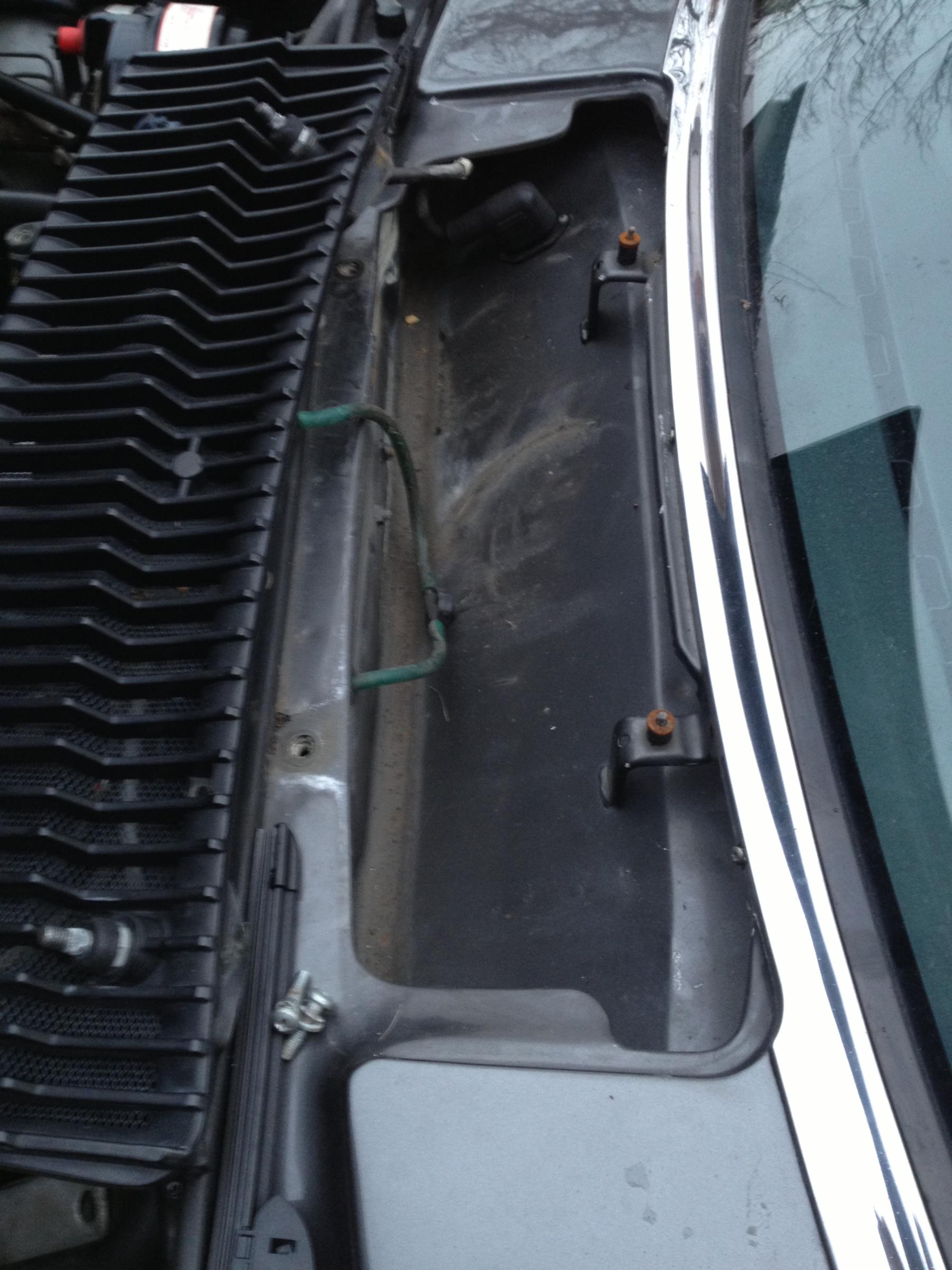

A pillar leak:
Seemend to be coming through the bottom corners of the windscreen, and dropping next to the dashboard.
Taking off the a pillar cover showed and overlap between the a pillar and the joint for the front section. filled with Silicone.
Check the wiper grill drains they were fine, and the evap case drains were bone dry, no moisture around there either.
also sealed the joing between the windscreen rubber and the car metal work, but not the rubber and windscreen itself.
Agree with the WD40, as the moisture sometimes drips from the joint between the footwell vent and the heater controls.
haven't managed to get under the car yet to see if the evap drains are fully clear - but imagine that if they were blocked, then water would come out of the drain connections? Or would it build up and overflow elsewhere....Doesn't sound good if it did.

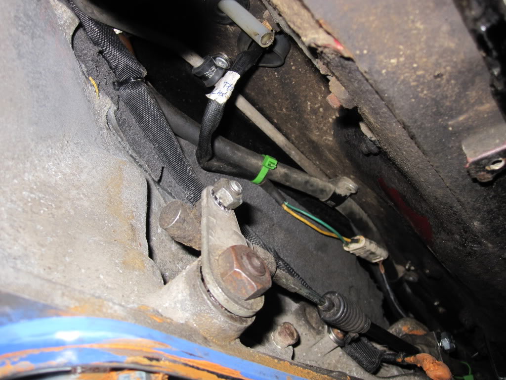

It fills up a flat tray beneath the aircon unit and then slops over the side and down the tunnel side to the floor - about where the footwell vents are...
The drain pipes are hard to see, but from underneath they are each sdie of the bellhousing/gearbox, but do not poke down very far at all. A thick wire poked up usually results in a wet arm as the blockage is cleared. You can just see the last inch or so of the drain poking down in the top middle of this photo:
Greg

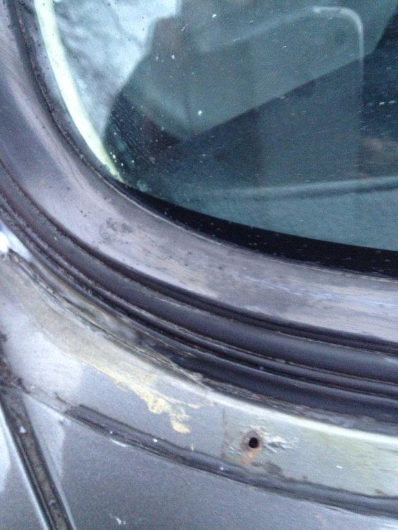

I think you can see from the windscreen pic that the corner seal isn't quite as tight as it should be? I have sealed that area, but are you now saying that I should re-seal between the glass and the rubber?
Yes, exactly so. And unblock the aircon drains, in case they are to blame.

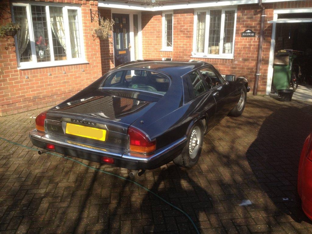

Default Doing What Cats Do Best - Leaking and lazing in the Sun!
Many Thanks for the help regarding windscreen and condensate drains.
resealed between the glass and rubber over the weekend, to the masts out to dry, sealed the back window and checke condensate drains (clear).
So, as it was a lovely day on sunday, and the big cat has not had so much cosmetic attantion for a while - she got some!!
The passanger door card was re-done by myself a whle back and seems to be okay.
P.S. Cats can scratch!! - removing the windscreen chrome top piece left me with numerous cuts and bruises!!
Attached Thumbnails More Water-img_0557.jpg   More Water-img_0558.jpg   More Water-img_0559.jpg   More Water-img_0560.jpg   More Water-img_0561.jpg

Congratulations, loveely looking car, now for a wet day and a real test!
