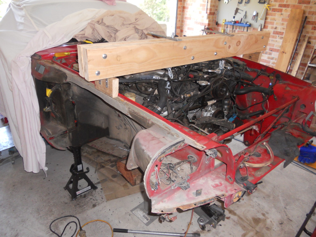

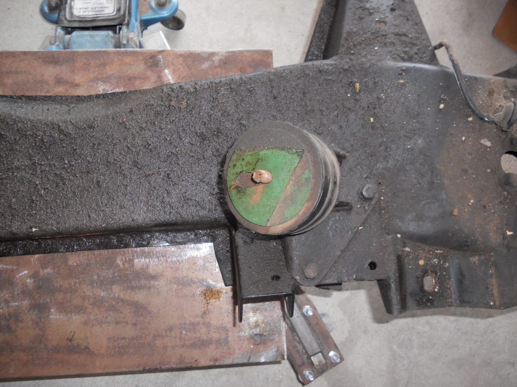

It is easy, Pop a jack and block of wood under the sump unbolt the engine mounts and jack the engine off the mounts. It is a bugger of job and patience is needed as with any repair on a Jag.
The rubber mounts are held to the engine and subframe by one nut on the top and bottom.
