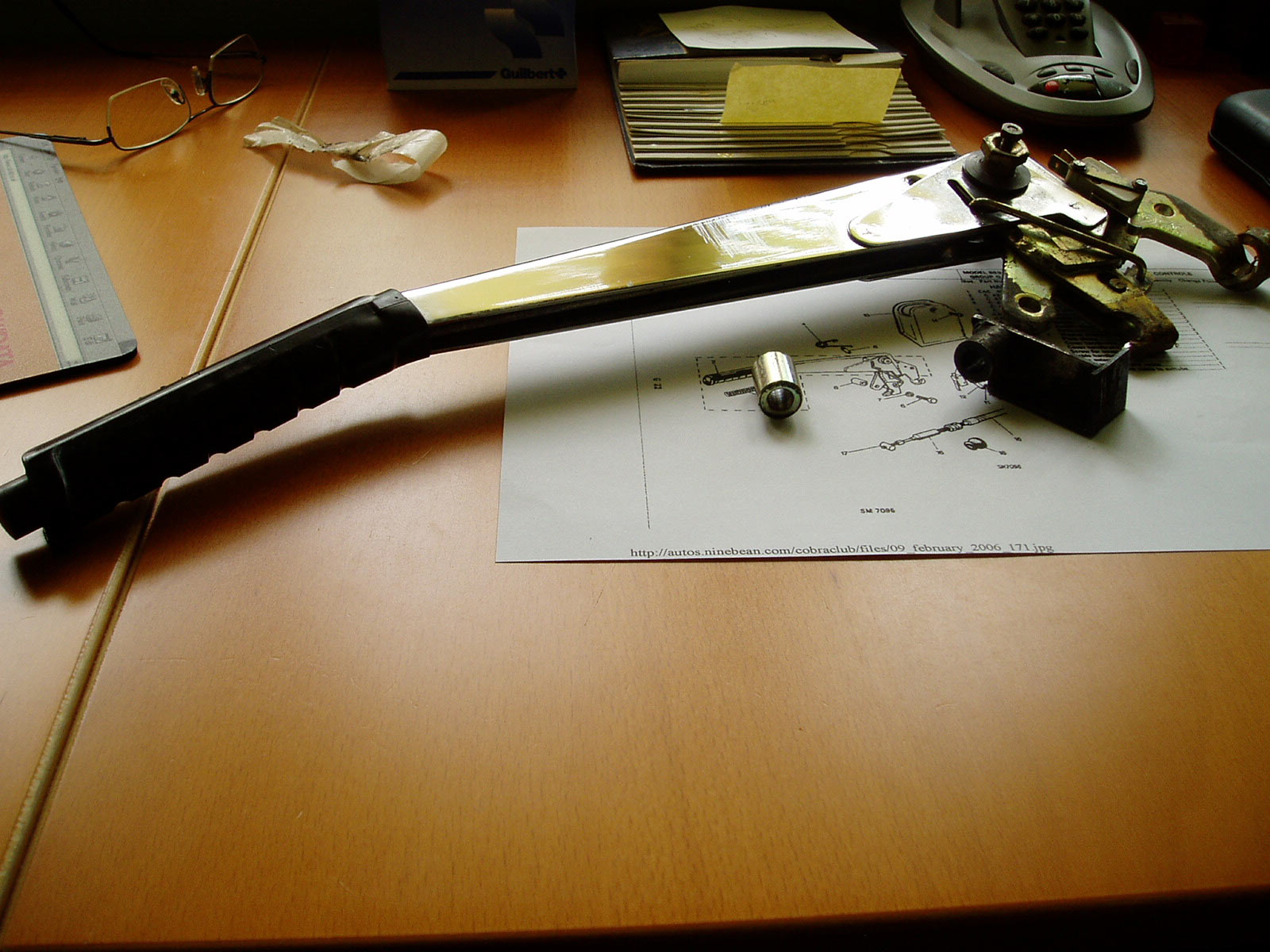

JLG, it sounds to me that your lever is out of adjustment, the button is spring loaded and should extend beyond the handle at all times so you use your thumb to push it.
It is possible that the plastic sleeve has ridden too far forward thus covering the button.
You could always try and glue a piece of round plastic (or a nice piece of varnished wood dowel) to the end of the button to extend it a bit!
