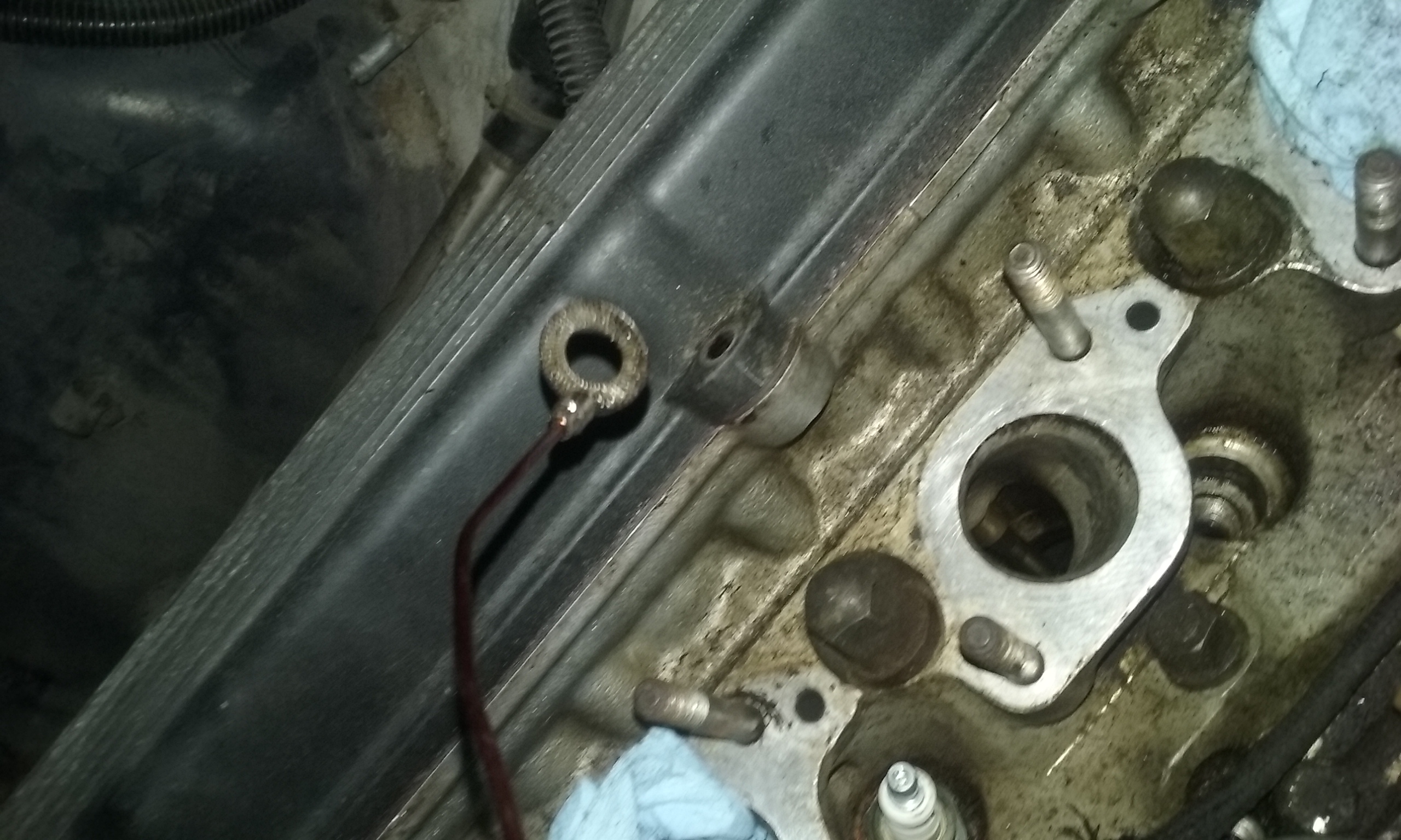

This is my lucky day. I bought my 1976 XJS in September 2017 as a teaching tool so I could learn how this V12 works by taking it apart. Then I considered just getting it running and leaving the block together.
Today I used my new borecam to check on the condition of the pistons and cylinders and look for dropped valves. What I found was a little washer in one of the cylinders that helps me make my decision. The engine is coming apart. Yeah!
It is a good day.

You can get that out through the intake valve with a long magnet. I did the same as one dropped in there...

That washer is off the intake manifold. They have that sunburst style ridges. I’d leave it :P. Imagine how many XJSs have one of those in a cylinder?

It was exactly the same style washer. Turn the engine by hand untill the intake valve is fully open, push a flexishaft magnetic stick in and click. You have it.

Finally got the silly washer out. All I needed was the right tool. Didn't even need the bore cam.

I still wonder whether the washer would eventually fly out through an exhaust valve.

Yes they will sometimes pop out through the exhaust. I have pulled the spark plug out of that cylinder and shot several out the plug hole. It's very seldom that you can't get one out. That is depending on the size. The magnet trick is nice if the intake port/ shape will allow you to get in there. Spent many an hour retrieving a dropped screw or washer.

Something like that washer would mkre likely end up crushed into the aluminium of thr cylinder head surface.
