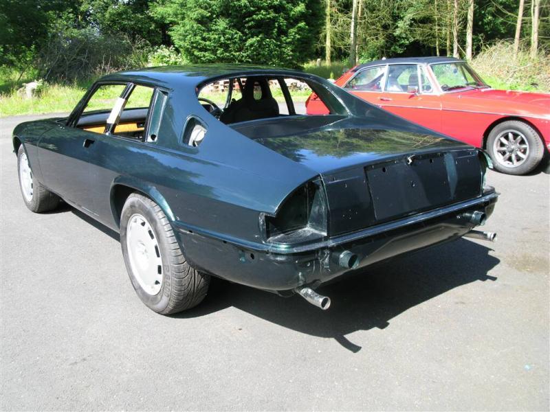

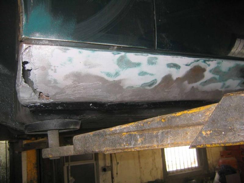

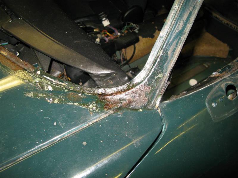

I came across a 91 with 4 months tax and MOT left on it from Liverpool (which is about 40 minutes from where I live) that looked ok but had obviously seen better days. It recently had the head restored with a bill for around £400 as proof so as usual for me I bought it unseen for £560! I sent a friend with his low loader to collect it and when it arrived I realised I might have bitten off more than I could chew. It ran but overheated and the rust looked far worse in real life than it had in the pictures. So I got Mike (Michael Fare) who had restored my Mark 2 to take a look at it.

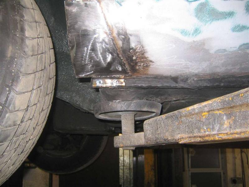

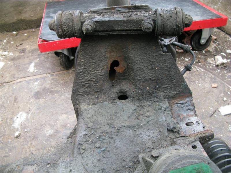

The front subframe was rusted through so I bought a restored one and completely rebuilt the front suspension and brakes plus bushes wheel bearings etc.
The interior had seen better days!

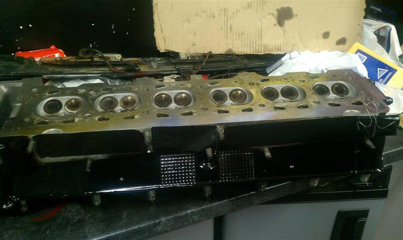

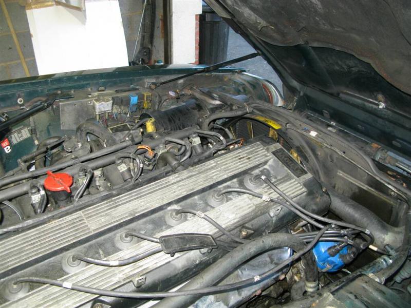

The “restored” head had a snapped bolt that someone had tried to Araldite together a leaking new head gasket and was a mess to say the least. A week later the head was back properly refurbished with a new head gasket that Mike fitted. It needed a new alternator and starter motor which is not the easiest job to swap, the thermostat was stuck open and needed replacing. I put on a K&N air filter leaving off the front “snorkel” part of the air box which sounds quite throaty now. Then I changed all the oils including the auto box which made a big difference to the down changes especially (a good cheap tip for anyone that has a sluggish gear change). I put on a new radiator and new air con rad as both looked perished. I tidied up the engine bay put a better heat shield cover under the bonnet had the cam cover sprayed green and fitted 2 new gas bonnet stays. I adjusted the bonnet to shut properly which required a new release cable between the 2 closures either side.

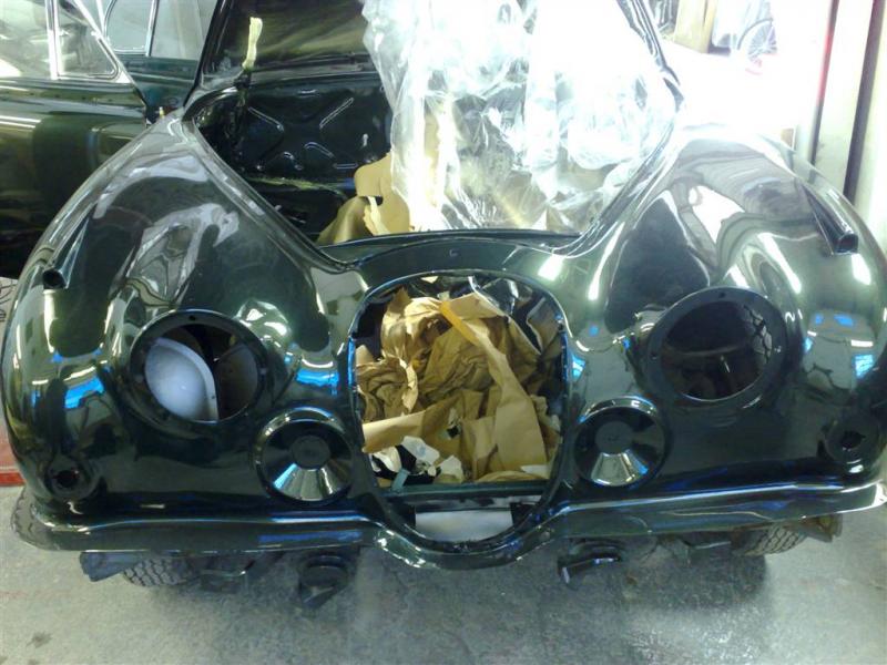

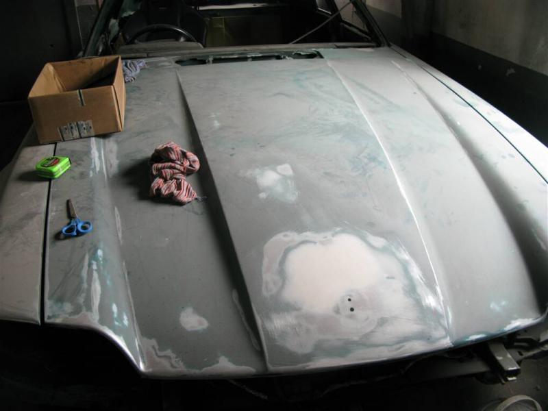

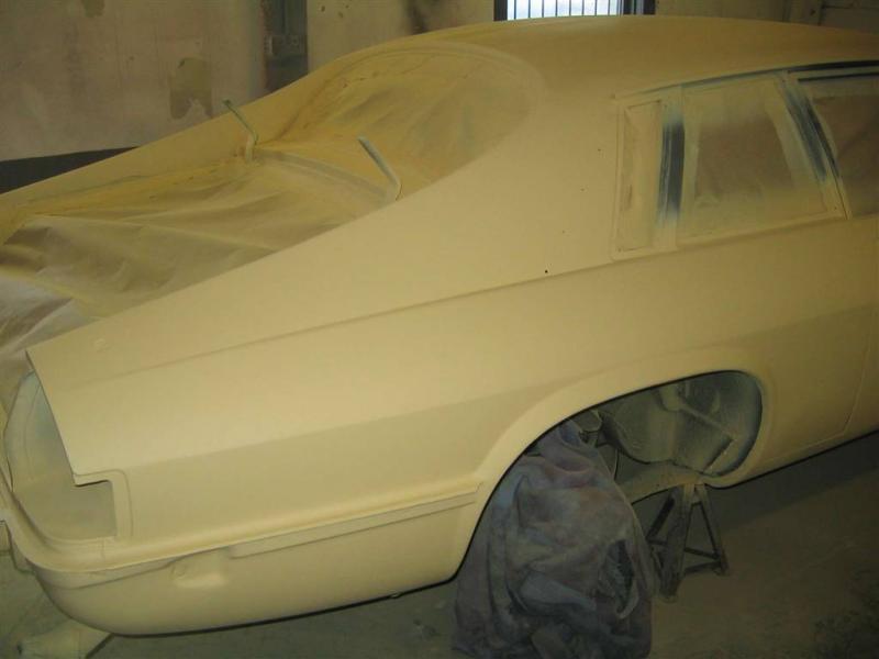

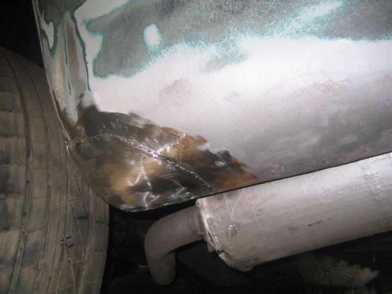

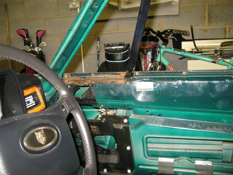

I then got a quote off John Seed who owns a local body shop repairers for a full body restoration finished in the same metallic BRG paint that I had used on my Mark 2, with an agreement that I took off all the body fittings, all the glass out and all the interior ready for him. I then realised why the quote to restore the body was so reasonable because unless you have done the job yourself taking everything out and off to get the car ready was a lot bigger job than I realised! The car was at the body shop for weeks as it was done in John’s spare time and needed a fair bit of work the only body part needed was a front driver’s wing as the original was beyond repair but he had a fair bit of welding and patching and I must say for the price I paid he did a great job.
I used Ray my usual glass fitter to take all the glass out and the interior was not that difficult but once I started on bumpers chrome strips, door trims, lights etc it became hard work especially on a rusty car. Certain bits of trim are no longer made so it was good old eBay and people like Grubblelogger that saved the day. The chrome strips at the bottom of the door glass are a typical example they are screwed in from inside the door so even with the glass out, which is a must, it is a pain the screws were all rusted up and had to be drilled then when I finally got them out I had ended up damaging both pieces of trim only to find out they are not available off the shelf anymore.

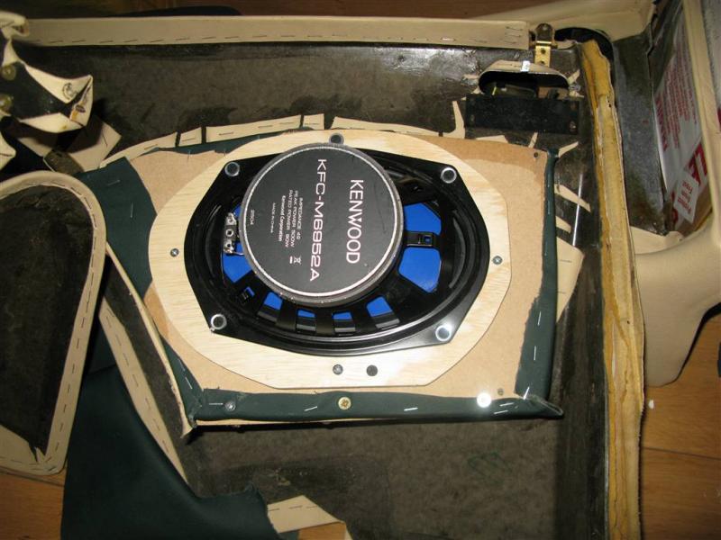

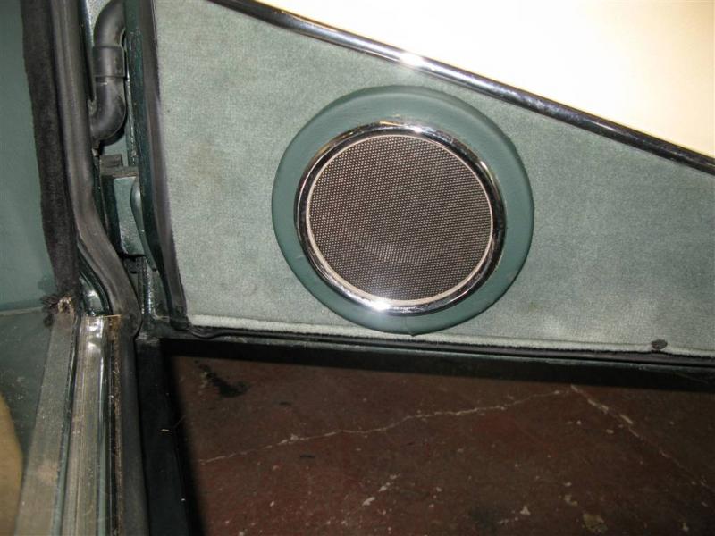

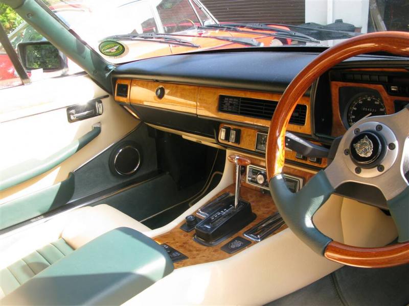

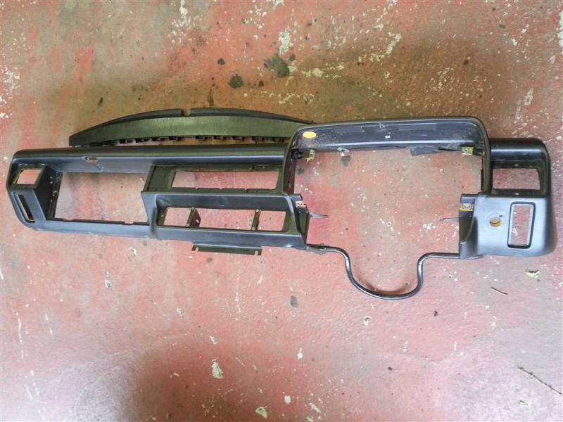

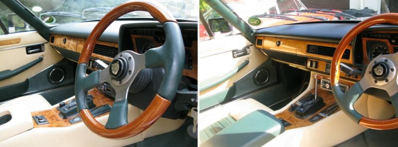

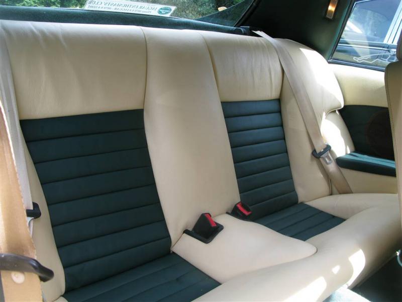

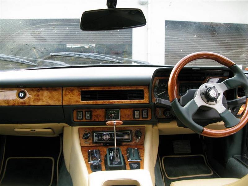

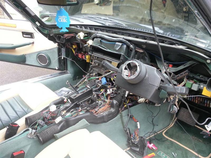

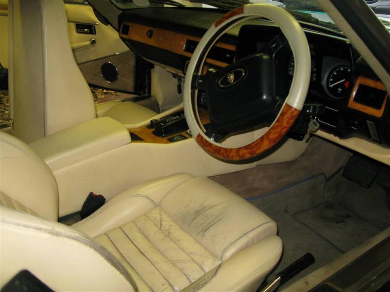

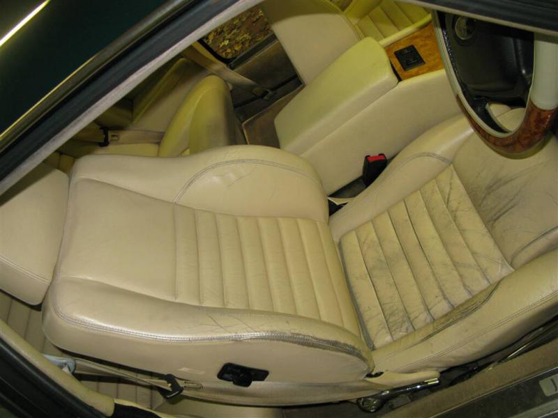

Whilst the car was at the body shop I started on the interior which was in a very poor shape with worn seats headlining hanging down and carpets that were well worn and dirty. I had the cream leather re coloured to save some money and bought new carpets with felt (including the boot) from Aldridge, I also bought 2 new door panels from them as the originals were perished. I bought 2 new original old stock seat bases in cream leather and I sent the front and rear seats off to Roy Dowd at ACT in Blackpool (who has restored more interiors for me than I can remember) to put green leather in the centres plus a new fibreglass headlining panel to be recovered in the same leather with the sun visors to match the seat inserts. I added new front seat belts in the required colour to match the rears, 2 new window switches a new armrest lid covered in green leather that I later changed for a phone type one so I could store things like my mobile without having to lift it up.
I wanted to install a decent stereo system with IPod and Bluetooth functions and also a 4 channel amp under the passenger seat. Looking at the rear speakers there seemed to be a lot of room between the side trim and the bodywork I adapted the pods with ply and leather so I could fit some 6x9 speakers’ flush which would sound far better than the originals. I jig sawed out some spacers in ply and finished them off with some old house speaker cloth to cover the holes, in the front door panels I put in bigger front speakers, which entailed using 2 more spacers that I trimmed in leather plus the original Jaguar chrome grills. I bought a complete set of new Elm wood cappings from Myrtle including the ski slope, instrument panel and heater controls. While I had the instrument pod out and in bits I painted the Speedo and Rev counter needles white as they had faded and I put bigger bulbs in to make the dials more visible with the lights on. I bought a 2nd hand door window motor as the drivers didn’t work plus lots of other new and used parts including front bumper corners and a full rear bumper as my chrome was very poor.

I had also bought a wooden steering wheel with black leather and a set of Jaguar alloys with the correct P6000 tyres for the car, the steering wheel had the black leather changed to the green and I had to fit front 15mm spacers for the wheels as they were catching on the inside. With having some spare green leather I trimmed the door armrests myself plus other bits of trim and the A pillars, not perfect but passable I would say. Once I had fitted the carpets seats and trim it looked great.

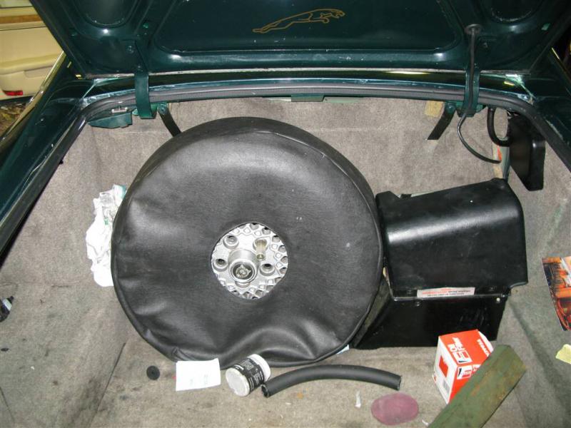

I bought a space saver for the boot and an original toolkit again it looked a lot better once fully trimmed.

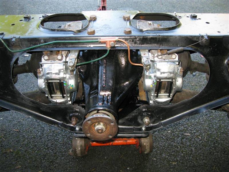

Finally a few weeks ago after 12 months on the road it failed its MOT with back brakes binding leaking diff and faulty handbrake so I ended up dropping the back axle having the diff sent away to be overhauled I also bought some new discs pads and restored calipers and the MOT was duly sorted.

Something tells me that you did not get all the rust out
My '82 was rusted in a very similar way, but it took a lot more digging and implantation from southern donor, to get all the brown crud out.
How much did you pay for the prep and paint, if you do not mind me asking. Paint job seems very nice.

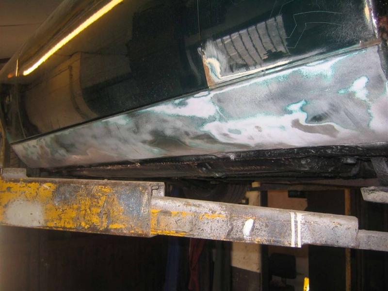

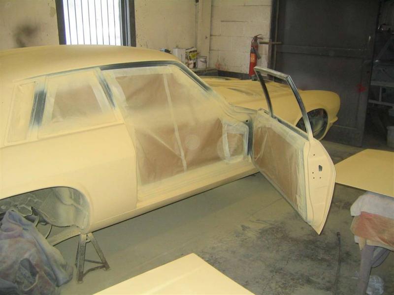

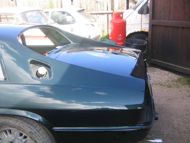

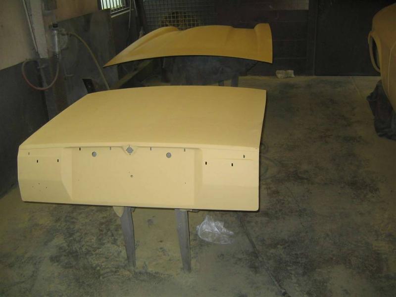

I prepared the car as in all glass out interior out all bumpers chrome work etc off which took a fair while the cost was £2500 for bodywork/painting which I thought was a great deal but the guy did it when business was quiet so he had the car several months. I have had bubbles around both rear arches that has been redone since the pics and as of today there is a small bit just appeared around a front wheel arch, it was painted nearly 2 years ago.
Quite a few pics to show the work as it was in progress at that time.

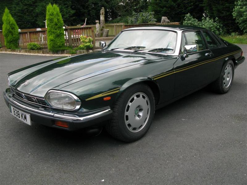

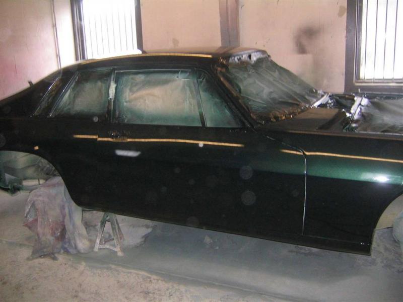

Some more when painted
IMG]http://i687.photobucket.com/albums/vv240/Toehold1/XJS/resized_127-2048_zps1092d135.jpg[/IMG]
I had it painted the same as my Mark 2 a metallic BRG a Range Rover colour.
I now have 3 classic British cars all in green the Lotus Excel is the Celebration green which is darker.
