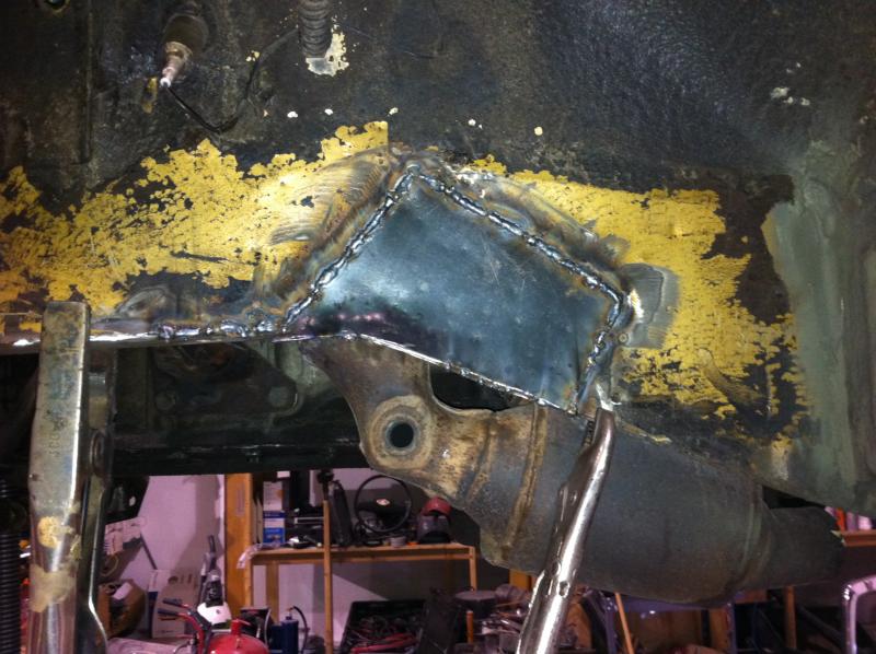

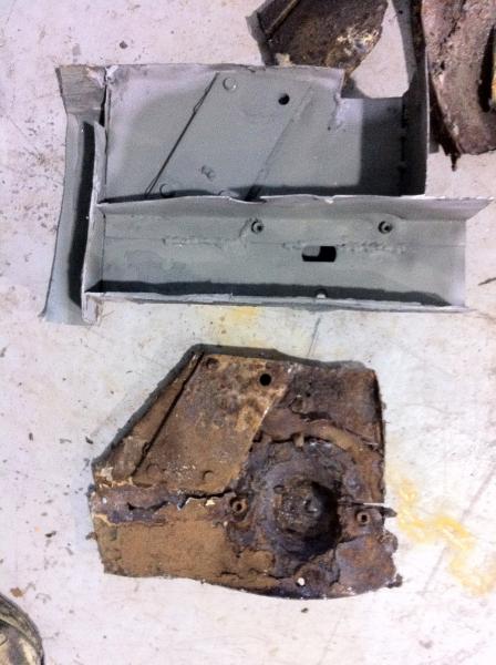

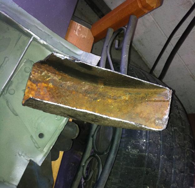

She is still not done, but little closer to being structurally sound.
Got passenger side trailing arm mount plate replaced. This side was not tampered with, but just as rusty.

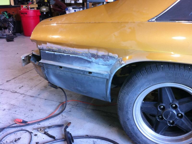

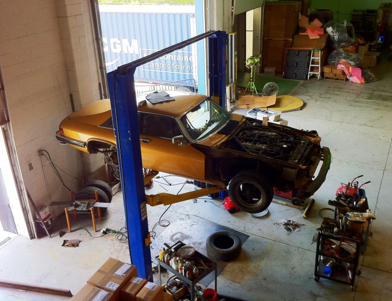

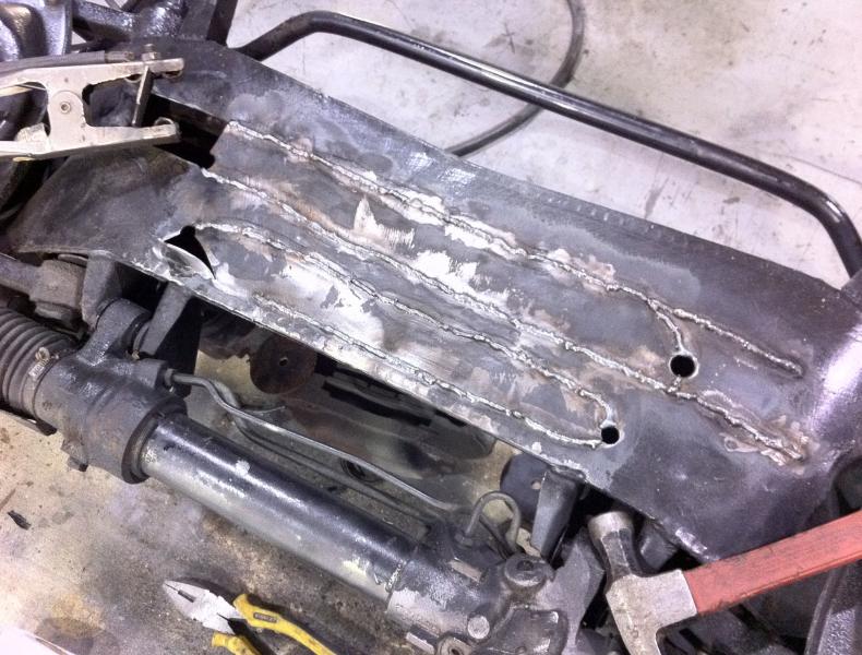

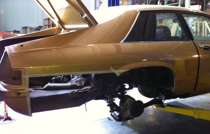

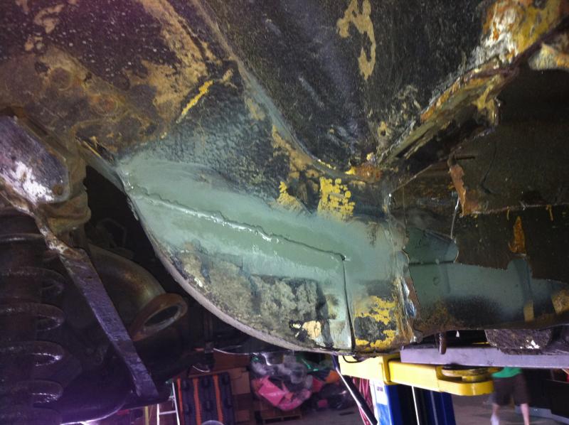

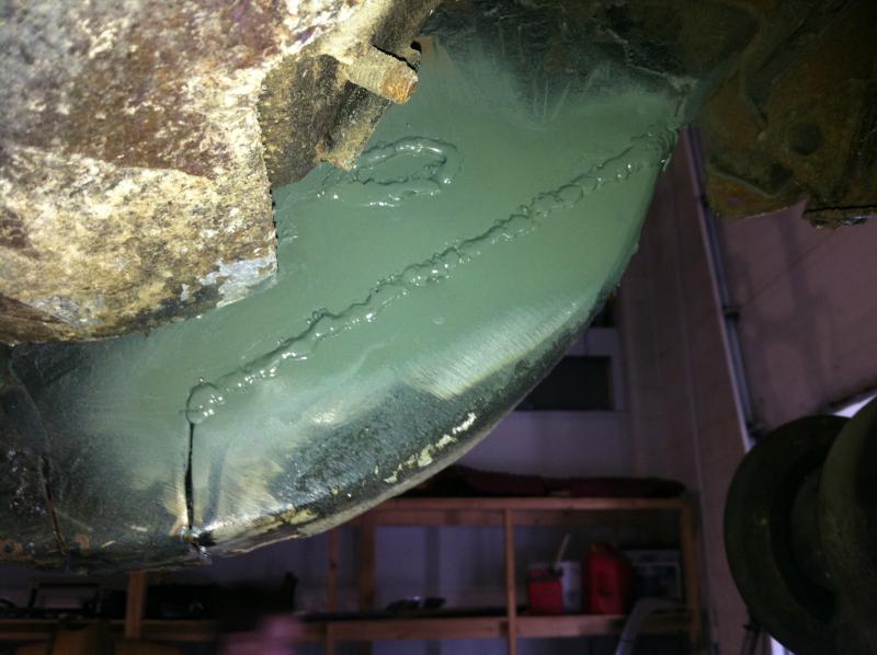

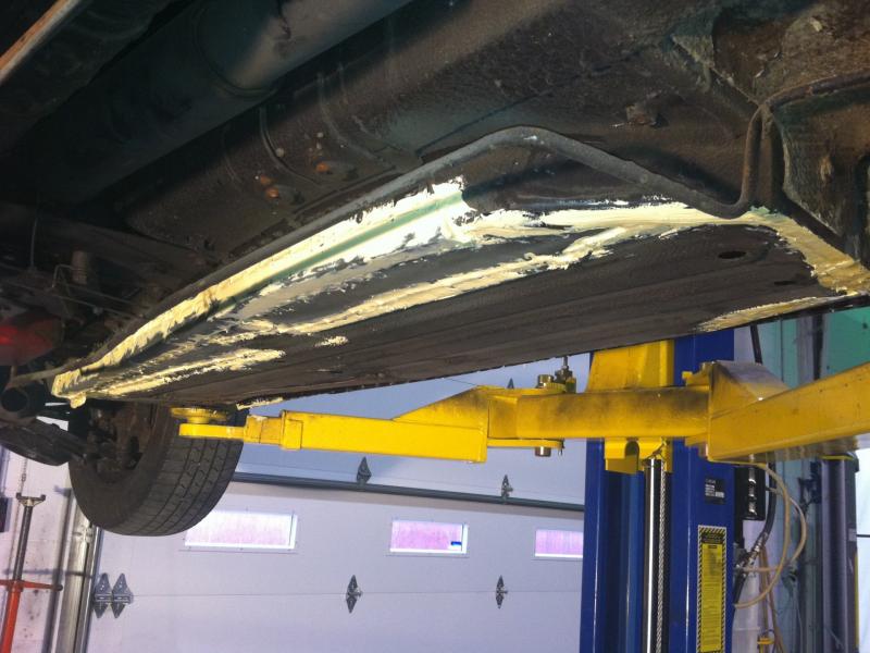

Did you miss me? Probably not, nevertheless, here is little update for you.

Some nice welding work there!

I she is half in primer now, will post some pics later on tonight, next step is aligning doors and making good gaps, cos these were hand built and new doors are from 1989, so nothing fits out of the box.
All cavities are already drilled for rust proofing wand insertion, soon she will be pumped full of yellow mist on the inside.

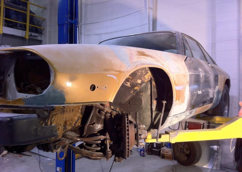

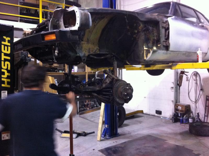

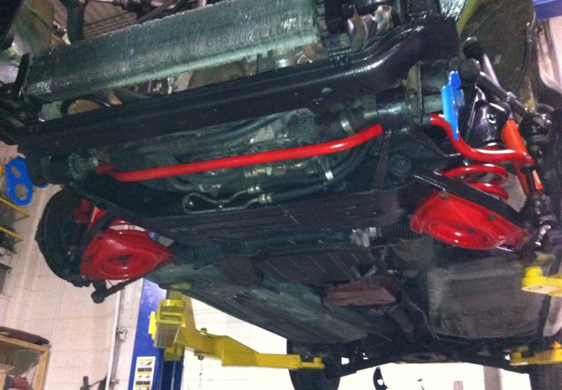

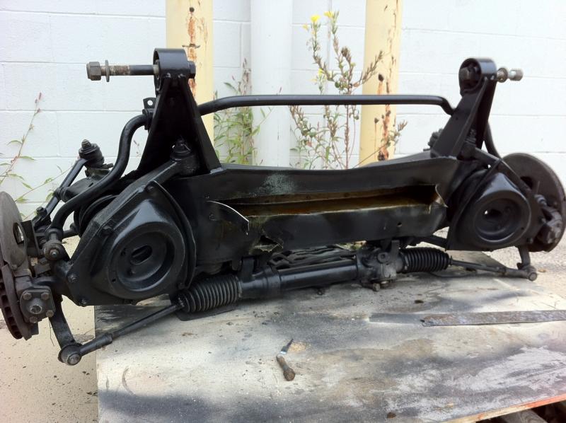

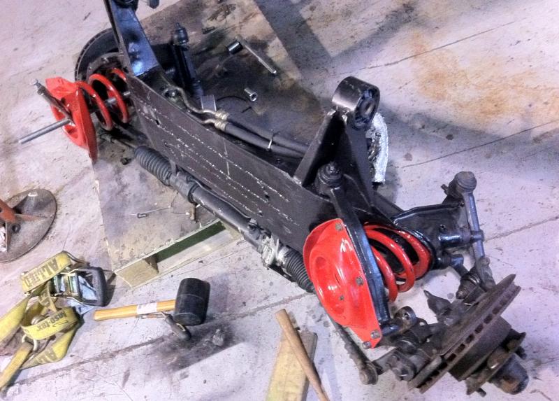

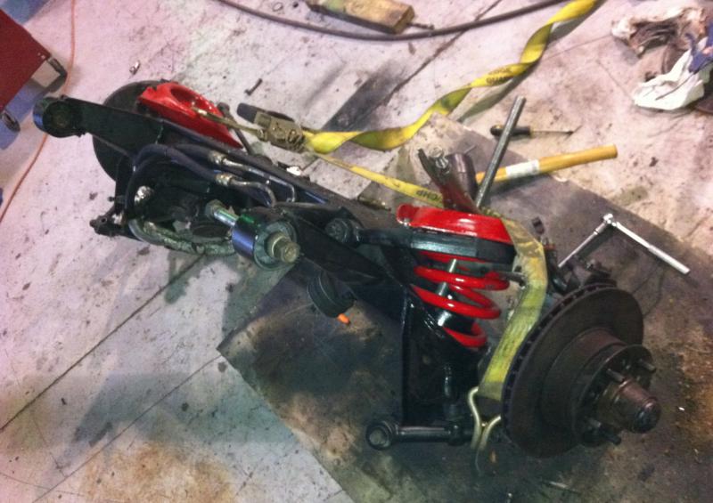

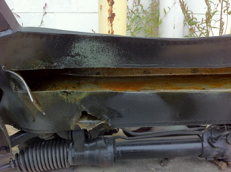

Here is what I got done this week.
Front end is down, motor and frame is being cleaned and refurbed, before new axle goes on. Please note how good inside the frame rail looks. I replaced one piece of metal, because it had some funny wrinkle on it, rather close to the front end mount.
P.S. Please do not tell me that I'm crazy, I am already told, twice!

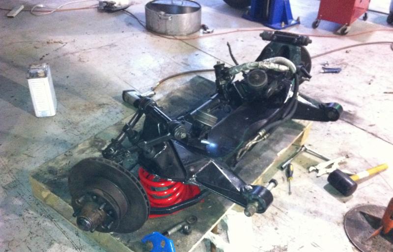

The front end is upon us... Them springs are two tough SOB's to squeeze in place.
Attached Thumbnails Is my XJS the oldest here?-most1.jpg   Is my XJS the oldest here?-most2.jpg   Is my XJS the oldest here?-most3.jpg   Is my XJS the oldest here?-most4.jpg

Good to see someone else with the bug and doing it right the first time, good work
