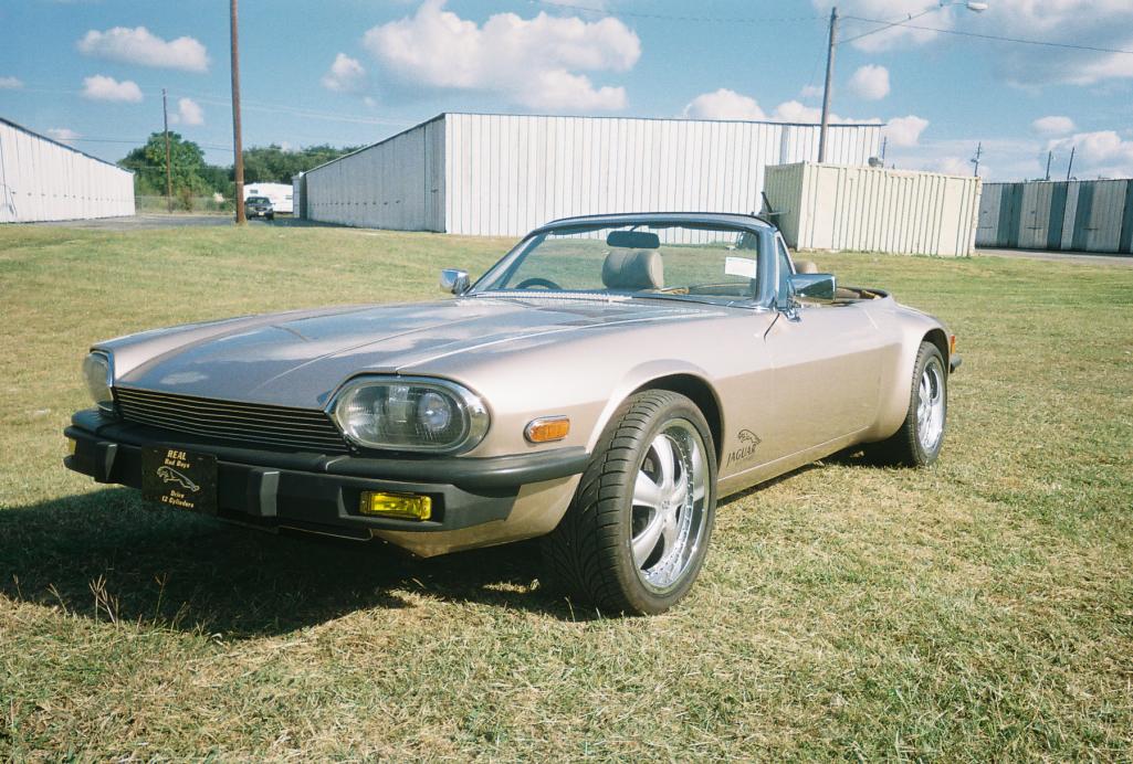

'82 and getting her plastic surgery as we speak!

Wow! I love that colour! I used to have an '82. Now I have an '87.Awesome car!

What are the specs on your wheels/tires. I like the look of those....did you have to have the center taken out to fit the hubs.

These are Ronal 16" rims, these were available back in 82 as dealer supplied option for new car. Center cups are intact and say "Ronal".

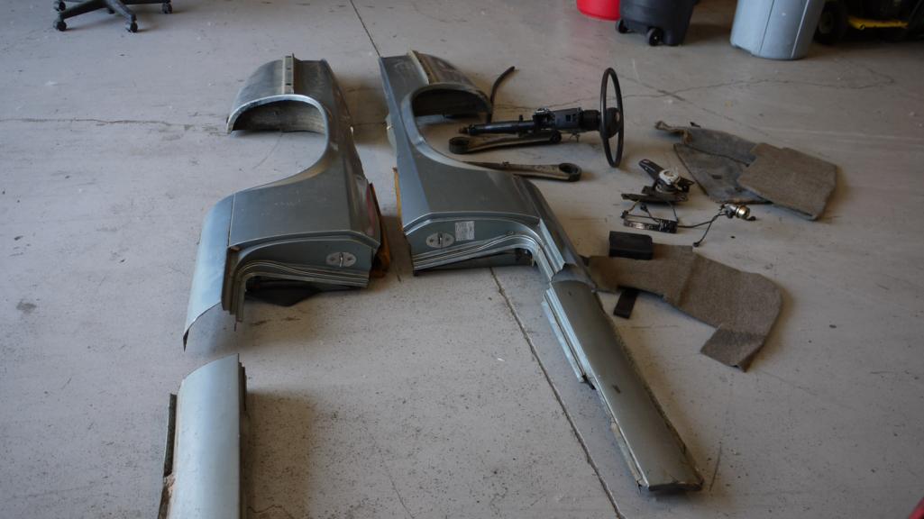

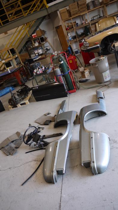

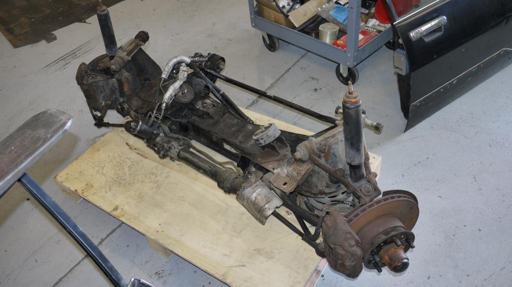

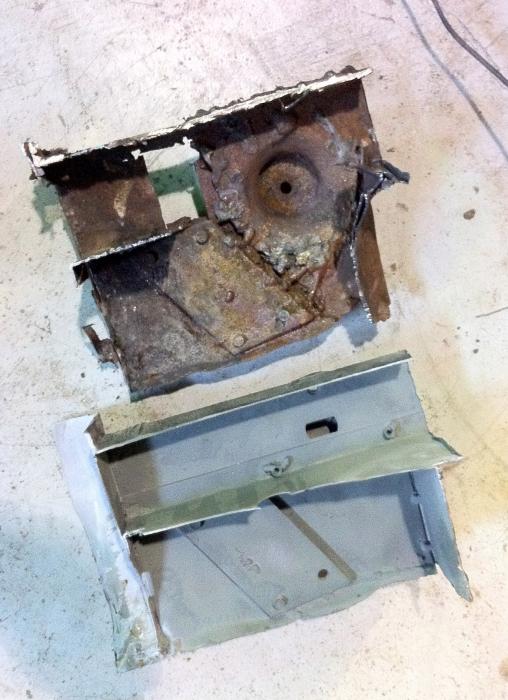

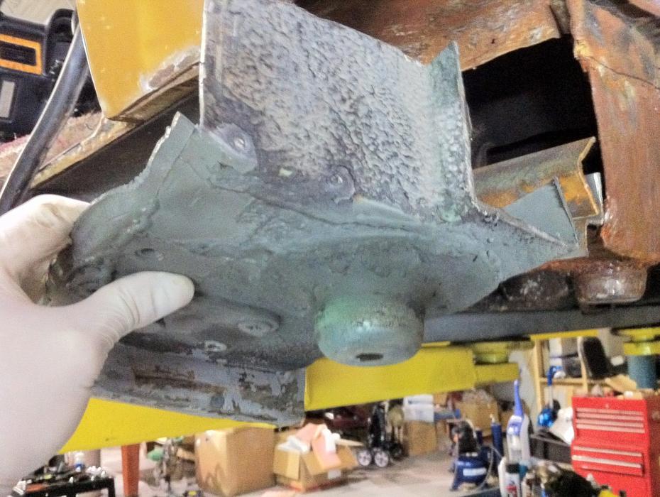

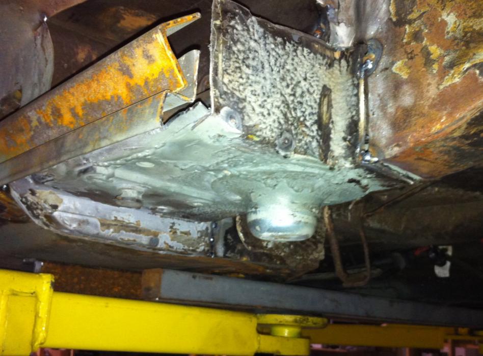

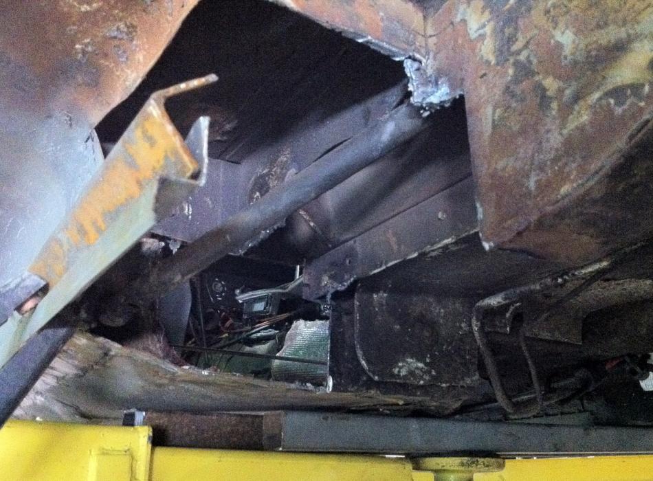

Not being blessed with Southern lack or rust, here is what I have for now.
This is stage one, currently car sits with front fenders and doors removed, rocker panels cut off, so I could weld in new inner rocker lips and also square piping inside the rockers, to stiffen up the old girl.
P.S. I did purchase car lift, just because these should be included with any Jaguar purchase, but for some reason I did not find one in original tool kit.

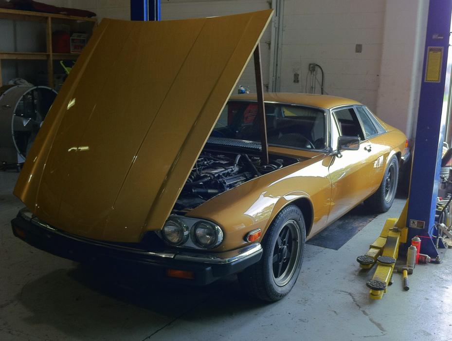

Here she is, still got it!

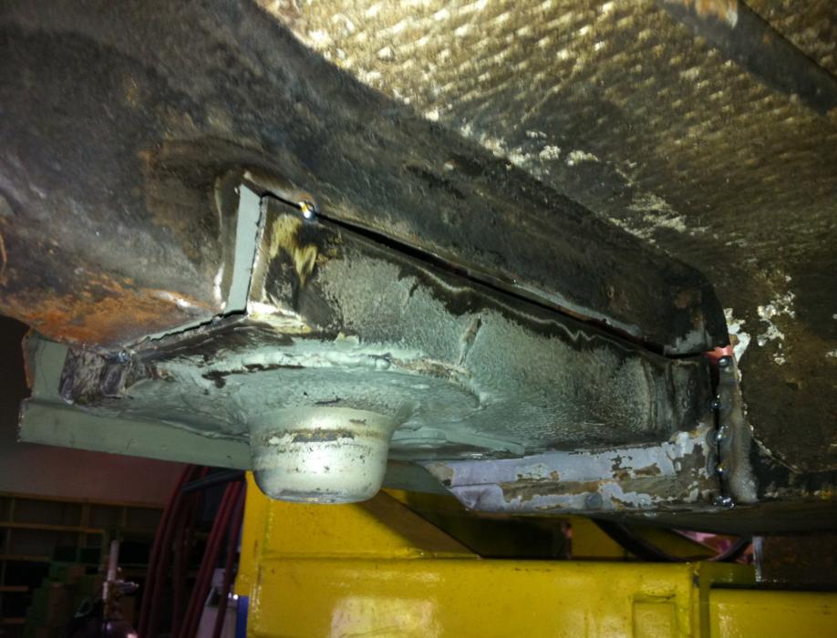

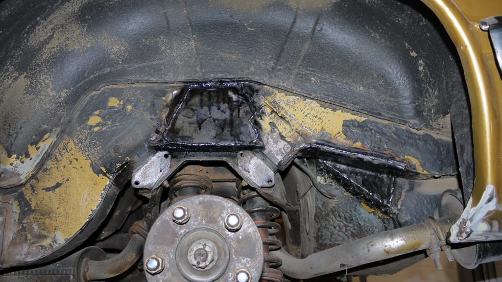

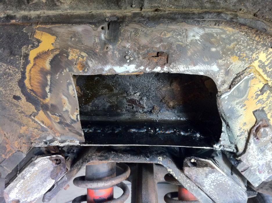

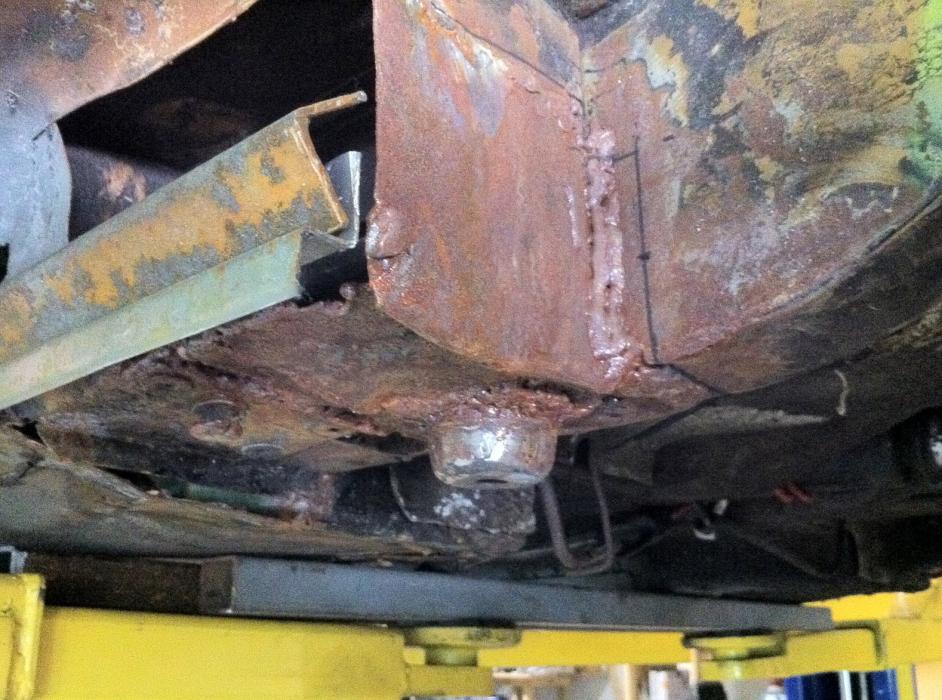

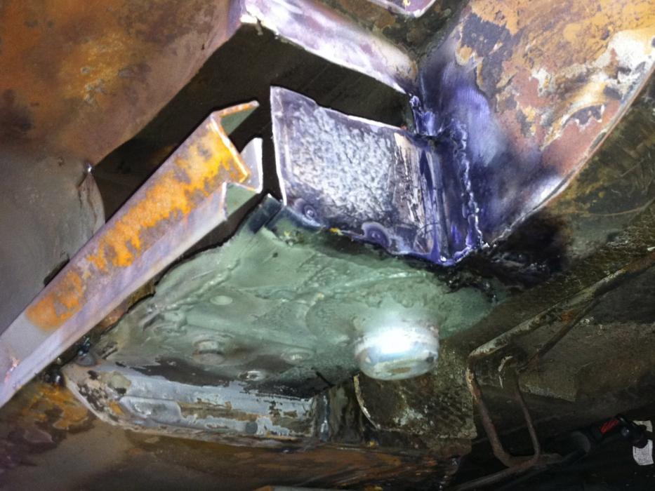

I know no one cares, but here little something I replaced yesterday, or why rednecks should never touch welding equipment...
P.S. work in progress, will tidy it up a bit

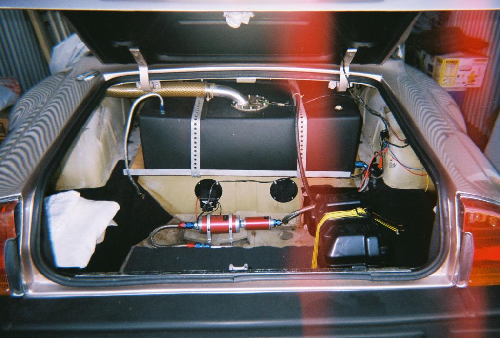

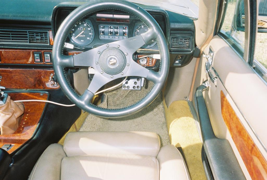

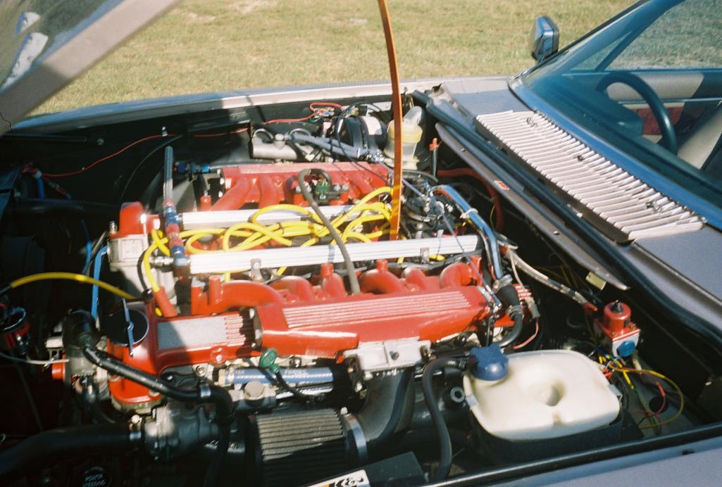

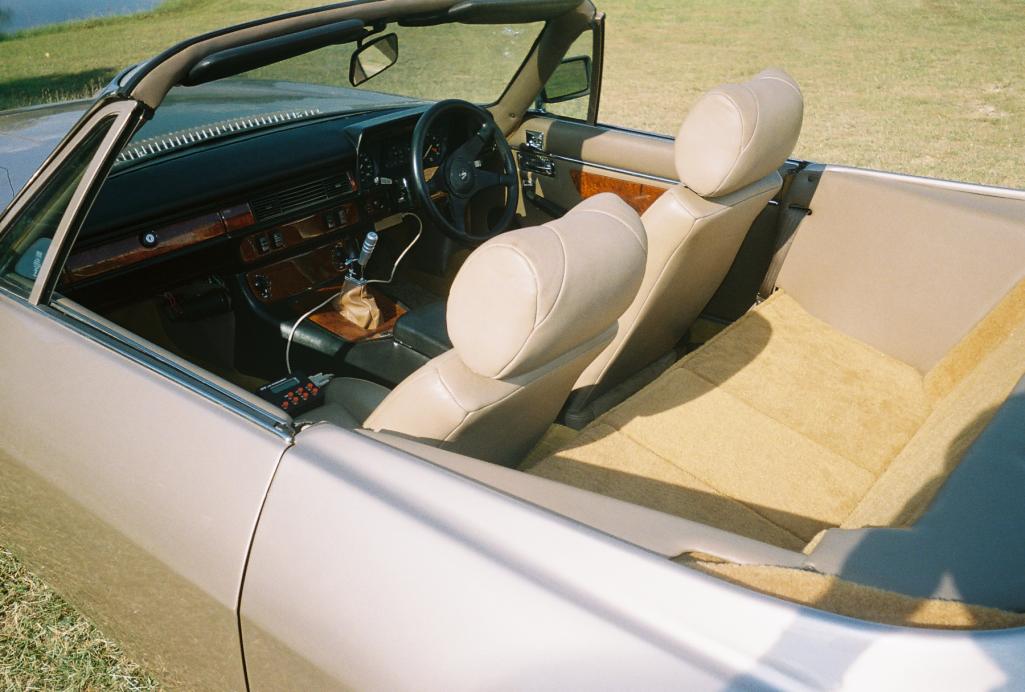

mine is a 1978 XJS roadster RHD,
i have a two hr. video of the complete restoration,all your pix brings back the two year build, back in 1994-1996.
all panels below mid doors were replaced , both side rocker panels,, both rears below bumpers, rear back panel, front panel, left -right below headlights, both side suspension arm mounting areas,
then i flared the rear wheel wells, added stiffining tubing.
custom plastic fuel cell(no more rusted tanks) , complete rebild engine V12(professional work), 4spd auto overdrive, rebild rear drive powerlock, gears 3.73, single piece Aluminum driveshaft.
custom interior , RECARO leather seats, have document that car is a two seater ONLY, originally done in England, around 1979.
and a lot i have forgotten, like suspension mods ,brake upgrades, calipers, pads ,shocks, roll bars, ETC.
and ENKI 18" wheels.
and custom paint!
i try not to think ANYMORE about how much money i spent,funny when you got good cash flow, how easy things can happen.
