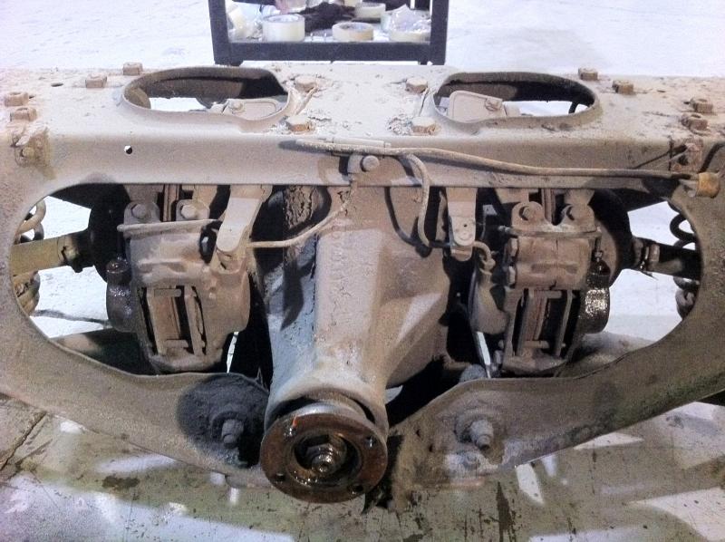

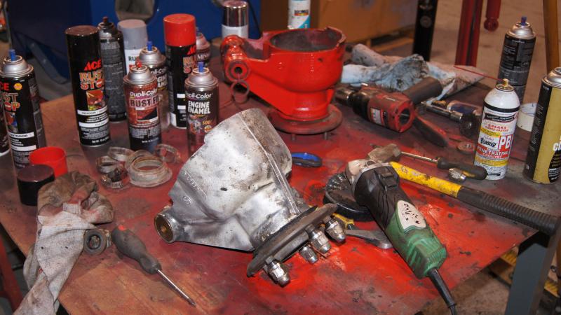

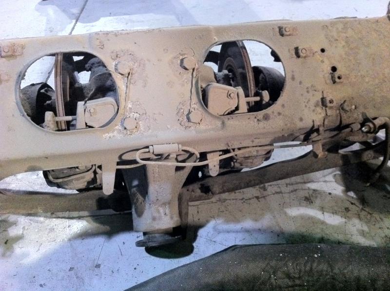

Now the rear axle...
Attached Thumbnails Is my XJS the oldest here?-dsc01227.jpg   Is my XJS the oldest here?-dsc01270.jpg   Is my XJS the oldest here?-dsc01271.jpg   Is my XJS the oldest here?-dsc01272.jpg   Is my XJS the oldest here?-dsc01273.jpg

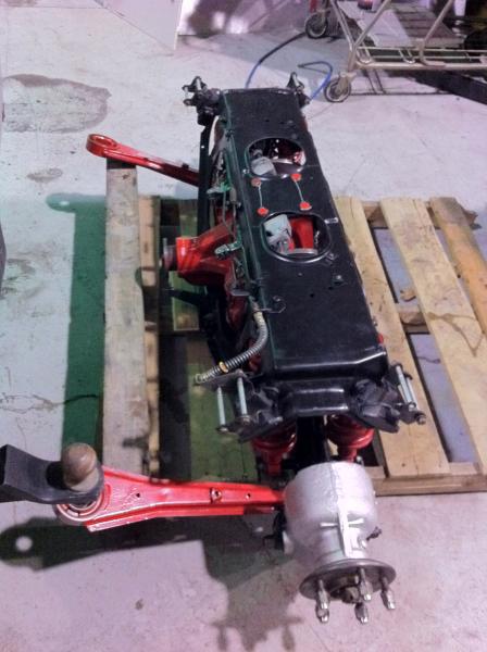

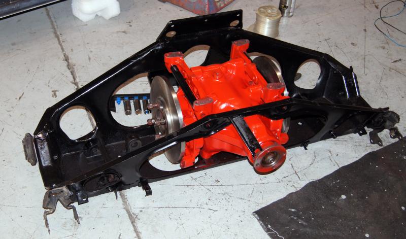

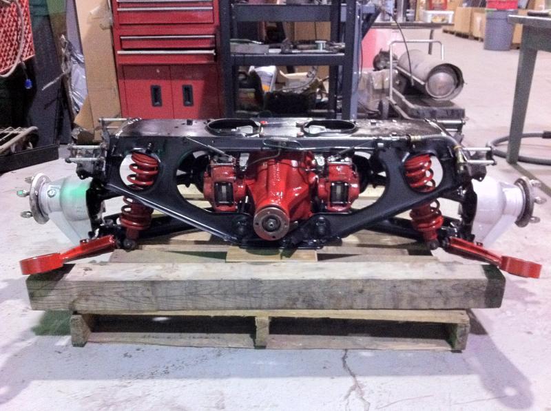

And the rear end is almost done!
Check out that beautiful undergarment, I am almost done building!

Nice work Mish. There is one job that will never need doing again. do you have the camber adjusting hook and tube for front and rear alignment?

I see no problem so long as they use the tools to set the ride height. Although $120 seems a bit cheap for an XJS if the alignment needs to be adjusted, remember you have had the thing apart and if every component is not in its original location (ie drive shafts matched with rotor and hub) the alignment might be out and is done with shims between the drive shafts and disk rotor. A painfully laborious job.

Know all about it, just did all kinds of measuring, when rear axle got assembled. I measured perfectly equal distance between tip of the hub and edge of the frame, it took factory 3 shims on one side and 3 and one slim one of the other.

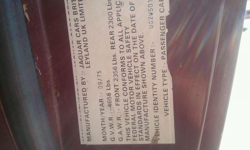

Finally got around to looking at the car.
behold
9/75 Oldest on the forum?

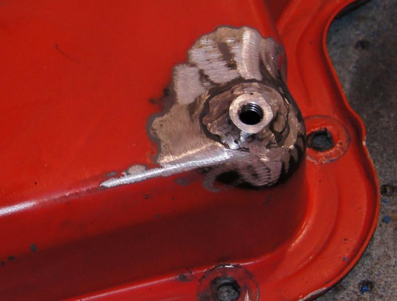

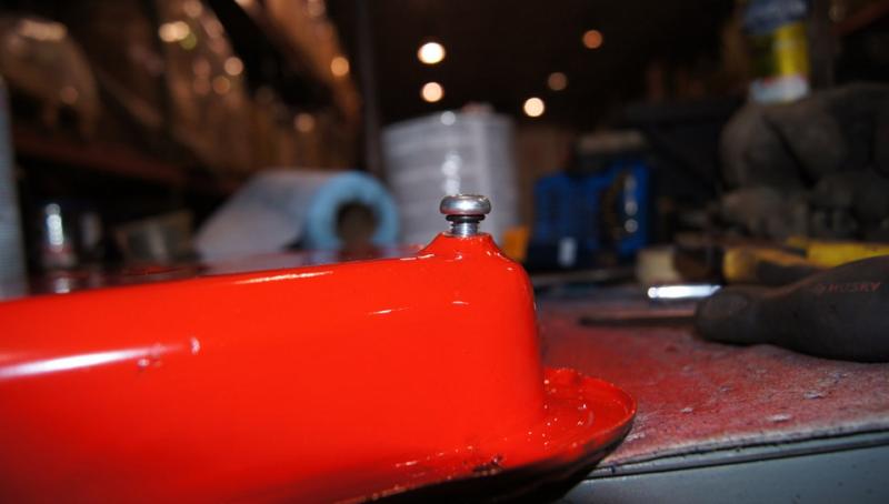

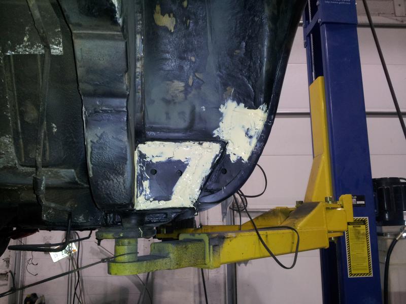

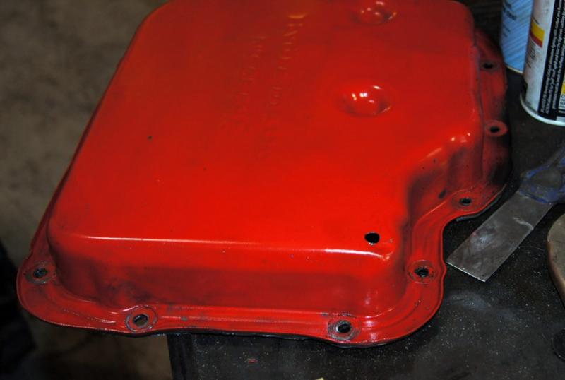

Some more pics of my old champ's resurrection.
Attached Thumbnails Is my XJS the oldest here?-88ce9ca312ad203c-large.jpg   Is my XJS the oldest here?-88ce9ca32449e544-large.jpg   Is my XJS the oldest here?-88ce9ca2ec72aae8-large.jpg   Is my XJS the oldest here?-88ce9ca3010212ac-large.jpg   Is my XJS the oldest here?-88ce9ca2a9cd3c54-large.jpg

Can't see the whole VIN. Can you post it?
Thanks.

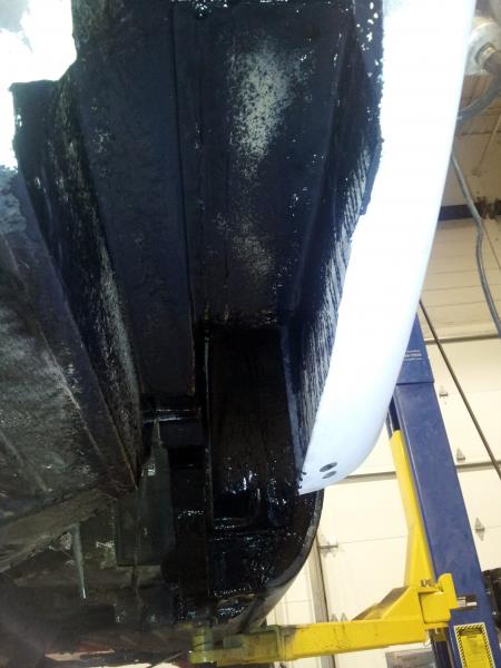

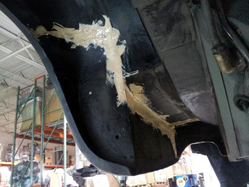

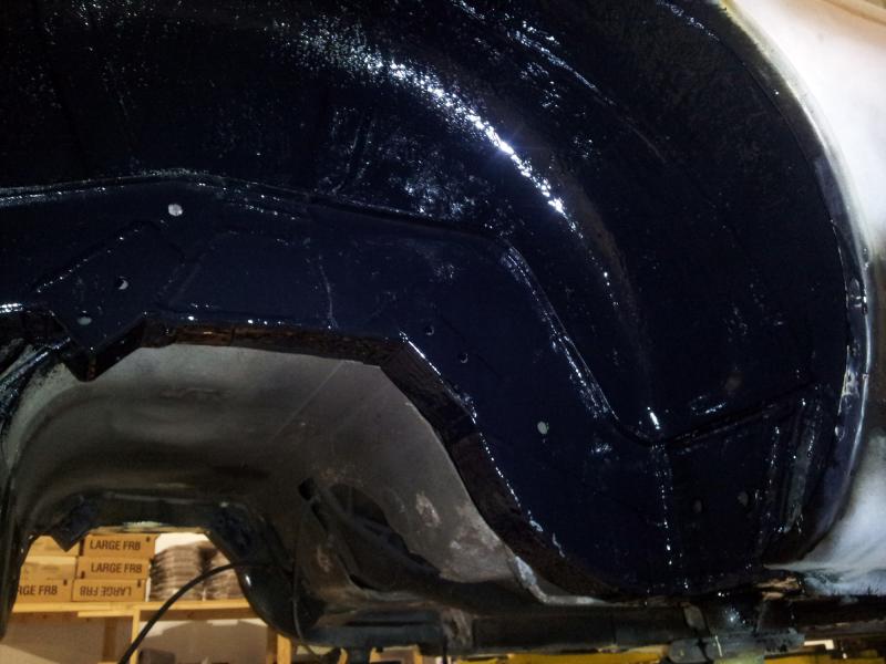

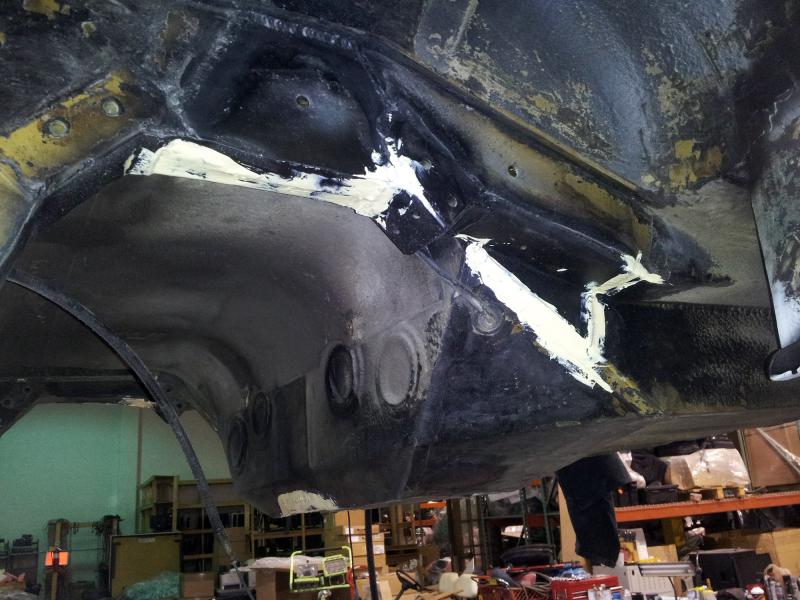

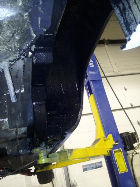

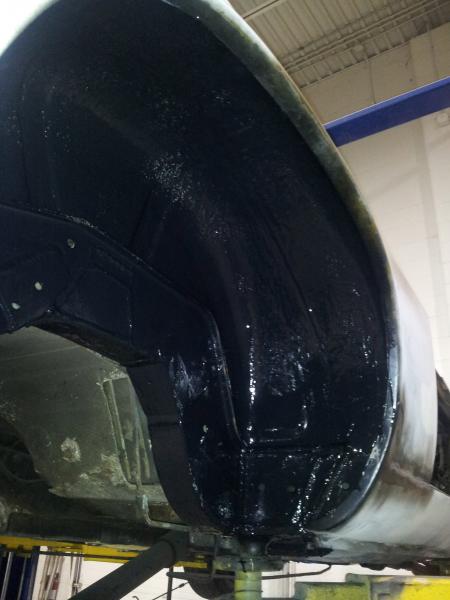

Starting to rust proof, using spray on truck bed liner, nice stuff...
Attached Thumbnails Is my XJS the oldest here?-20120109_121909.jpg   Is my XJS the oldest here?-20120109_121930.jpg   Is my XJS the oldest here?-20120109_121938.jpg   Is my XJS the oldest here?-20120109_121952.jpg   Is my XJS the oldest here?-20120109_122015.jpg
