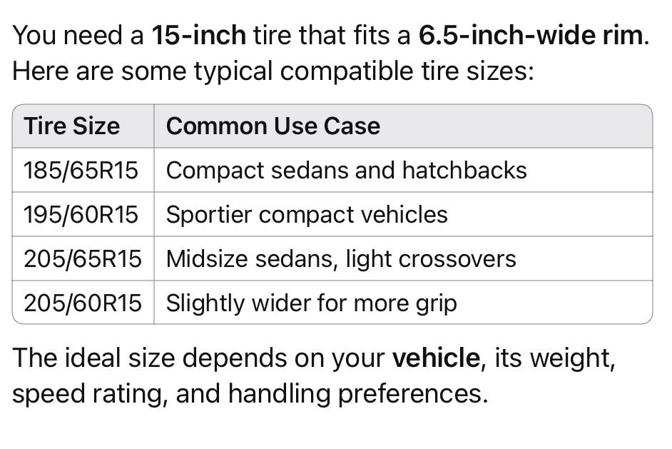

Maybe obvious, but here are the tire sizes ChatGpt says fit that wheel size:

And proof of why ChatGPT is not a tool that you can or should rely on ... none of those are suitable for an XJS even if they do fit - and size is not the only consideration.
AI should be redefined as 'almost' intelligent ....
