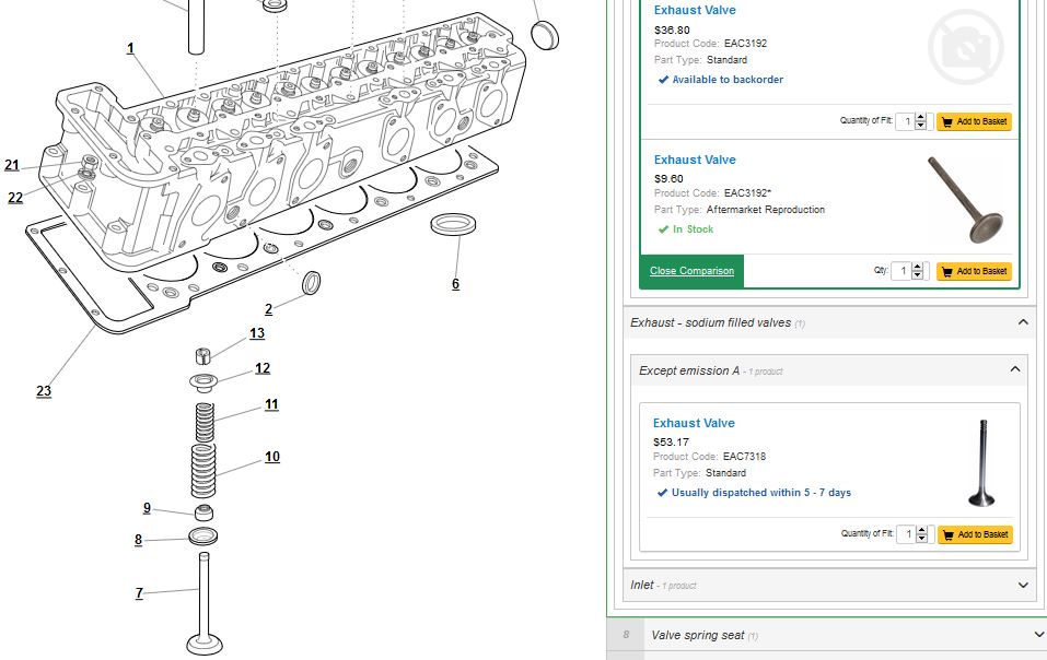

SNG BARRATT has exhaust valves listed as in stock. Not much luck on the inlet valve. You might try Terry's Jaguar they might be able to help out.

Be careful buying 6.0L valves they are shorter than both 5.3 pre-HE and HE also check the retainer groove is in the correct place, I had to shorten all my inlet valves 0.020" and exhaust valves did not have radiused margin.
Part numbers do not necessarily correlate with correct part.
