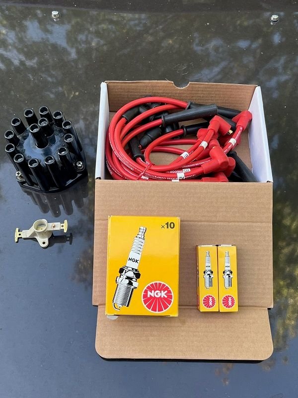

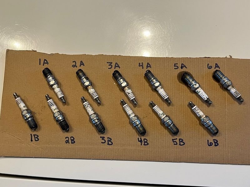

New NGK plugs, cap, cap gasket, rotor, Magnecore wires and two new NGK coils. I went with NGK BR6EF plugs per Jag's service bulletin gapped to .025. Contemplating doing the distributor shaft and silicone in the rotor mod.
The plugs looked a little darker than I would like, but maybe the hotter ones will do better.

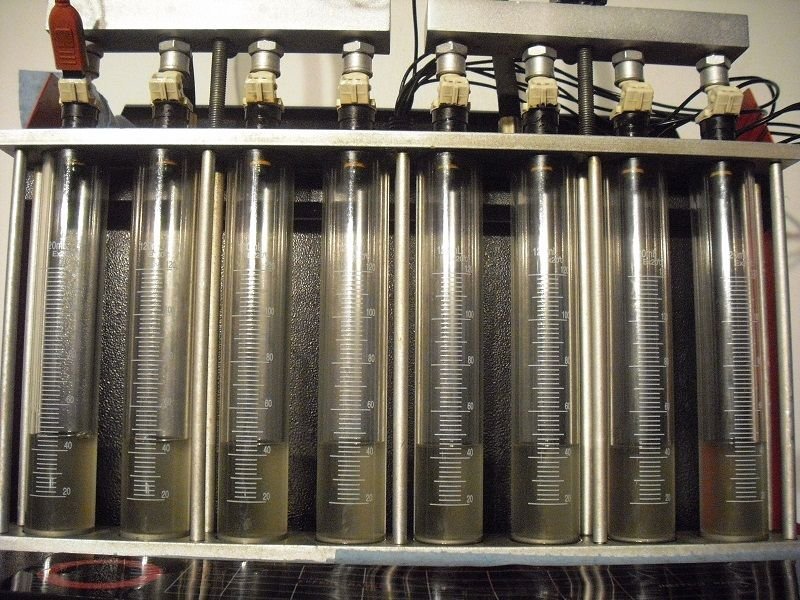

Injectors are on their way back from Injector Repair LLC after being cleaned and tested. This is the write up from Jim.

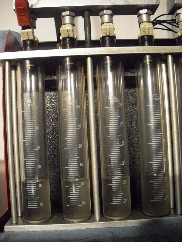

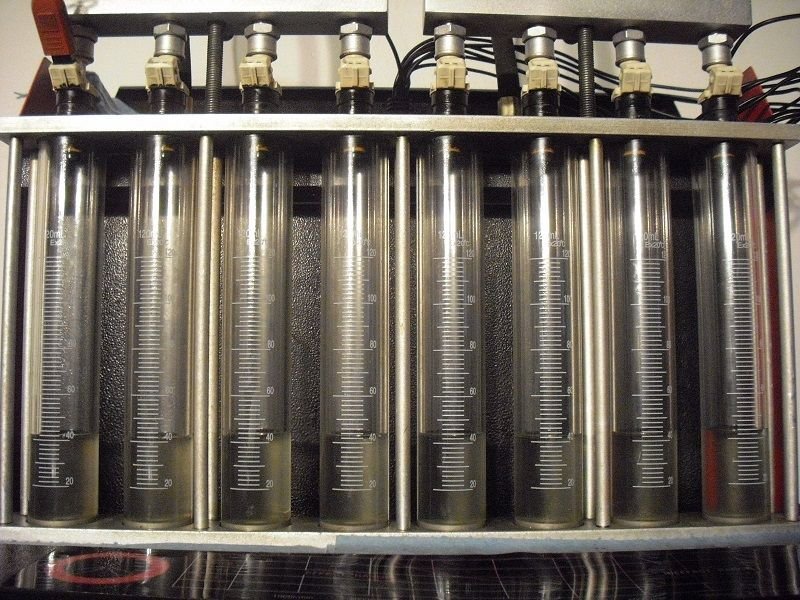

Your set of twelve Bosch injectors flow tested good right out of the box (after an initial exterior cleaning / de-greasing), and flow tested at close to a 6.7 % flow balance (42 to 45 cc). A 6.7 % flow balance is 'okay' for a used set of injectors but should be a little better. The spray patterns were all good. All of the injectors held pressure (no leaks).
The engine should have run okay with these injectors, maybe a tiny bit rough. They were perfect thru all the different flow tests performed. An Injector Flow Balance of under 5% is considered necessary for proper engine performance. When I sell refurbished sets, I try to get them flow matched at one to three percent flow balance. The closer the flow rates of the injectors are to each other, the better the engine will run, the engine will run smoother, and get better
miles per gallon.
This microfilters were in good shape. When I backflushed the injectors, no visible debris came out of the injectors. Inside the injectors was clean (nice). The discharge tips were mostly clean.
Attached are pictures of some of the multiple flow tests I ran on your set of injectors.
Pictures # 2783, 84 are of the initial dynamic flow test (before cleaning).

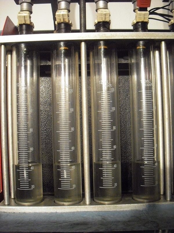

Pictures # 2785, 86 are of one of the final dynamic flow tests. I ran all tests multiple times.
Your injectors final flow tests were much better. The final dynamic flow test (12 ms pulse width / 2400 rpm / 25 seconds) had flow rates of 45 to 46 cc.s across the board. The Final injector flow balance improved to close to 2.2 %. Good to go.
They all performed flawless in all the tests.
The injectors held pressures over 80 psi without leaking a drop, and their spray patterns were perfect.
Jim
Injector Repair LLC
518-956-0014

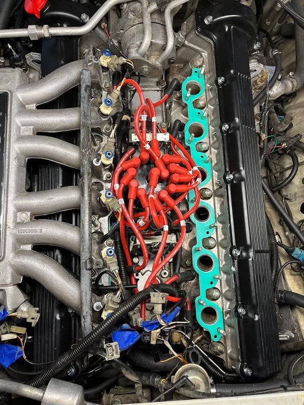

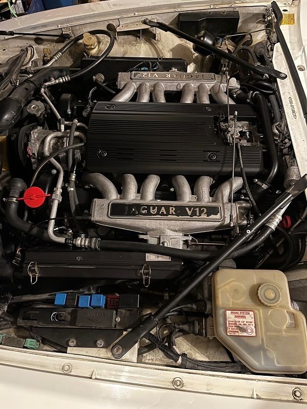

Just finished replacing the cam covers and by default the intake manifold gaskets. After the computer relearned everything, the car seems to like the new NGK plugs, Magnecore wires and Marelli cap and rotor. I replaced the rubber hoses that were cracked and or dried out.
All back together, but still may need some final tuning by someone who knows these V12 engine better than me. It is my first and only about 100 miles into ownership.

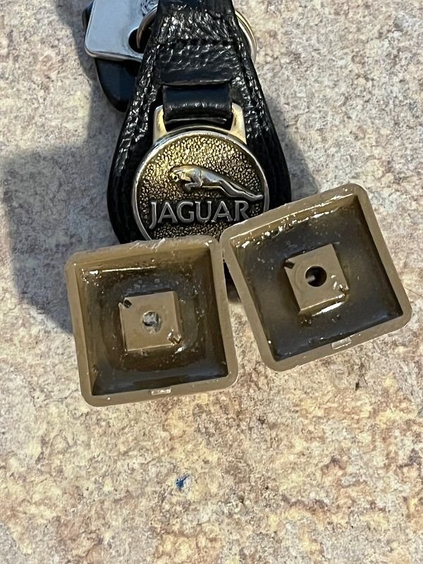

I picked up two new sun visor clips from SNG Barrat and "potted" them in hopes that they will be a little more durable.

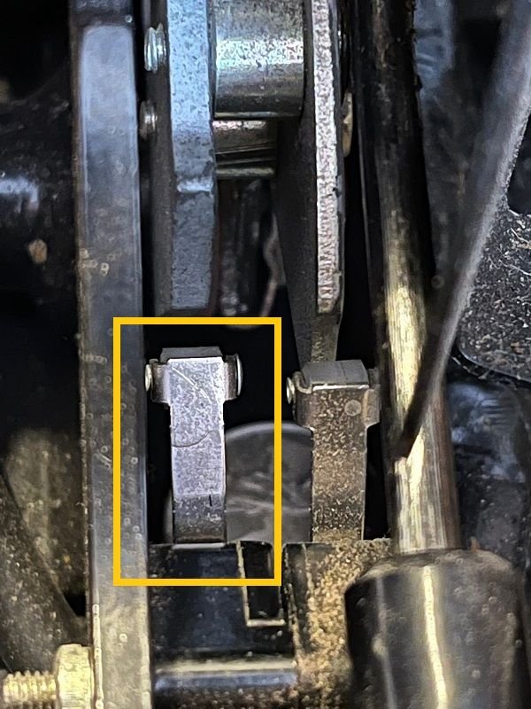

When I got the car, I quickly discovered that the backup lights were not working. I ordered a new back up switch, which turned out to be the wrong one, but ended up not needing a new switch after all. The switch "cam" would turn on the lights if I pushed back on it by hand, but it must have gotten lazy over the years and the shifter lever didn't push it back far enough to illuminate the lights. A little tweaking (bending) of this arm has the lights working one again.
I love fixes that end up being free.

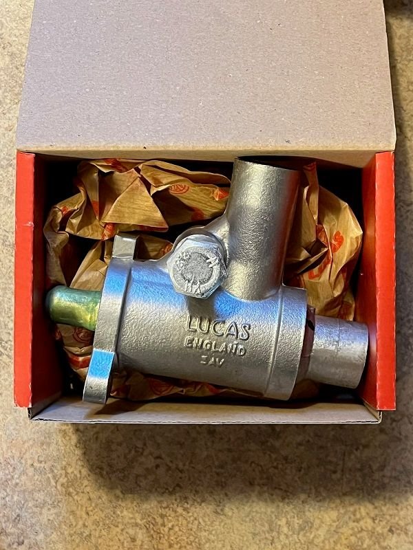

The car, being new to me, is still being sorted out a bit. I have had a "hunting/surging" idle issue and recently replaced the auxiliary air valve and now all is well.
The warm RPM in park is still a bit high at 1000 rpm, but I am hoping this will be resolved by having the motor tuned by someone who know these V12s intimately. Donovan Motor Car Service is pretty close to me and I have heard great things about them.

If the tickover is too high screw in that huge bolt on the AAV to bring it down. If that bolt is all the way in, then you have q small air leak. In which case the first thing to do is to set then butterfliees to a 2 thou gap and then adjust the AAV bolt out or in as required.

The bolt is screwed in, I believe, about as far as I can screw it in, the throttle plates have been set and the engine smoke tested. No leaks other than out through the throttle plates.
