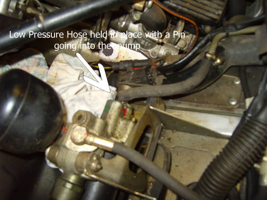

In order to Bleed the Low Pressure Side, by the Black Accumulator Ball, you will see a Pipe going into the Pump, that is held in place by a little spring pin.
You have to Pull this Spring Clip out (Don't Loose it!!!!!) then pull the pipe out from the Accumulator Motor.
The Pipe has an 'O' ring on it and it can be a PIA to pull out (WD and lots of Jiggling helps)
But before you do any of that, give the Pedal about 20 pumps to de pressurize the Ball and then get some Tin foil and construct a sort of channel underneath the pump,
a little bit like a water slide you might see in a theme park, only smaller lol.
To divert any Brake Fluid into the Bowl underneath as it runs out, or it will ruin the paint work in the Engine Bay.
And have a tray ready underneath the Car (old washing up bowl) and more rag than you think you'll ever need because when you pull that Pipe out, Brake Fluid will come pouring out all over the place.
So not only pack rags everywhere but also Cover the ball with a Towel before you pull the Pipe out, just in case the fluid, is still under pressure.

You won't need to use the vacuum pump or any bleeding device on the low pressure side, as when you pull that Pipe out, after removing the pin, Brake fluid should come flooding out by gravity.
In the very unlikely event, that it doesn't happen (maybe an Airlock) there is a joiner by the Reservoir that you can 'Crack' again you need to be prepared for Brake Fluid to come out, so have lots of rag handy.
So its handy to have a mate handy to Top The Reservoir up as it flows out, although I managed to do it by myself.
Since the Brake Fluid only has a very Short distance to travel, from the Reservoir to the Pump (from one side of the car to the other) You shouldn't need to let that much Fluid pass through, before you see clean Fluid with No Bubbles.
Although you need to put the Pipe back while the Fluid is still Flowing, to prevent any Air from getting back in.
So what you are actually doing, is Bleeding out the Air from the Pipe that connects the Reservoir to the Pump.
Be Warned it will make one hell of a mess, with Brake Fluid flowing all over the place, which will attack any Paintwork that it comes into contact with, and also don't pull that Pipe out, without a Towel draped over the Pump, just in case it is still under pressure.
Also the pipe that you pull out, has a plastic connector on the end, so when you are trying to pull it out, be careful you don't break it as it is very unlikely to come out without a bit of a struggle.
