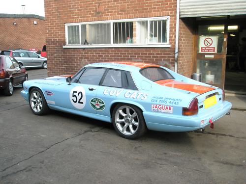

Attached, please find some of UK racing XJS' with XK8 wheels. Car 99 is Gail Hill's "Gulf" racing XJS. The "Gulf" XJS that Gail was selling was actually a second car, obviously, since it is car #52 instead of car #99 and it has 2002 XJR wheels, instead. I mention this only because the same wheels on my own 2002 XJR look heavenly on it, yet, to me, they do not look quite as attractive on Gail's XJS as the XK8 wheels do on car #99. Just my personal taste and perspective.
If you haven't yet, my own gallery here at this Website features several pics of my own BRG XJS, some showing the subject wheels.
which do look heavenly on my own 2002 XJR, yet, on Gail's for-sale XJS Cheers, and good luck on your wheels search!
