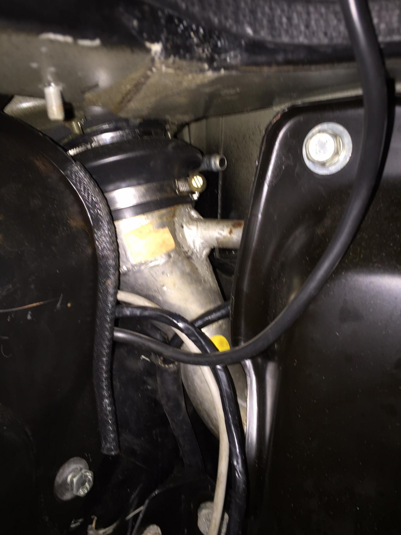

I found the overflow or vent Hose wasn't connected. The problem is that I don't see the hose to re attach it. How do I fix it?
Old Dec 16, 2014 | 11:53 PM
Japthug's Avatar
Joined: Jan 2011
Posts: 424
Likes: 212
From: Japan
Which hose do you mention?
Could you upload a picture?

It located just at the seal on the filler neck where it connects to the tank.
Old Dec 19, 2014 | 06:07 PM
chiro05's Avatar
Joined: Dec 2014
Posts: 34
From: Kentucky
Here is a picture. You can see the open nipple connection.
