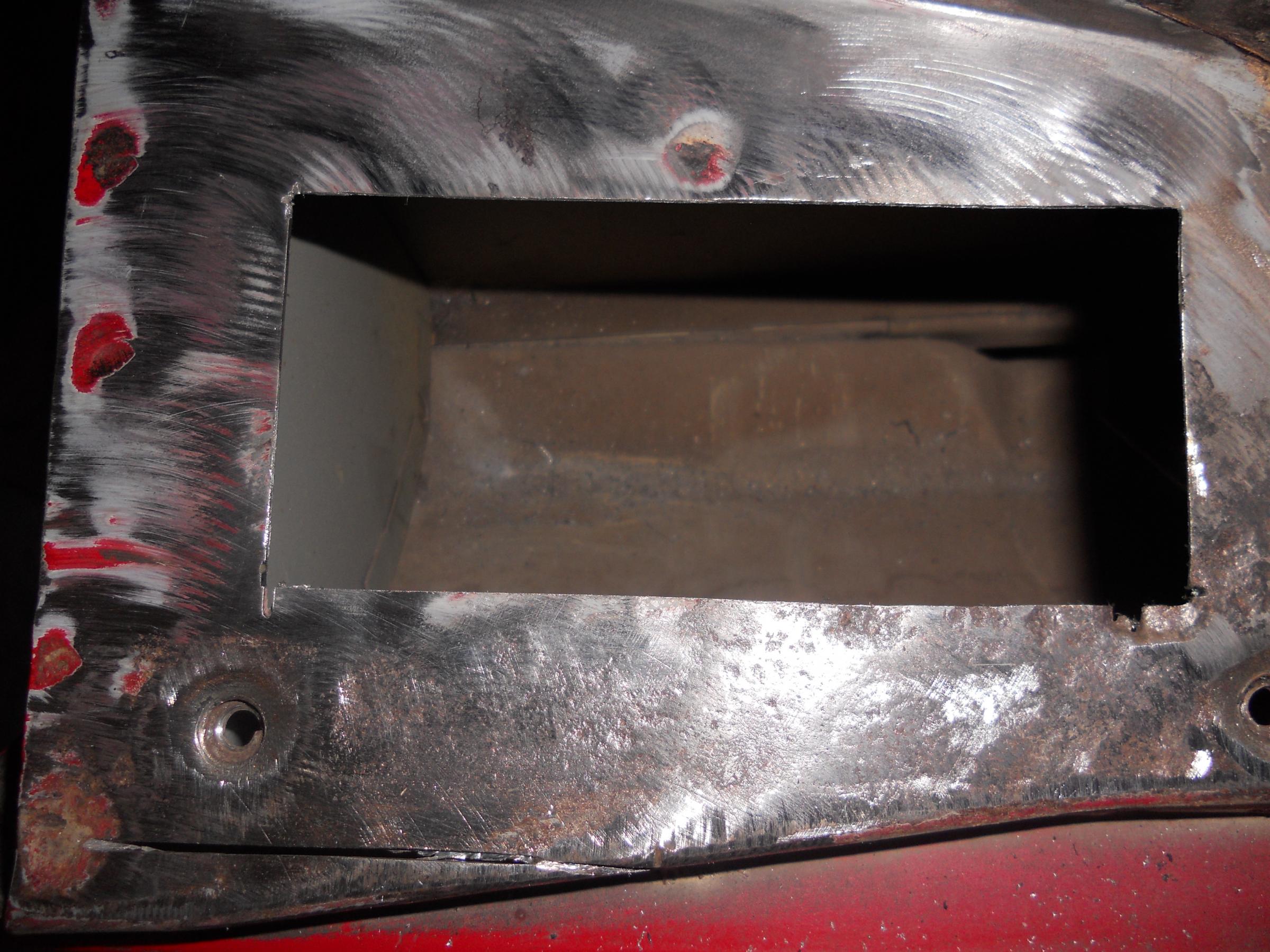

Here is a picture of my RH shelf, where the atmospheric tank sits. You can see where I inadvertently cut when I cut the guard off. I didn't take pics as I went, but to fix this I welded 2 strips of metal under the shelf so the patch would sit there and not fall through. Then I spot welded in the new bit.
Before welding I sprayed everything with weld through primer including the small strips I welded underneath.
