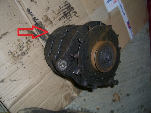

hi Gregg. can you do me a favour, they want pics and the readings of the plate?
this is the mail I got, but I don't want to disable my car to fid the info
"However, if you look at the red arrow on the pic attached, there should be a
small plate somewhere near it, could you tell me exactly what it says on
that plate? (part numbers and exact amperage) as we may have something
slightly more powerful than the existing one"
thanks if you can help
RGP
I am not sure what they want and what 'plate' means. Can you send me a copy of the pic? I found it better to call them, by the way. I just said "send me a 115 as used on the later 1990s jags" (with the clockface as required).
I have sent you a PM on the forum system with soem info that should allow the company to find what they supplied to me.
Greg

RGP
Greg
I have sent them the info you have kindly sent and I hope they help i.d. it
the label the are after is missing on mine unfortunately
