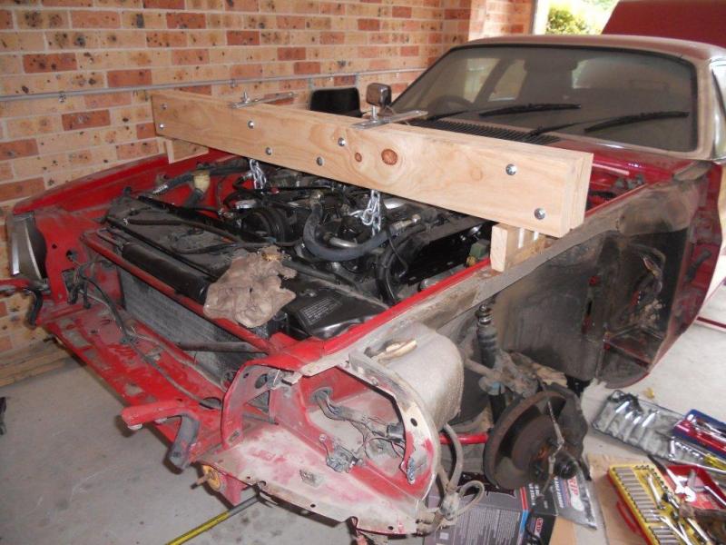

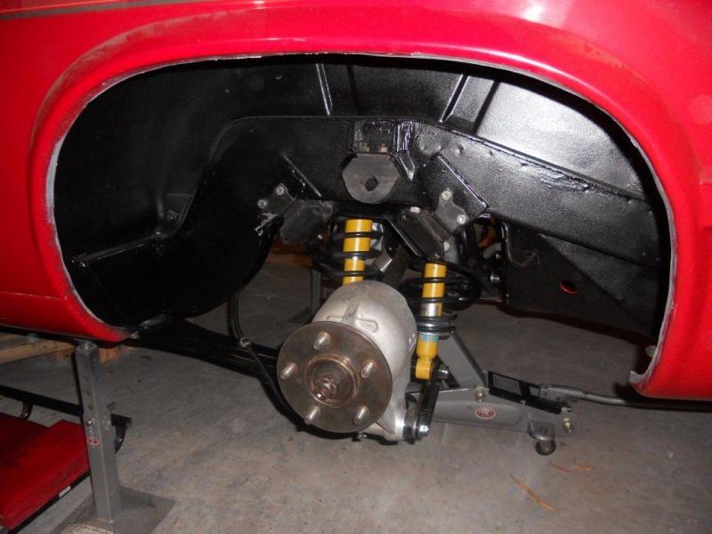

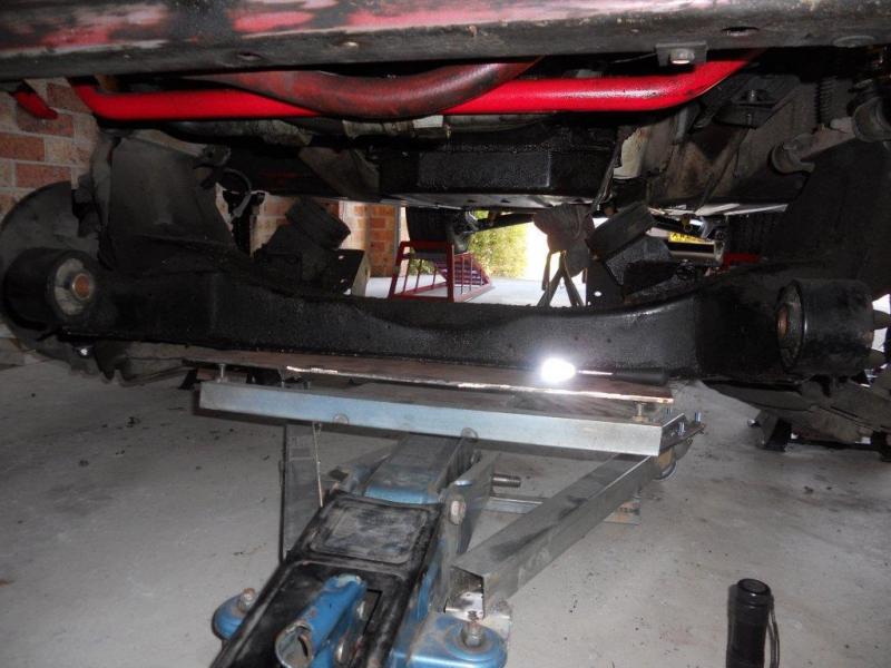

Finally got the rear end back in the car, and machined a spacer to go between the tailshaft and pinion flange.

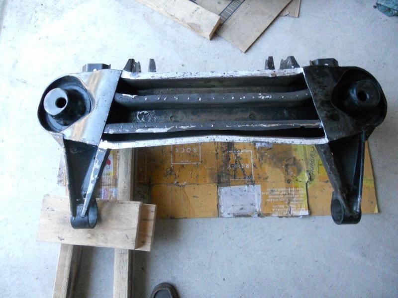

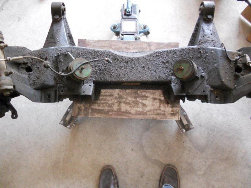

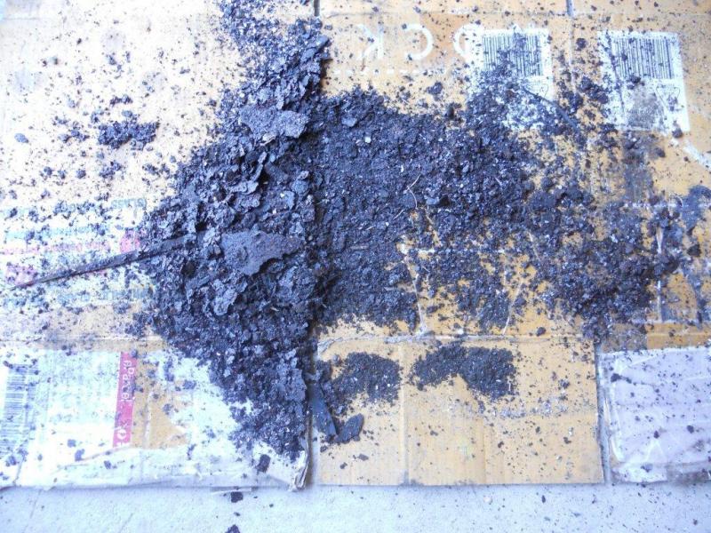

Thought I would start a new thread with the rest of the rebuild. Pulled the front end out and cut it open to see what was inside, god what a mess so cut the bottom off the subrfame - I'll send it for sandblasting then prime the inside and weld a new piece on the bottom with some modifications. There is no way for water to get out of the front and back sections so I will cut some channels to let the water out.
That gearbox jack was certainly worth the effort - it took me 15 minutes to install the rear end back in the car by myself.
Attached Thumbnails 89 XJS V12 rebuild-dscn0396.jpg   89 XJS V12 rebuild-dscn0404.jpg   89 XJS V12 rebuild-dscn0405.jpg   89 XJS V12 rebuild-dscn0408.jpg   89 XJS V12 rebuild-dscn0415.jpg
EDIT -THOUGHT THE BIGGER PICS WOULD DO THE POST MORE JUSTICE
Last edited by JimC64; Feb 5, 2012 at 07:36 PM. Reason: Insert pics in the body of the post

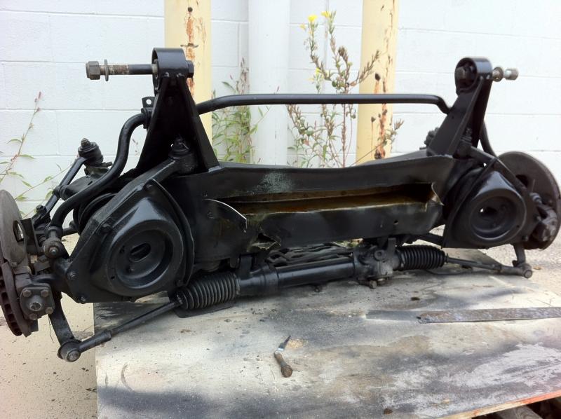

Somewhere I saw this before... I have to admit, your way of inspecting front end internals is a bit more sophisticated than mine, but at least I am done with it and you have all the fun ahead of you.

I did it for 2 reasons, I could hear the junk inside and the bottom had dents. When I cut it open the center support is bent and there is no way for the water to easily drain. It has to seep between the 2 bits of metal spot welded together. I will be cutting channels in the supports and rear to allow the water to drain.
It's then off for sandblasting and I will prime the inside before its powdercoated.

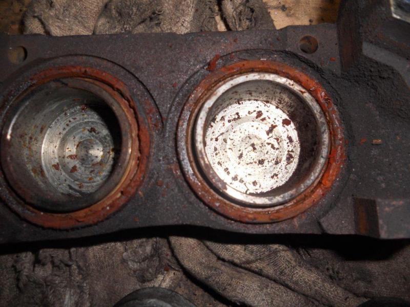

This is not what I hoping to see when I pulled the front calipers apart. I was hoping just to replace the seals clean them up paint and bolt them back together.
Considering that they are not that old I was surprised. Anyone had experience with Stainless pistons??

Check the specification for the caliper bolts, as you are not supposed to split the caliper in normal service. I suspect the old bolts are not reuseable because they are originally done up to, maybe beyond, the elastic limit.

Thanks, I'll. Check that out. The internal oil ways were totally blocked with gunk so dismantling was a good idea. Thinking about it I might just put new bolts in.
