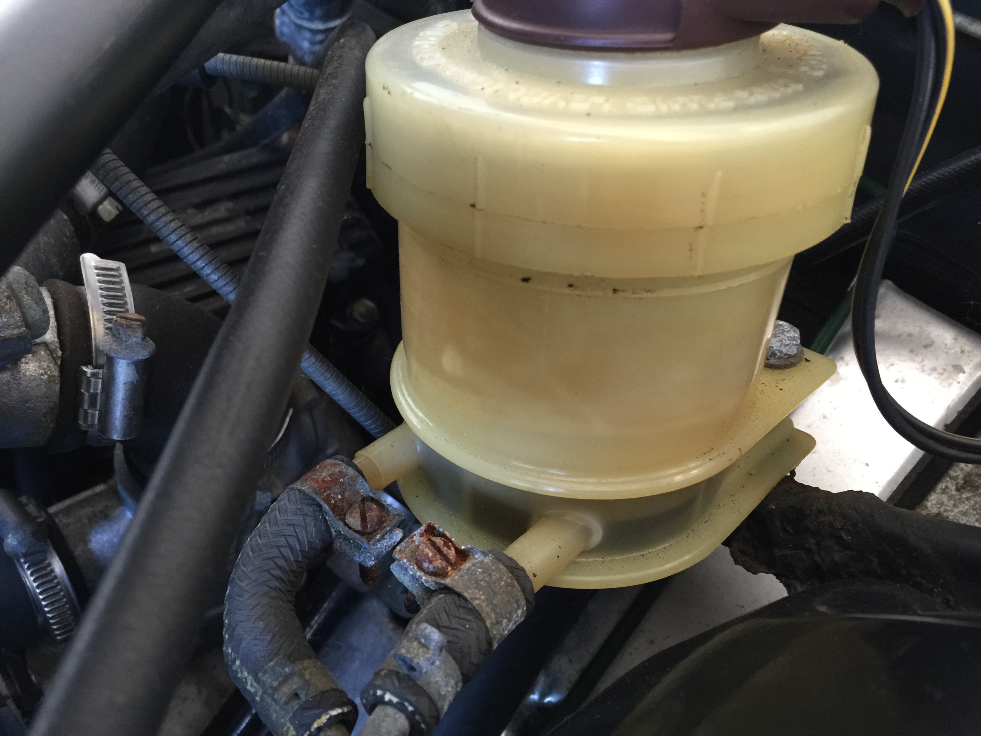

Old May 6, 2016 | 10:45 AM
01Silverstone's Avatar
Joined: Jun 2013
Posts: 1,162
Likes: 246
From: Chicago, IL
Originally Posted by BC XJS
Is there any fluid in the master cylinder? If so I agree with master cylinder failing. If it's empty it could leaking into the brake booster. If it was anything else there would be fluid on the ground.
It looks pretty empty to me, and since there's none on the ground, I'm thinking you're right about it leaking into the brake booster.

Old May 6, 2016 | 07:59 PM
Safari's Avatar
Posts: 757
Likes: 315
From: Denver, CO
What does that indicate about the M/C?
If fluid is leaking into the booster then the leak originates from a seal in the MC. You need to replace it.
