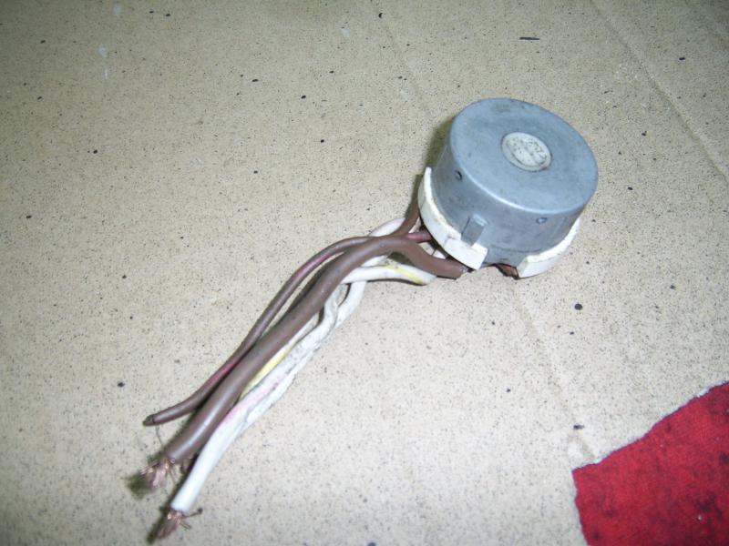

removing the electrical section is fun at best. With your head firmly planted on the brake pedal, looking at the rear of the assembly you will see a SMALL philips headed screw on the circumference of the mechanical section, at about the 4 o'clock position. That is the screw you need to remove to allow the electrical section to simply slide out of the mechanical section.
I have snapped my "spare" electrical section and if you look closely the TINY screw holes are plainly visible. Only ONE is used, so maybe the 2 are for when they moved that switch to the LH side, coz the RH sided screw would be a NO GO on the LH side of the column.
