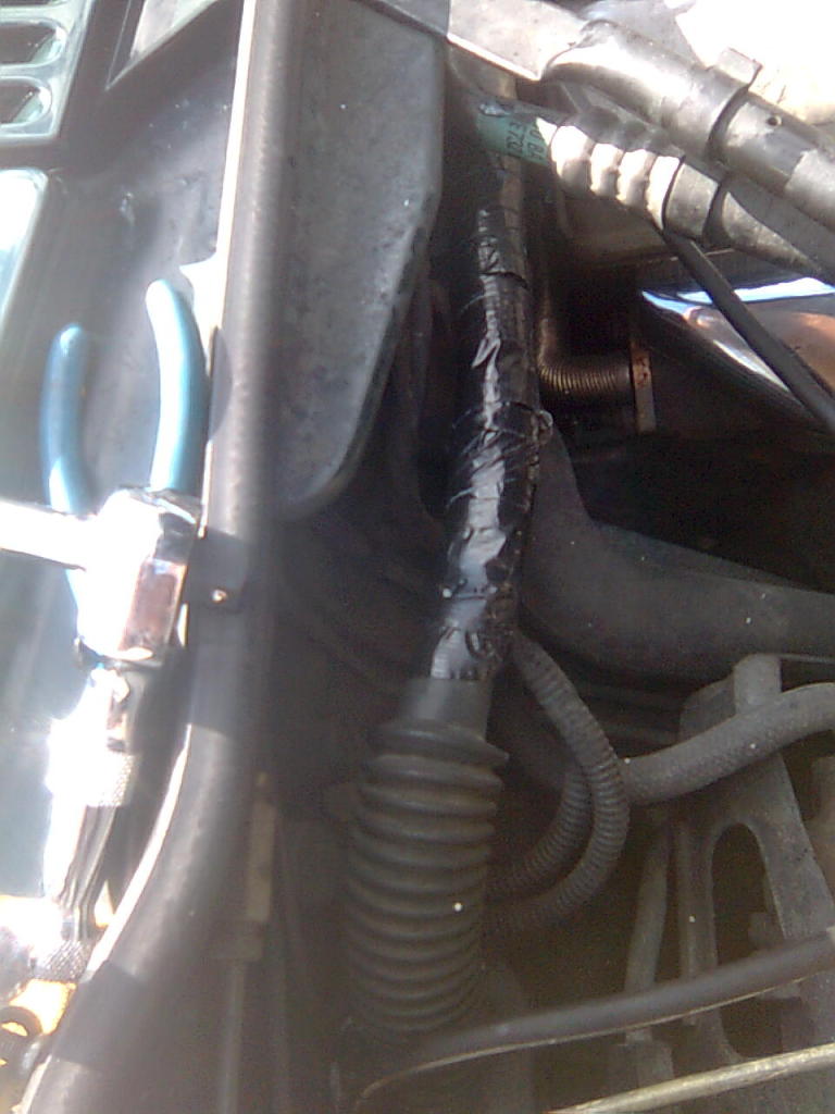

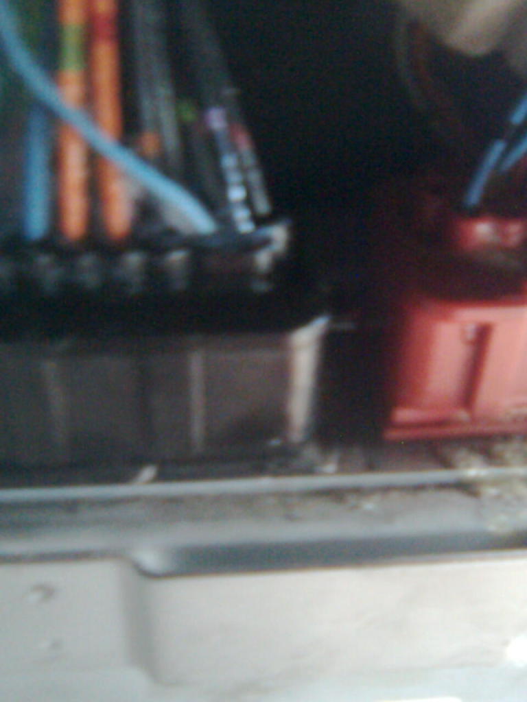

On my XJS I had the very same issue, my connector looked just like his. In order to avoid future failure my well versed AJ16 mechanic and I took the following steps on my car:
First we wrapped all the ECU wiring harness along the firewall, leading to the ECU with tape. Water drips into those cables and they go straight down to the pins;
We then sealed the rubber boot entrance with silicone:
Then the connectors on the new ECU recieved a healthy dose of dielectric grease inside and outside, specially on top of the female connector right by all the wires come into the connectors.:
