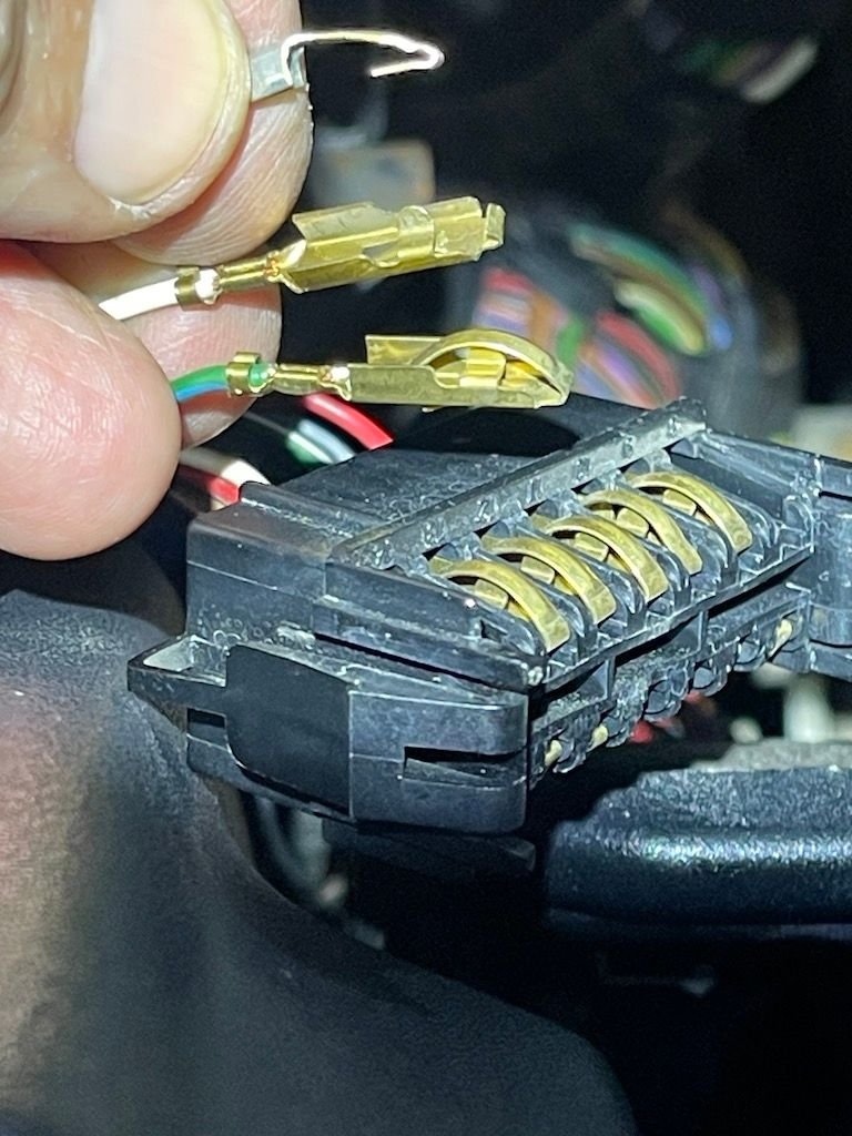

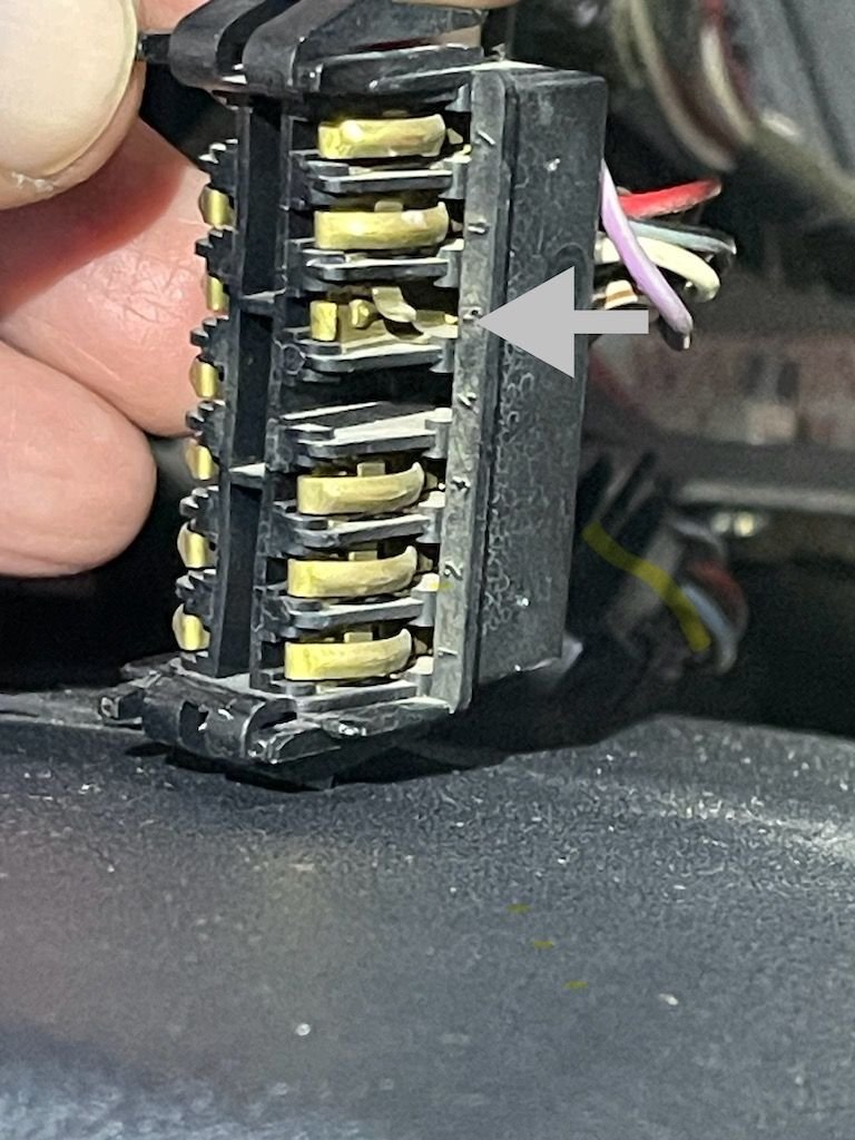

Few days later took off the cluster again for checking and noticed that one of the two wire plugs that connect to the back of the cluster, the one that fits behind the speedo had lost a piece of the curved brass bit which makes contact with the printed circuit, see first photo below.

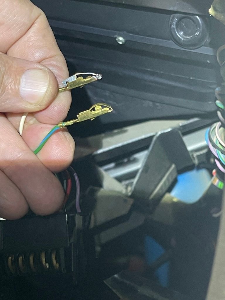

I brought a wire clip, cut it and sort of formed it to a similar shape as the broken piece and soldered it there and made sure it had enough curvature to make contact with the printed circuit, see photos 2 & 3.
Reassembled everything hoping that this is it, but after a test drive it was still the same, no odometer.

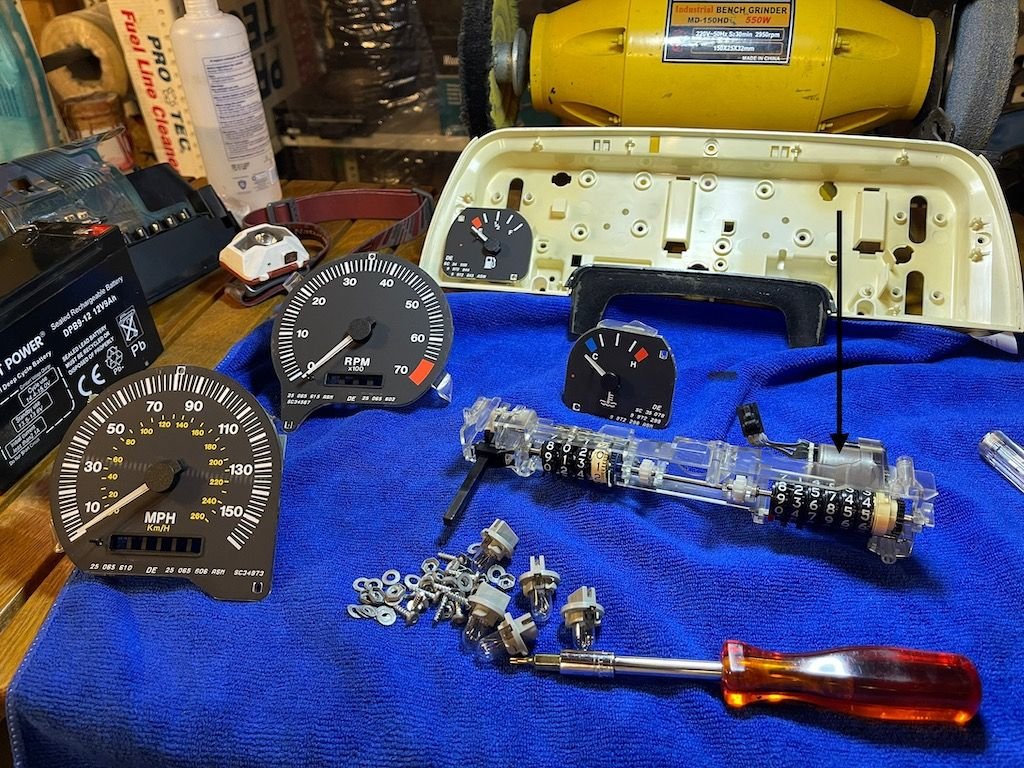

On a separate note, the little motor driving those numbers has 4 wires connected to it (last photo with arrow pointing at it). Has anyone tried powering it to check if it is working and if yes which wires? I did not attempt to power it lest I damage it.
