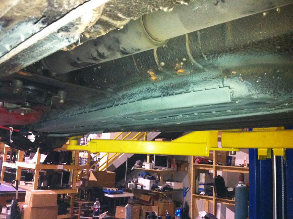

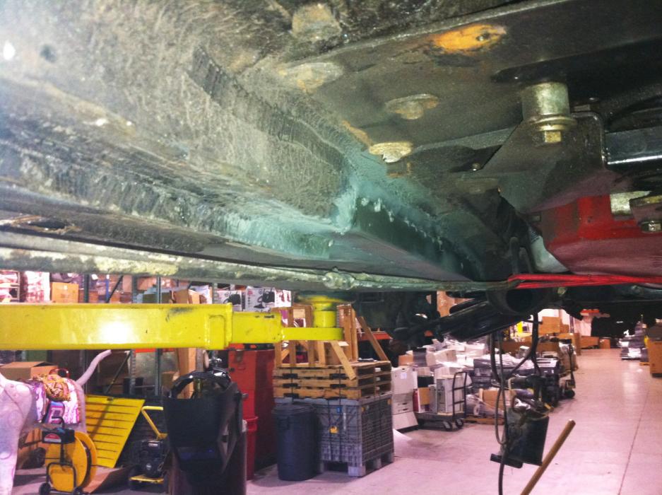

This is me replacing floor panels and then going all the way to restore original corner rigidity with steel angles.
I know that mine is 82, but these *******s are very rusty and the more you dig, the deeper it gets.
