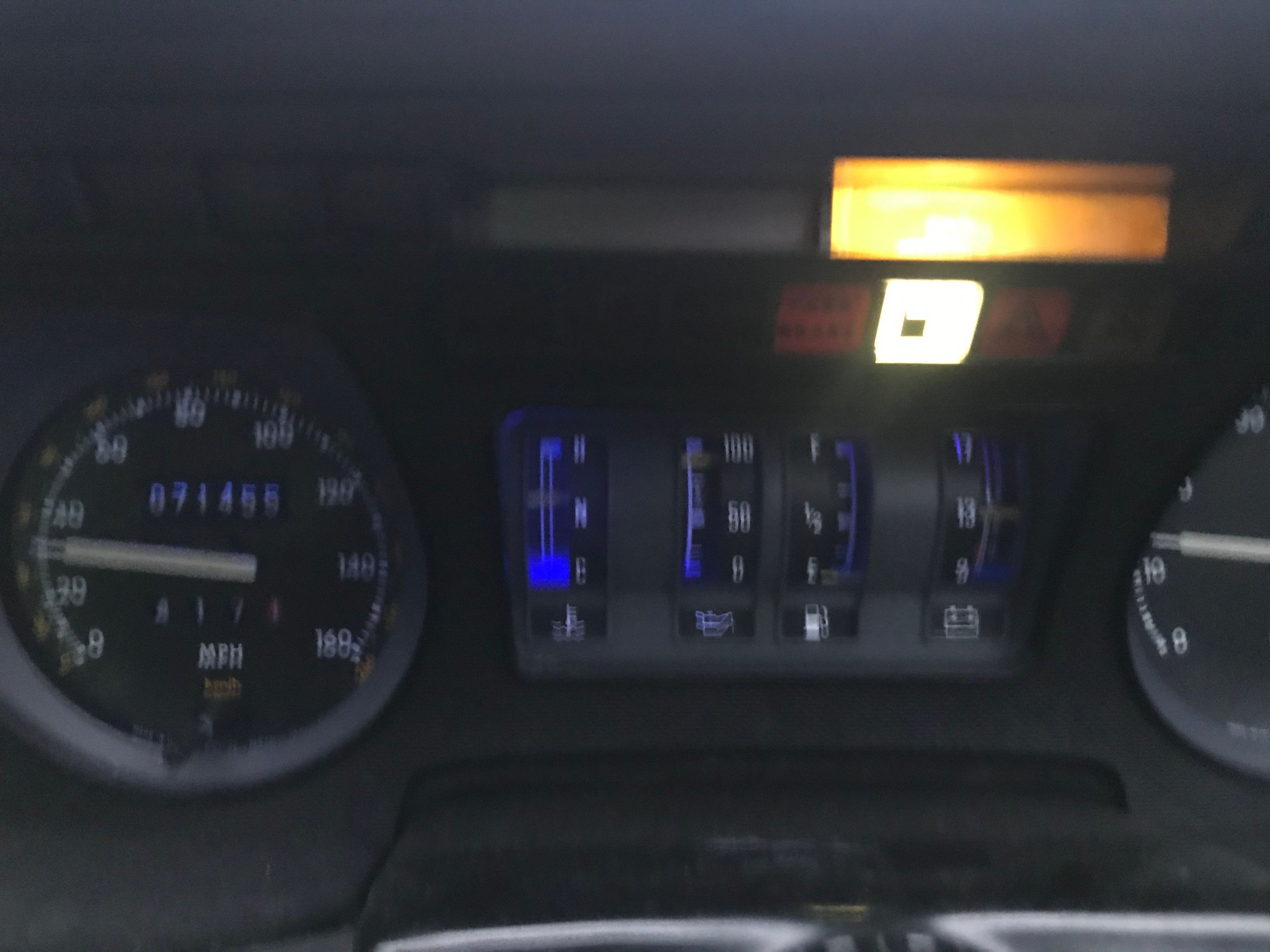

Old Nov 19, 2020 | 09:48 AM
Duke85's Avatar
Joined: Apr 2020
Posts: 141
Likes: 20
From: Derby
This is how it reads now. I know it's not right please can someone help me
Old Nov 19, 2020 | 09:50 AM
JayJagJay's Avatar
Joined: Sep 2016
Posts: 4,277
Likes: 1,314
From: New York New York
Hey Man... Naw, that dont sound right. Im trying to think of the possible connections between the oil pressure and the tempurature...
Whats the change in temperature...?
Anyways, have you replaced or inspected the 2 oil pressure sensors right behind the throttle stand? Im not sure what the internals are and how they are put together inside BUT maybe something failed internally which was producing the hiss and now, the obstructed flow and higher pressures - or maybe they (especially the pressure sensor) is/are just reading wrong altogether...? They are not expensive and I would just consider replacing them both... The larger I believe messages the actual pressure to the gauge and the smaller of the two triggers the light on the dash...
Considering how "interesting" these critters can be, is it possible that the stronger signal going to the oil pressure gauge is driving up the temp gauge somehow?
If you remove the cross pipe, throttle rods, and as much as you can back there - its not really too too difficult to get a wrench on them things. A crows foot wrench (cant even believe that is a set O words I use sometimes) helps with the pressure dummy light.

Since it is both oil pressure and temp, I'm thinking there is a grounding problem in the flexible circuit board. Try adding a ground.

Im so confused. Thank you for your suggestions. Could it be the cooling fan? That has stopped working? I don't want to do damage to the engine by just carrying on until it breaks down.
Just got home and I could hear that hissing very slight again. The mechanic inspected the pressure relief valve and said it was fine.
Its bugging me! I can usually figure this stuff out.
