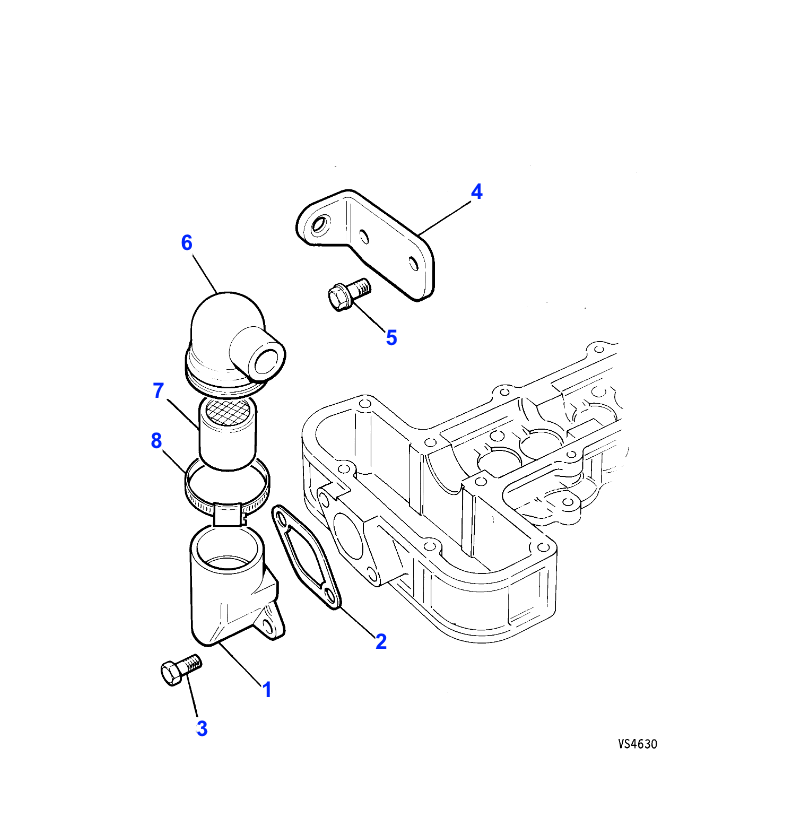

Originally Posted by Duke85
Hi, usually my garage floor is completely dry no oil nothing! But I have noticed 2 small spots of oil! Where do I find this crankcase to check it please?
On the front left hand side of the engine, see illustration below. The filter is item #7.
