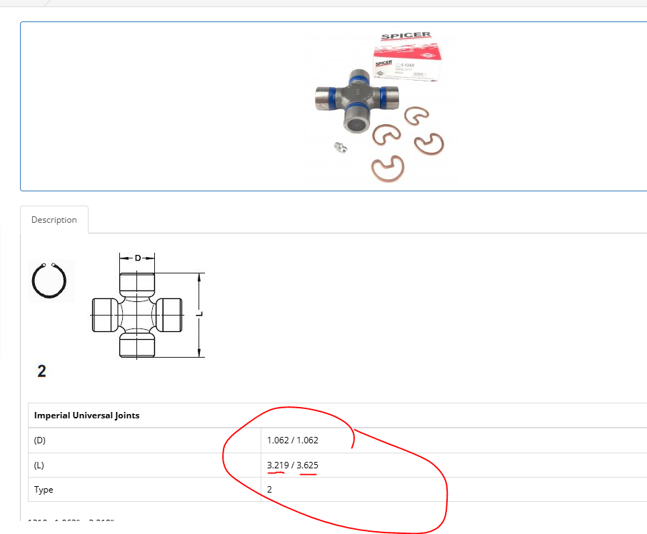

You "might" be able to use a conversion U-joint. I dont do it this way, I just use a complete axle BUT this may be something worth exploring. I think the later ujoint are 1330 and the early stuff is 1310 (not 100% sure, measure for yourself) That said there are all sorts of conversion u-joints to be had.
https://www.driveshaftparts.com/5-134XS
