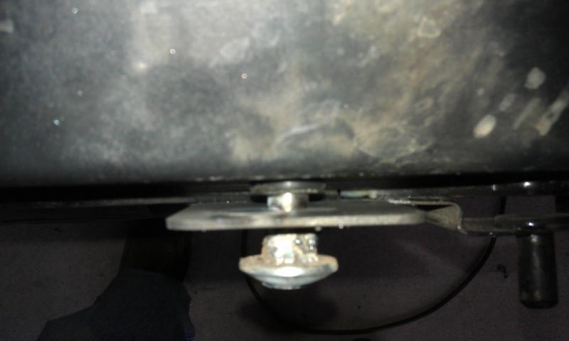

This is how I mounted the fans. I first cut off the OEM mounts drilled 2 holes in the bottom of the fan shroud to fit on the bolts I welded to the bottom of the radiator. You could bolt the bracket to the radiator bottom cross member instead.
If you are interested I can take a pic of the modified fans. The way they install I can remove them in a couple of minutes.
