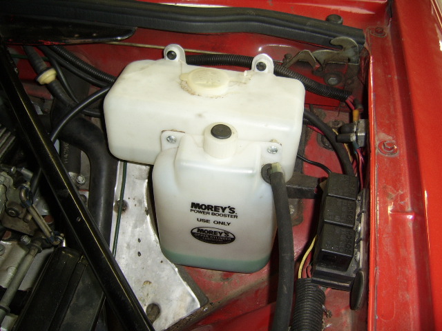

I agree, I do not run an atmospheric recovery tank either.
Greg
Old Apr 20, 2015 | 03:44 AM
  #58
Posts: 28,844
Likes: 11,293
This is my tank.
1ltr Moreys bottle (must scrape that off one day, maybe).
Beem that way for 10+ years.
