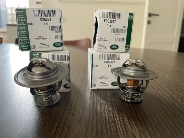

So, today i received couple options of Thermostats - as described for XJS V12;
Couple questions here:
- C28067 - thats 74 degrees Thermostat - clearly requires drilling a hole for air bleeding;
- EBC3577 - that's 88 degrees Thermostat - with a hole (And a ball inside that hole) - do i understand correctly that this is a bleeding hole and no additional drilling is required?

Correct about the 88 ones with th hole. 74 degrees is incorrect, not for the V12. But you MUST chceck that the length between the large rim and the bottom round part is at least the distance that Grant mentioned in his post.

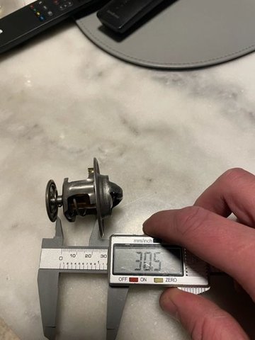

I'm sorry for home-kitchen style pictures (My wife was not happy at all as well about seeing Thermostats in her favourite stove.. . ), but:
- 88 Degrees Thermostat - Closed Thermostat length - ±30,5mm
- 88 Degrees Thermostat - Opened Thermostat length ±40,4-40,7 mm - is it OK?
- 77 Degrees thermostat open length - 45mm - is it too much?
Could you confirm it thats within spec?
Gracias
The 88 degree one is slightly too short. If you read Grant's thermostat writeup, on an earlier post, 41mm is the absolute minimum open length required, and 43mm is best.
The 77 degree one opens at too low at temperature, not correct for the HE V12.
From post 12 above: "Simple enough to heat them up and measure the open length, 43mm is the aim length, disc to disc."
The problem is that this thermostat is too short when fully open to 100% close off the recirculation ports, thus allowing the coolant to bypass the radiator when it should not be able to. I advise buying the Stant thermostats I recommended earlier.

This one with a longer closed length, and so longer open length, would be better, and it is in your part of the world!

Morning brings better ideas.
Measured once more - this time from Upper disk (Inside) to inner(expanding one) disk (Outside) - 42,5mm;
Previously i've measured from Upper disk (Inside) to inner (Expanding one) disk inside part (As seen in the picture) - i believe that's not correct way of measuring.
Good point. They should be OK.

The 74 stats are for teh Carby V12, and too cold for EFI engines.
That length as now measured is OK.

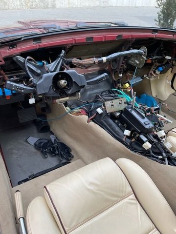

I've already replaced them today - see pictures, added two new caps (20PSI and 16PSI), unfortunately cannot test because Heater Box (With AC Evaporator and Heater matrix) is still missing. Matrix is coming, but AC Evaporator is a problem.. Mine is leaking and in a very unfortunate place - cannot just weld it. Tried looking for a new one - no luck
In the meantime i have fixed both Heater blowers - both vacuum solenoids where dead.. - should say expensive fix.

Thank you Greg for your swift response. I've already installed all related parts but currently got stuck with damn AC Evaporator. Mine is leaking and cannot find new part no where thus cannot move forwards assembly for Air Box (With Heater matrix and AC Evap);
For older Pre '93 Jags there are plenty of options but for later models with different Evap piping.. nothing.
