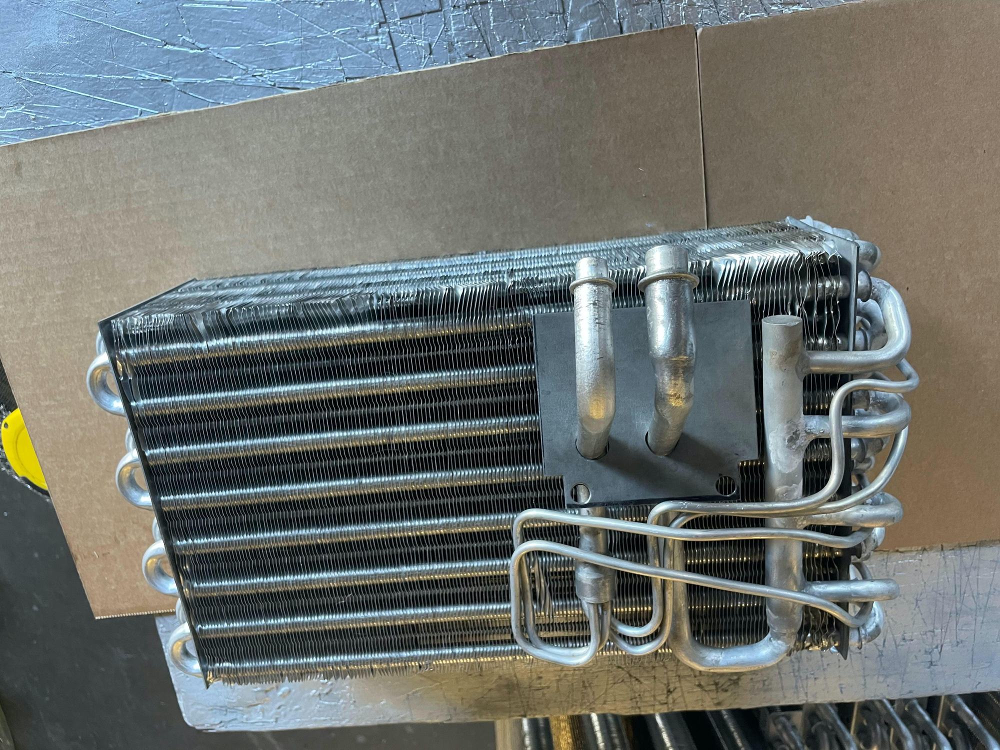

I will leave this information for the future (google find me) - i believe it really might be useful.
In case someone will be looking for an AC EVAPORATOR for Facelift models of XJS 1994 and +
  1. Code for it - JLM20609 - Good luck finding and NEVER EVER buy used one. It was created to be broken;
  2. Write an email to this company - sales@coolerclassics.com
  3. Ask for a EV8491 - model of evaporator;
  4. ±380 USD + Shipping fees;
And you will receive a shiny new one exactly as you need (The one in the picture is slightly used one - but you get the point).
#Evaporator #XJSevaporator #XJSACEVAPORATOR #JLM20609
It took me 2 months to find it.. hopefully will save some of all of yours time!

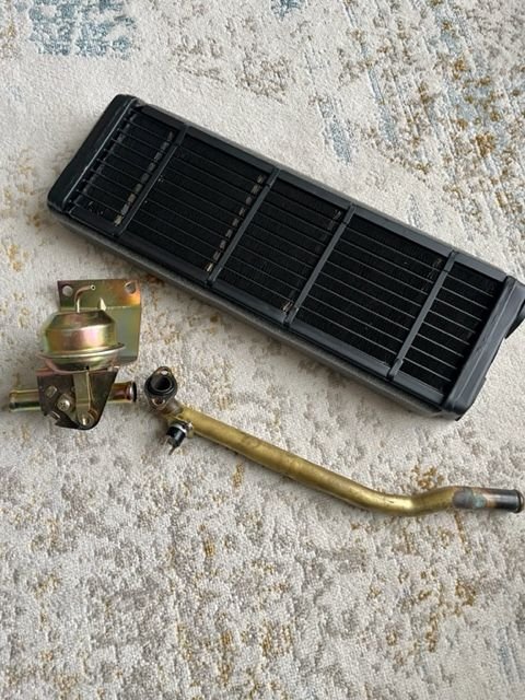

Last pieces arrived - new Heater Matrix, Heater control valve and pipe with working sensor;

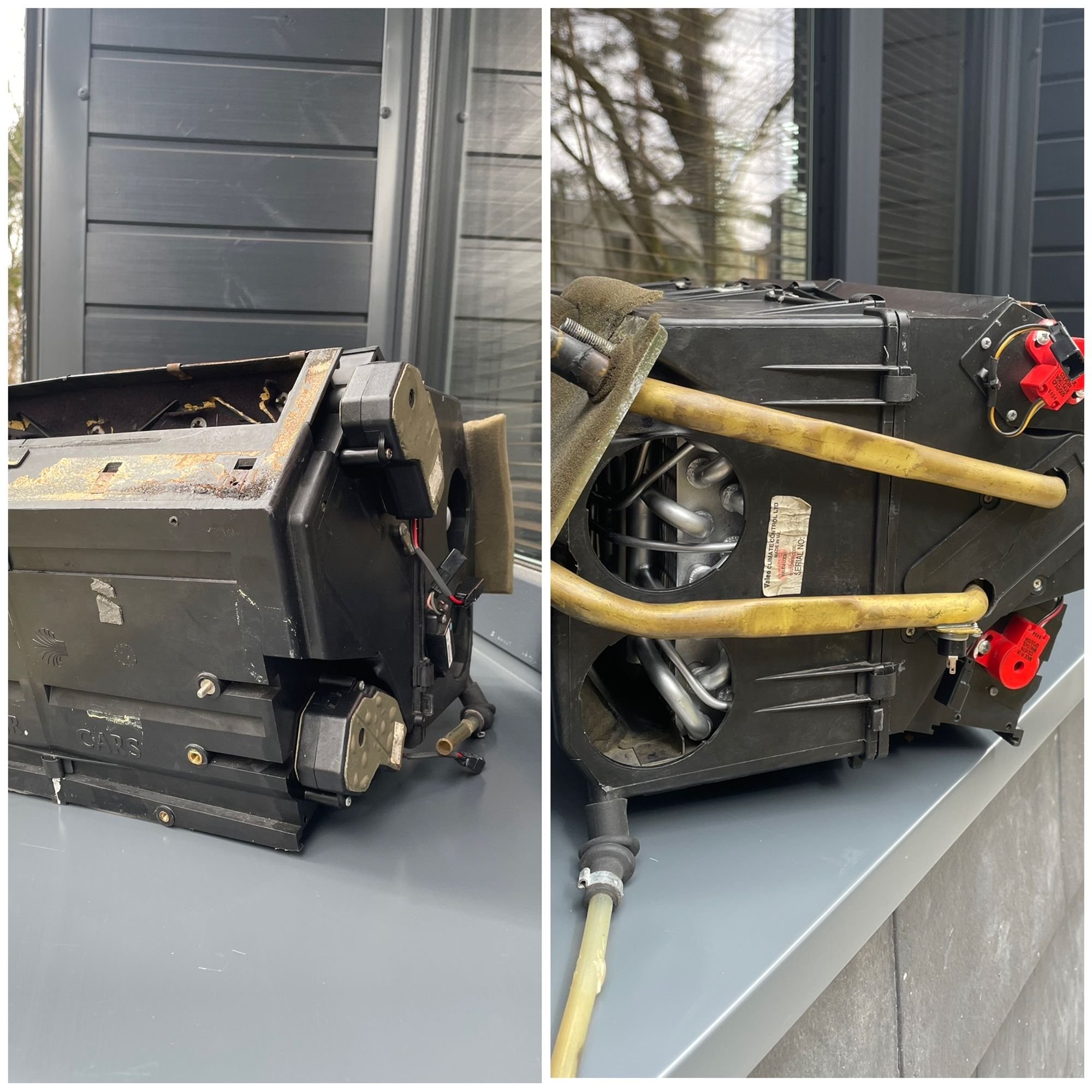

Ok, today finally installed - Refreshed Heater box (New AC Evap + New Heater matrix), new heater matrix hoses. Hopefully moving towards testing the running engine and it's temperatures really soon.
Refurbishment of Heater box was quite intense - checking if all sensors are working and trying to fit new AC Evap was a challenge; Cleaning all internals from disintegrating foam - challenge for my nose All motors are lubricated and should last (hopefully) for many more years;

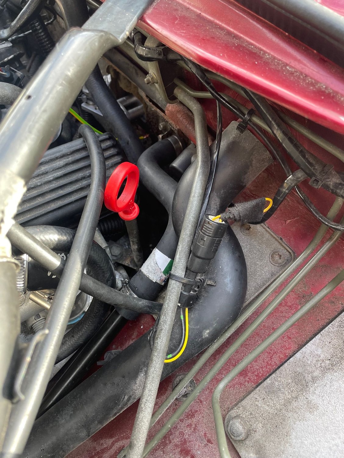

Good morning, finally update. Car is assembled and tested. Conclusions - temperature now goes in the middle between N and Red. Then Electrical fan kicks in and temperature goes down to N. As soon as i stop in traffic jam (Outside temp is +15) temperature once again starts raising until el. fan turns on.
So NO stable temperature... In general car is not Overheating up to HOT and not spilling out any coolant anymore, but still not stable in terms of engine temperature.
I dont know what to check even more
