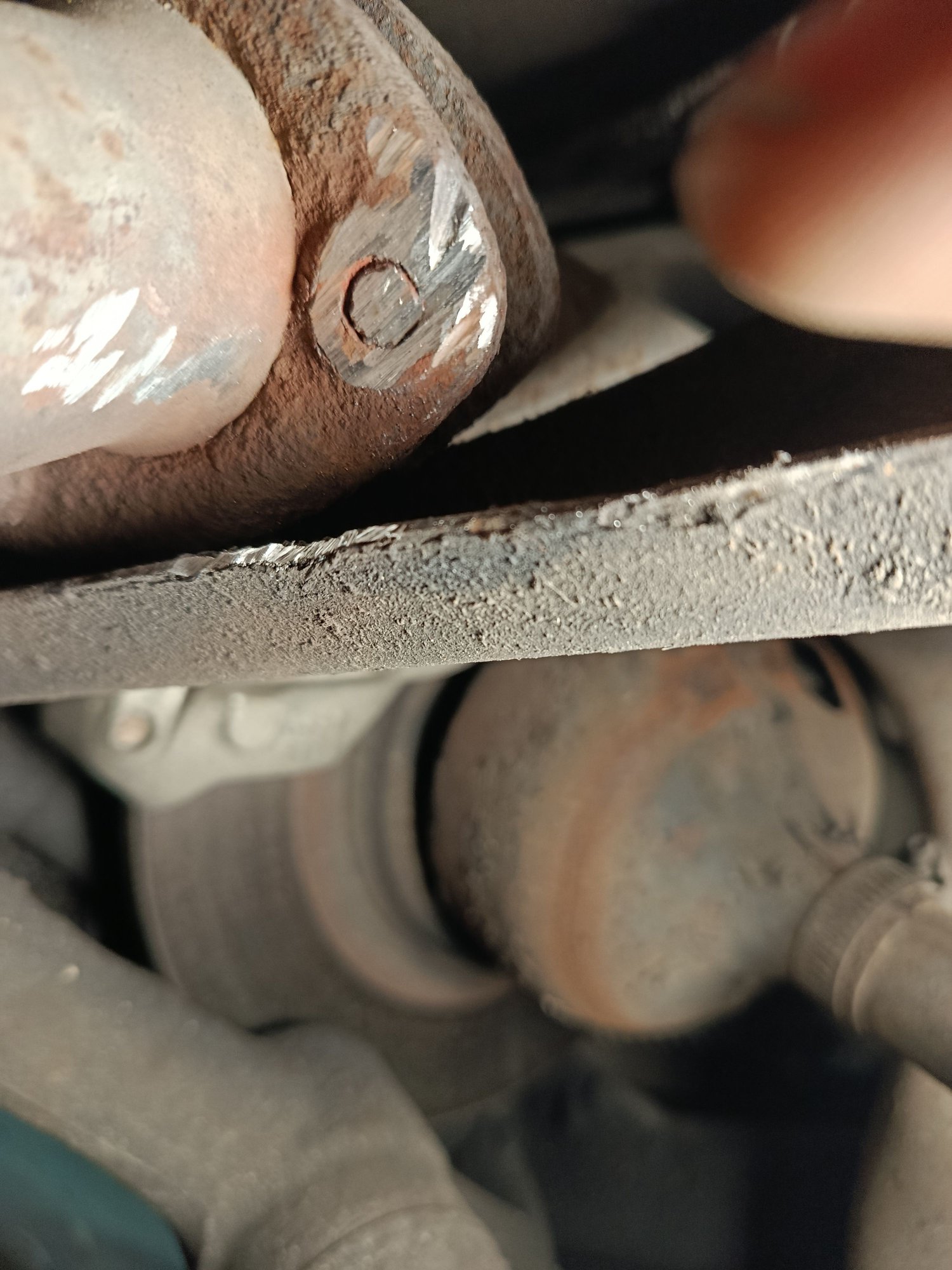

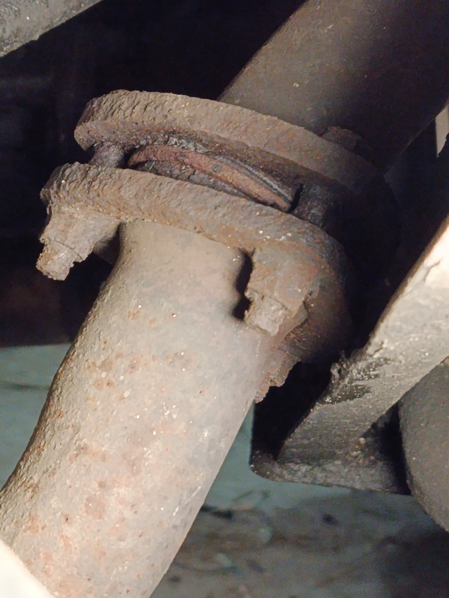

Lol, again one brilliant design where no tool can cut that bolts, nor remove the soldered nuts on the exhaust collar, delicious as a mint boiled chicken 😂👌
Any worst option has been chosed to build this thing.
Now what, i have to cut the exhaust silencers to free the IRS ?
Of course, what else ?
Changing handbrake pads require new exhaust line, new bushings, new anything you'll touch anyway as it's a disaster on wheels.

Those nuts on the exhaust look to have been welded. If so, that is not a Jaguar OEM fitment; a previous owner has done it.

Yes or maybe walker used to deliver it's exhausts with welded nuts who knows.
This is just disgusting lol. I would cut all this but then it would require new exhaust, what a nightmare for fürking handbrake pads.

The nuts were never welded from the factory, someone has been in there. I would use a cutoff wheel on a die grinder to cut the bolts. Then you can get the pipes out and deal with the nuts on a workbench.

I attempted this as well but angles are very smart designed, if you want to insert grinder wheel and cut bolts, then have to choose which other part near exhaust pipe you would alterate or destroy. Maybe a sort of flexible with a cut wheel but this would take ages. Fascinating how it looks easy to do on pictures but finally not easy at all and time consuming.

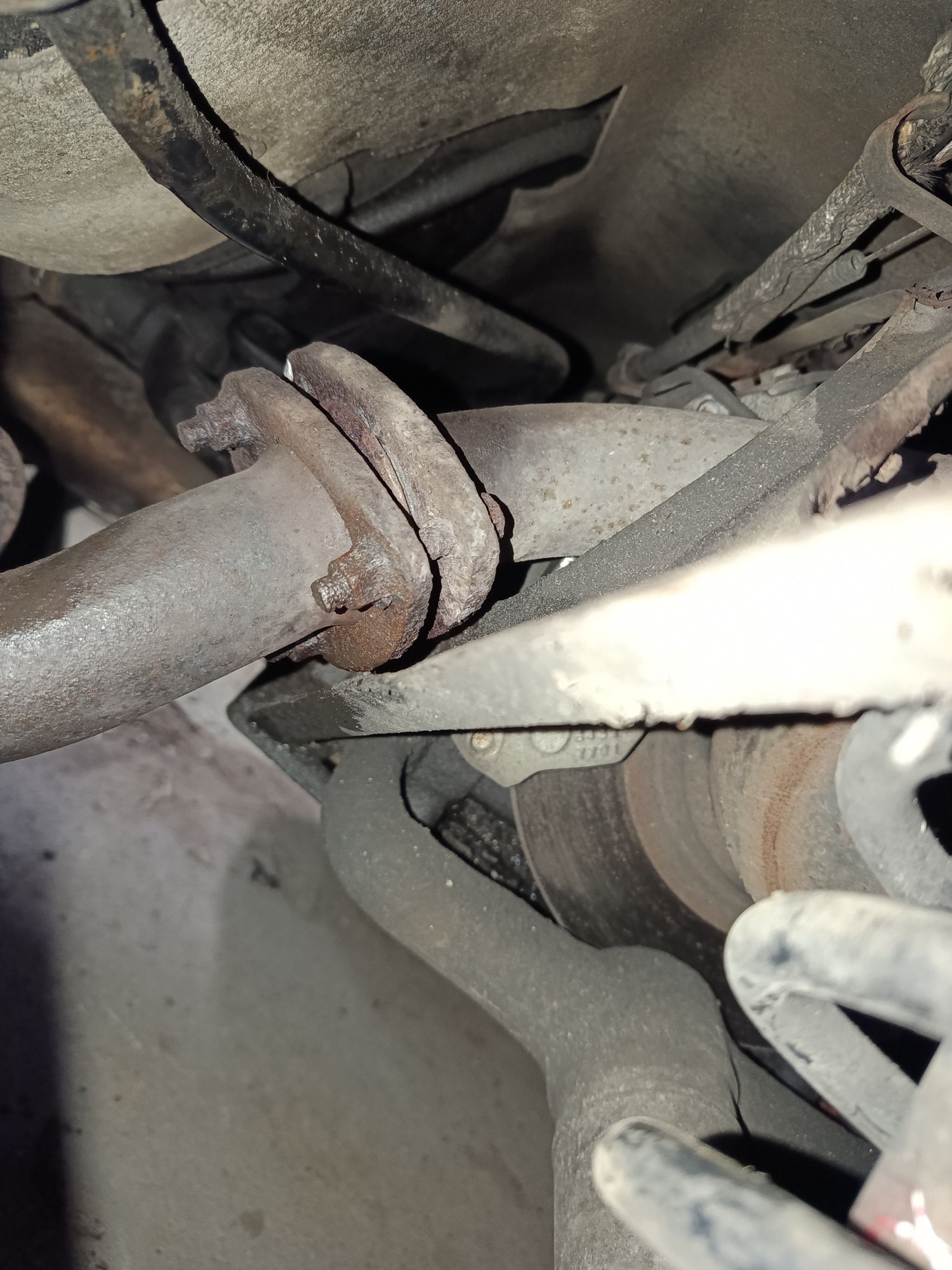

It's 4:40 in the morning here but at 8:30 i'll try with electric impact hammer i have, it's made to cut stones and concrete, it should be able to destroy the bolts.

I've cut them in the junkyard with a reciprocating saw without any trouble.

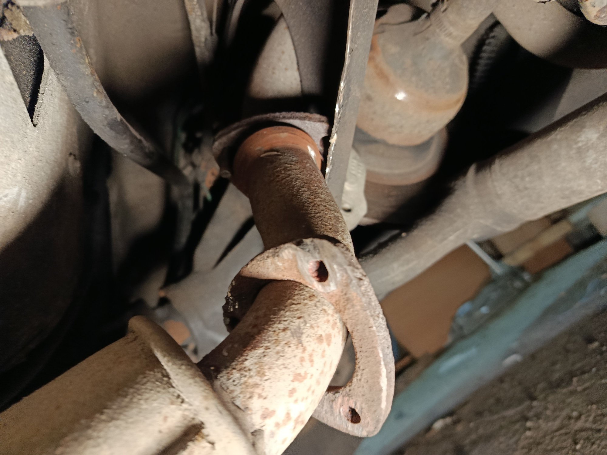

Finally got rid of these terrible soldered nuts and rusty bolts. It looks like walker exhausts are delivered with soldered nuts, they were too factory look to have been made by some sunday's mechanic like me.

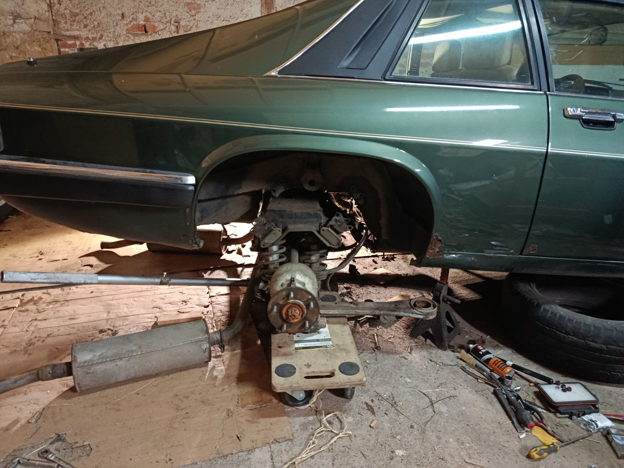

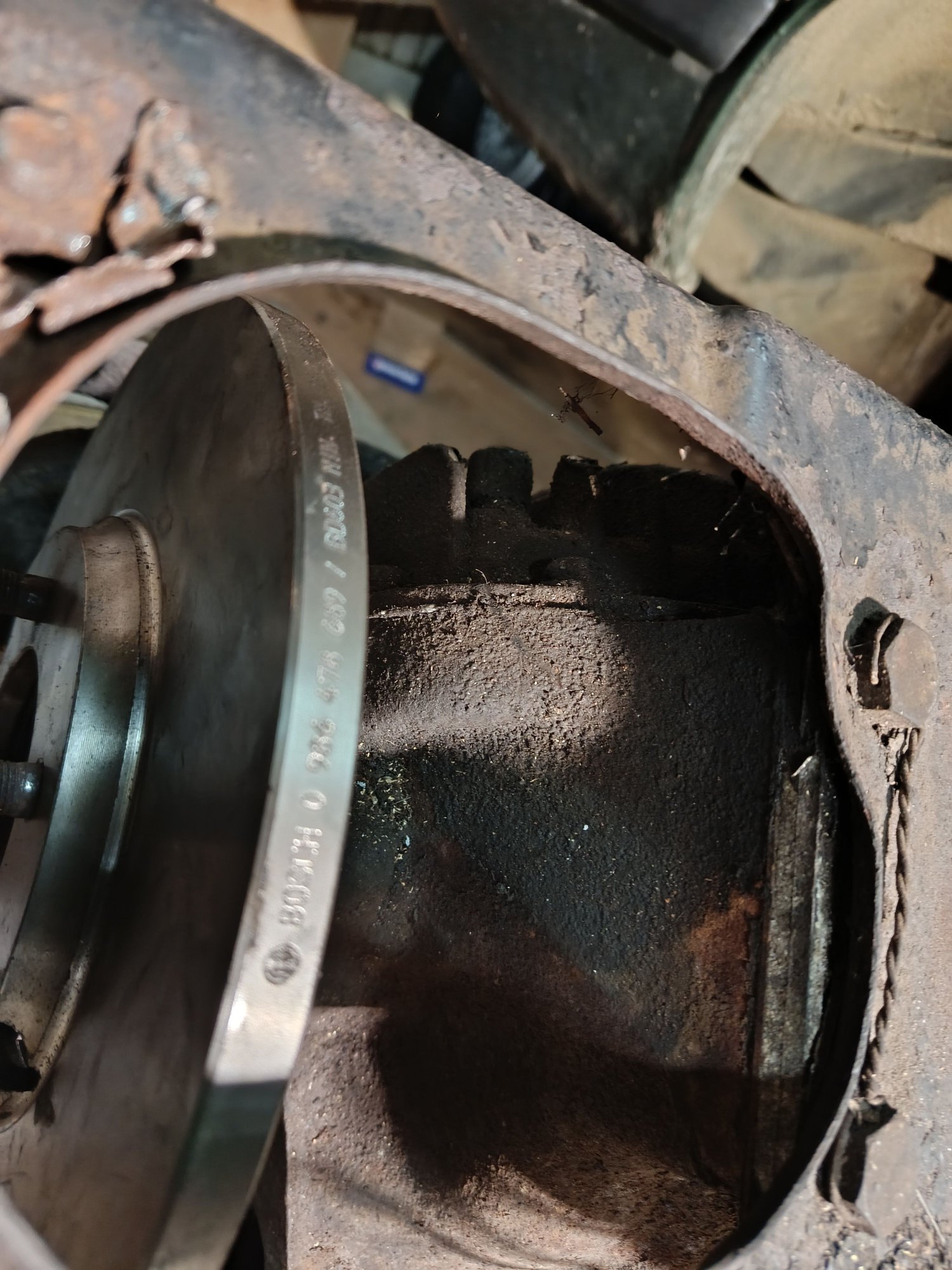

Excessive lifting the body is not that much usefull.
I pulled the irs on the side, slided it on reinforced platforms on wheels.

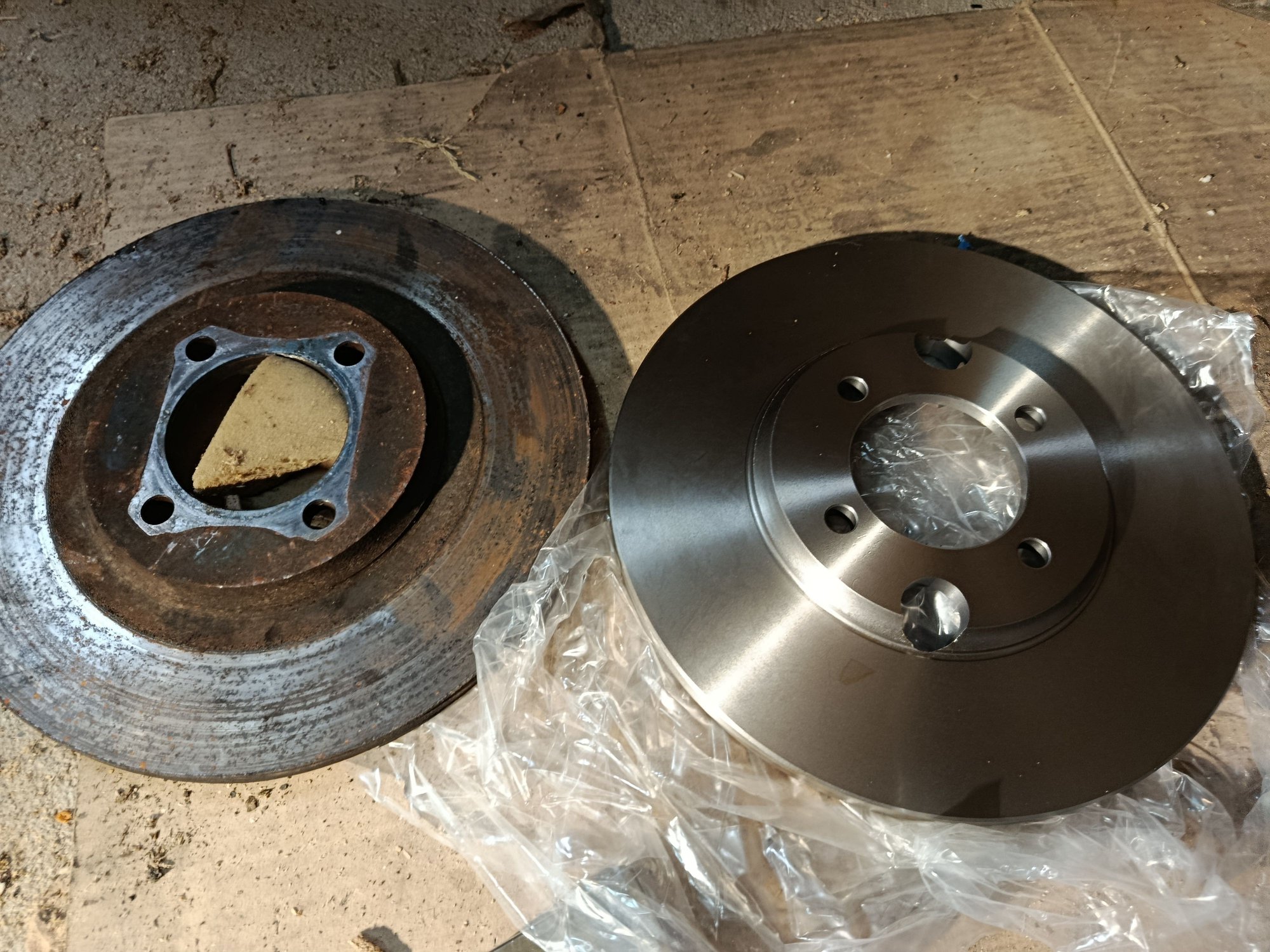

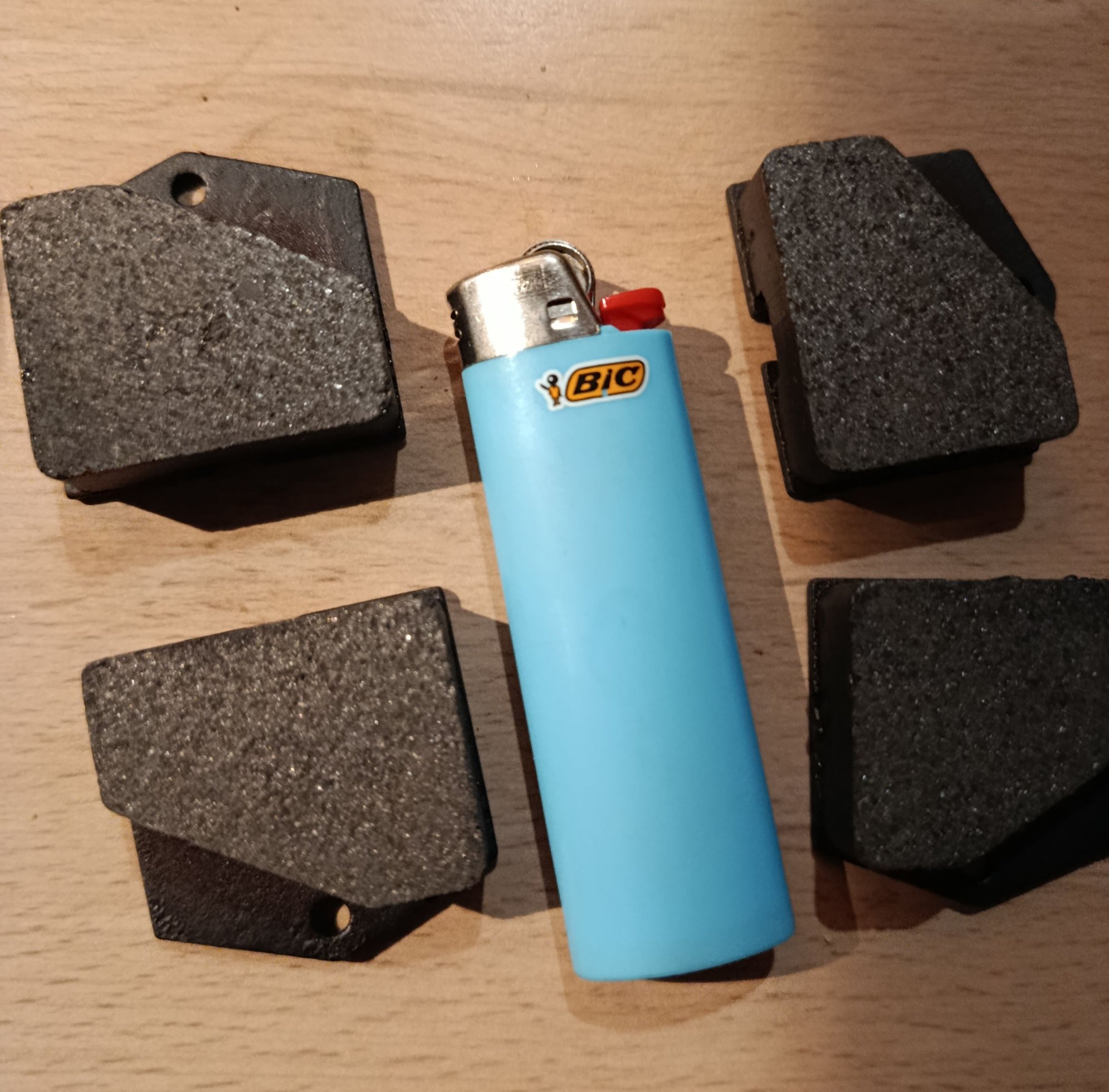

So this is supposed to brake 🫤

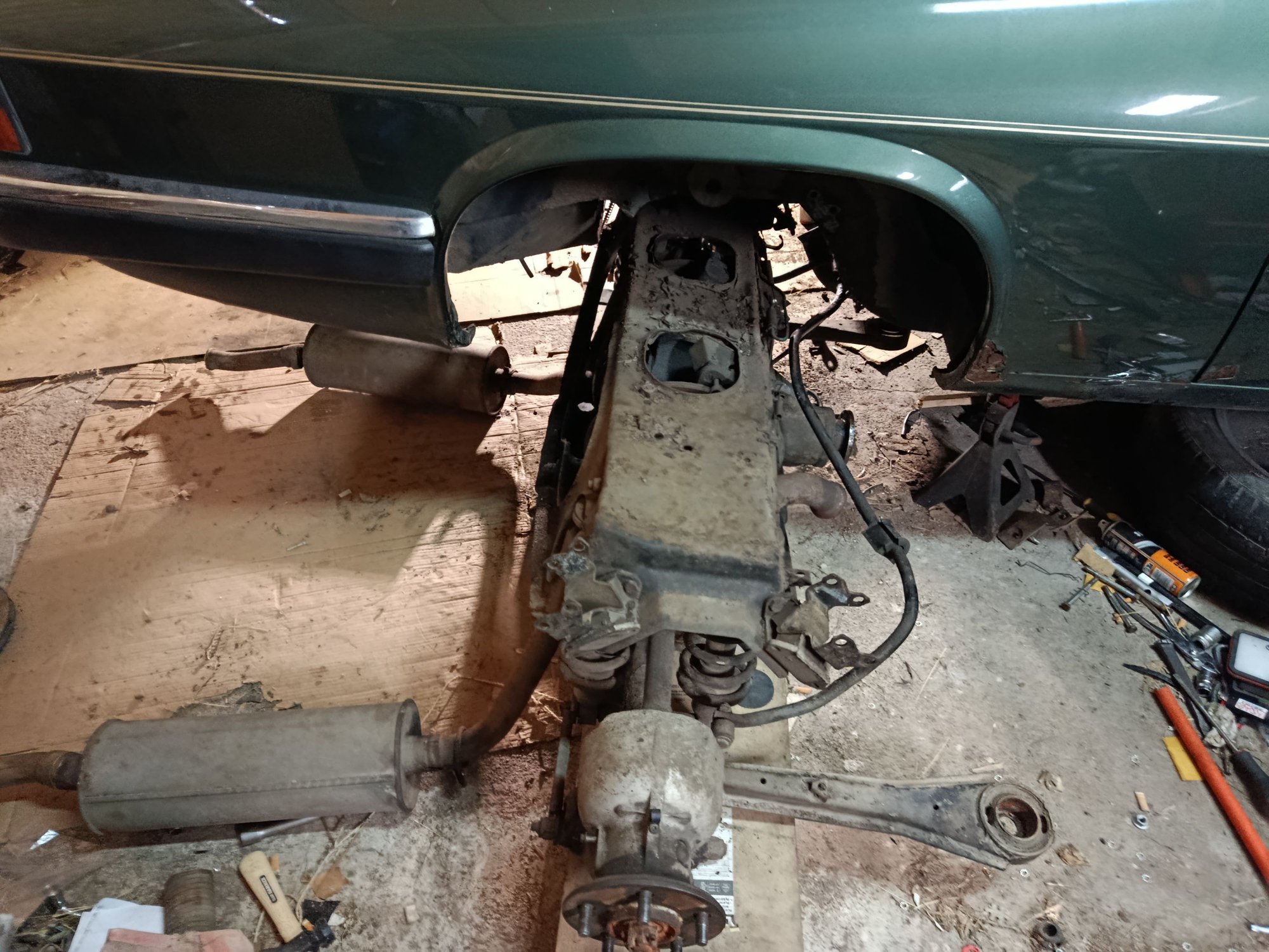

Slide the irs at reasonnable body height

Lol, Like if glue could keep pads affixed properly 🤪
News parts are still the same, with same weakness. Impressive engineering lol
Why not have used rivets through metal tiny cylinders to add extra strenght to tearing like these used on clutch, simple.
