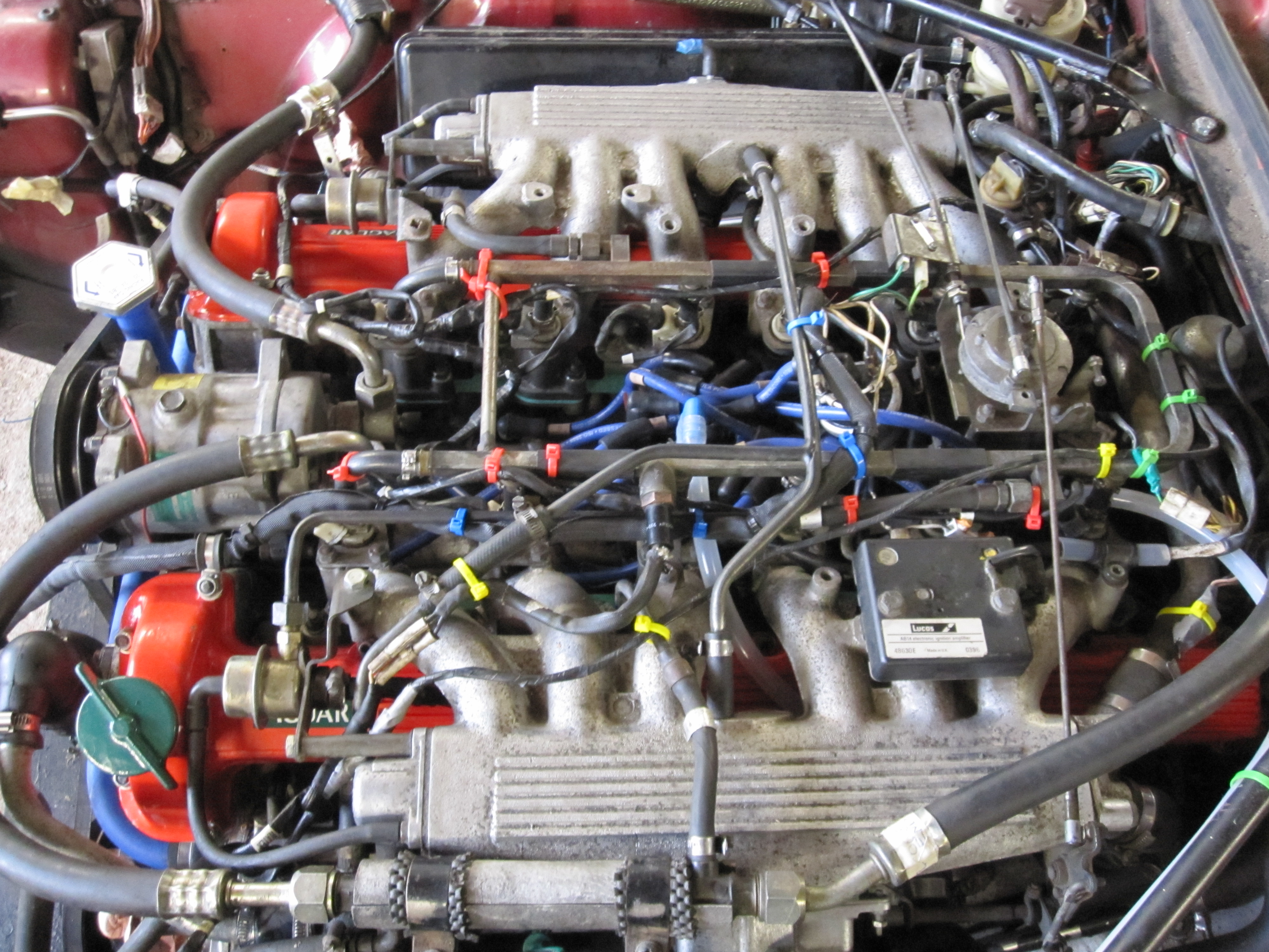

Greg in France,
If it isn't inconvenient for you, could post a photo of your Sanden installation?
Thanks very much.
Old Apr 7, 2016 | 01:33 AM
  #37
Greg in France's Avatar
Posts: 14,618
Likes: 10,821
From: France
Originally Posted by Mac Allan
Greg in France,
Thanks very much.
No bother
Greg
Attached Thumbnails Patient A/C Coaching Needed-img_0695.jpg   Patient A/C Coaching Needed-intakes-.jpg

Greg did you remove your cruise bellows?
Old Apr 7, 2016 | 12:25 PM
  #39
Posts: 14,618
Likes: 10,821
From: France
Yes, when I did my rebuild I ditched the cruise control and all associated loom and bits. V access and plug changes are much easier now. Incidentally, the Sanden is smaller in diameter than the old OEM A6 Harrison, so changing plugs A1 and B1 is considerably easier.
Greg
