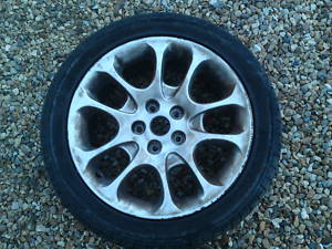

Can anyone identify ATL Dave's wheels by name? I've been doing image searches for XKR wheels but haven't seen that particular style.
Thanks!
edit: never mind I think the angle was throwing me off.

The wheels are called Double 5s, fitted to XKRs from 1998 up to about 2003, I sold a mint set recently for $500 with tires

XKRacer, thanks for that info. I think a set of those powder coated gunmetal gray would look quite nice on an XJS. Any photoshoppers out there?

Dick at Coventry West has a set of these just as you describe, gunmetal grey on a BRG XKE coupe race car. They do look nice that color.

WARNING to anyone wanting to put these, or any XKR wheels on an XJS, they don't just bolt on in the front, and the rears won't fit unless you have a later, facelift car...
Do your homework before you buy wheels, the late sedans, and XK's have totally different hubs, and such. The fronts require a spacer, and modifications to make the center caps work, etc. And the pre-facelift cars do not have enough room in the rear for 18" wheels/tires this wide.

Heh... well there goes that idea. Thanks for the heads up Dave.
