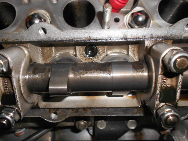

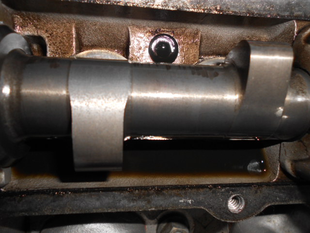

engine with manifolds and covers off,

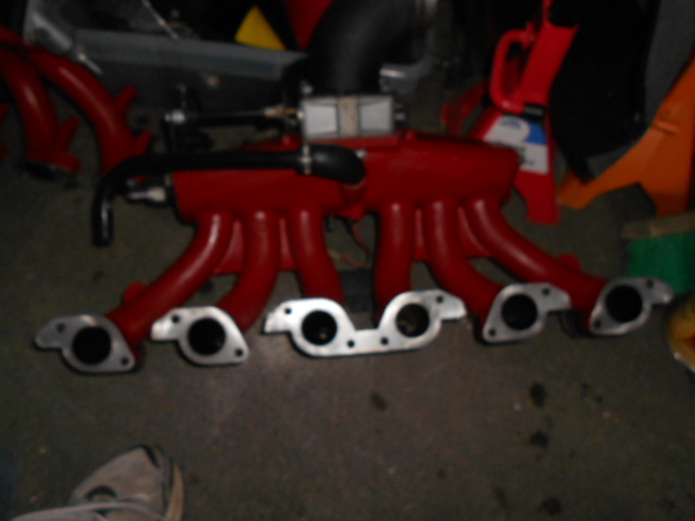

good pic of custom vac advance,fully adjustable for Hg #s, and degree amount, - Allen wench, thru the hose nipple.
2 Euro inlet mani, without air injection holes, heads are blocked also, US versions.
3 race cams, you can see the wide nose(compared to stock), cams open and close valve faster ,and hold open longer, lift .410 thou.
best is nitridding is still like new, no wear atall, cam followers show i could have gone to much more lift,without hurting durability, been16yrs about.
4 shows ported ports, and 5 is stamped PD, machine shop that did the head work, that i used the machinery myself, i dont feel comfortable with any one else doing my work, its a personal thing!!
6 just some color to sharpen things up, plug wires.

do NOT work on your stuff without blocking open head ports, its for pix only!
ping pong ***** work just fine,or anything at the toy department.
