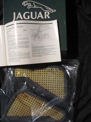

According to the parts book JLM11108 are only for up to 91my. and post this date is a differant part no. JLM11696 & JLM11358
does anyone know why this is?

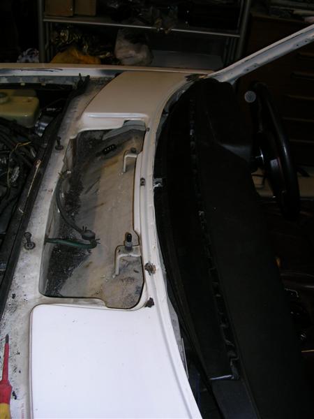

yes , they do fit , and fit well
i have installed them on my 1989 Coupe ,
remove the wiper arm grille, and the filters simply push into the side box sections , these sections allow air into the plenum for the fans etc
they are directional , so follow the instructions
i found that a bit of jiggling is required , as they seem oversized , but once in are a snug fit ,
there is no requirement for more air flow or anything , and they do filter the air quite well providing they are a snug fit

1. but does the facelift differ by fitting under the grill.
2. and will the prefacelift fit a facelift car?
£12 is not bad on ebay as manners want 40 odd quid +

Originally Posted by rgp
thank all.
1 , it doesnt
2 , yes
3 , buy it
as i said........
BB

yes I bought 10 last December 2012, that is a pic of them fitted, I only wanted to know so I could advertise the remaining 9 on ebay and be model specific, although 4 of them were miss labelled series 3 filters when I looked.
