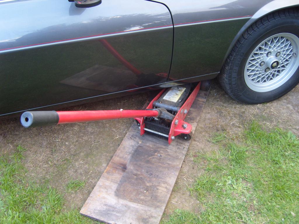

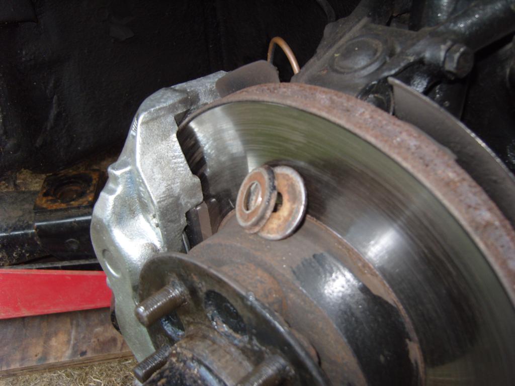

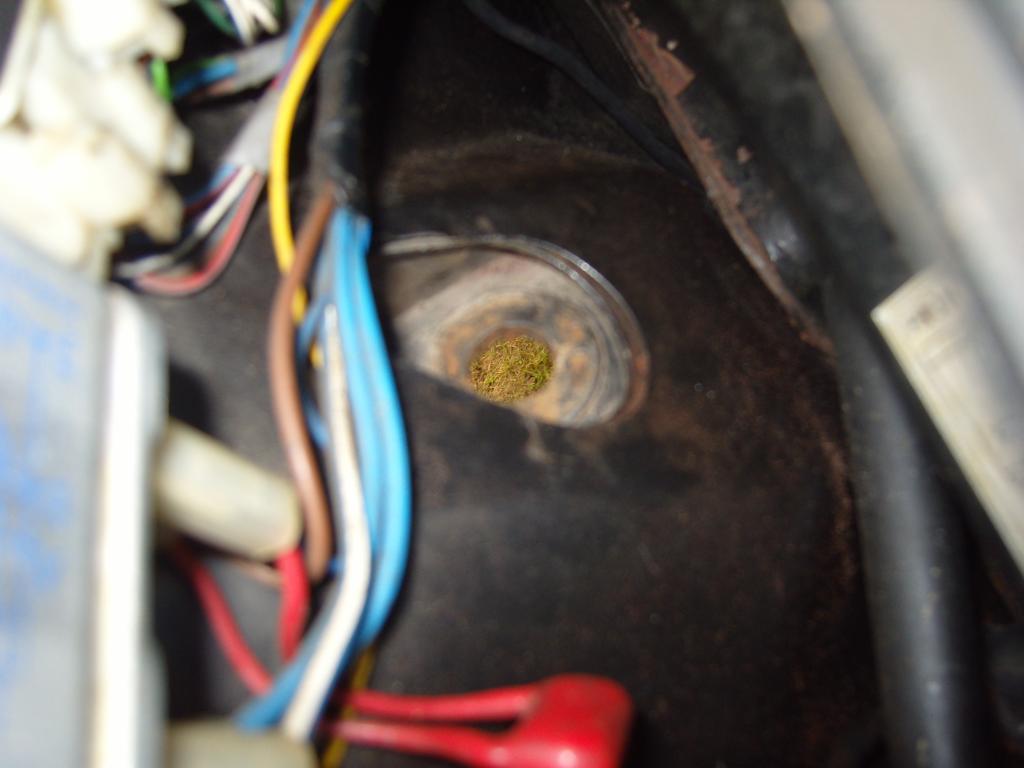

Are you Serious?
Do you really want me to try out these Home Made Bushes, just when I was getting Convinced that they were a waste of time and I should have gone with OEM in the first place.
All my fault for being such a 'Cheapskate!' but £25 for a Set of Polyurethane Bushes, that I cut out of a Chopping Board for nothing, seemed such a rip off to me.
But having re-read through your Advice, I can see the 'Stication' of OEM plays more of a part in the ride, than I at first thought.
So to bring you up to date, the Cars jacked up, the Wheels are off and all the washers and metal cups are out.
The Shocks themselves are really A1 as I had to pull them down really hard to get the Cup Washers off, then as soon as I released them, they sprung back up to the Top.
Not surprised as with no bushes either on Top or Underneath, they were not being compressed and the Car was left to bounce up and down on its own.
So anything that stops this in anyway at all, is a big improvement on nothing!
Unfortunately the bottom cups look a little bit battered, so any ideas what I could do about that.
Undoing the Shocks and everything else, was a piece of Cake but thinking the Car was all sorted, only to find another problem like this one was a real downer, and as a result, 'Misson Creep' then set in.
All OK now with the GF but I'm sleeping with one 'eye open!'
