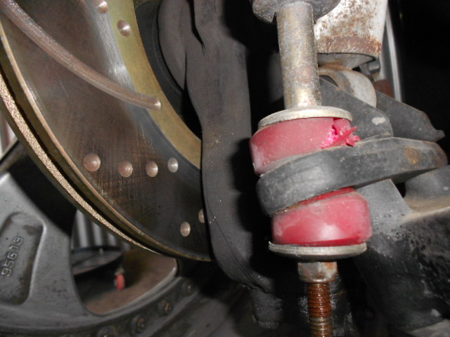

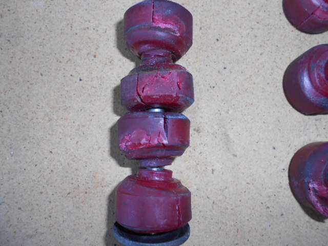

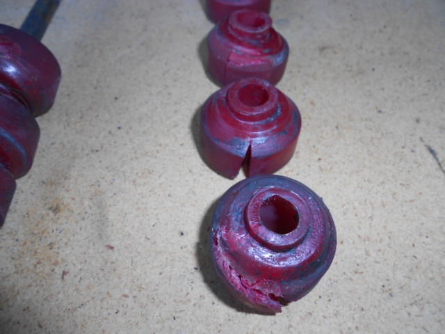

this morning i decided to look at my stabilizer links front and shock(damper) bushes.
pix of poly bushes, about 2yrs old, less than 2000miles on them, KYB shock bushes perfect,rubber,21yrs old,around 7000miles.

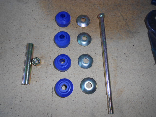

went to local auto store ,got the MOOG link kit,$8.25 usd, each side,includes bushes,bolts nuts, washers.
MOOG suspension components makes some of the best we can buy here!
as pix show i'm not pleased with the poly bushes all split and cracked, and for that little money, i'd be silly to try and make them.
complete job took about 45 min, to complete!

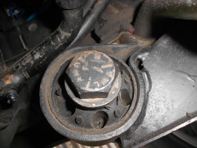

pic of sub frame forward mounts, ORiginal 35 yrs old, Jag must have had access to good rubber at the time 1978. altho my car only has 23000 miles on it,always garaged.
Attached Thumbnails Polyurethane Shock Absorber Bushes Question XJS V12-001.jpg   Polyurethane Shock Absorber Bushes Question XJS V12-005.jpg   Polyurethane Shock Absorber Bushes Question XJS V12-006.jpg   Polyurethane Shock Absorber Bushes Question XJS V12-008.jpg   Polyurethane Shock Absorber Bushes Question XJS V12-009.jpg

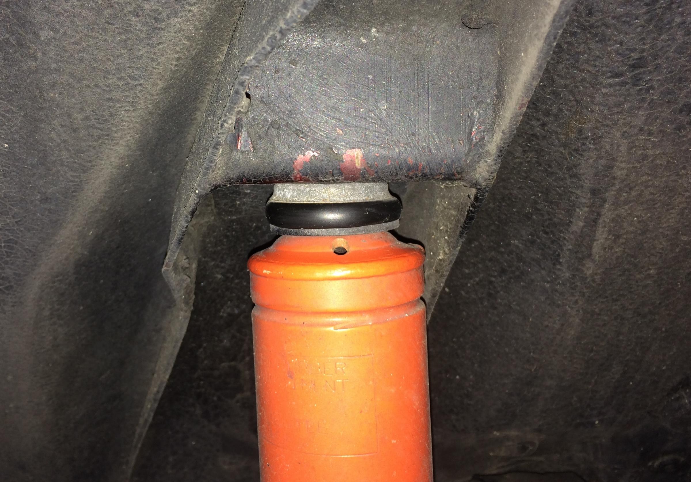

My poly shock upper bush pic. After 4 year/40000km use, no sign of wear and tear at all. Still glossy.
Why do I post this? Because I like comedy show :P
(No offence, just kidding!)
