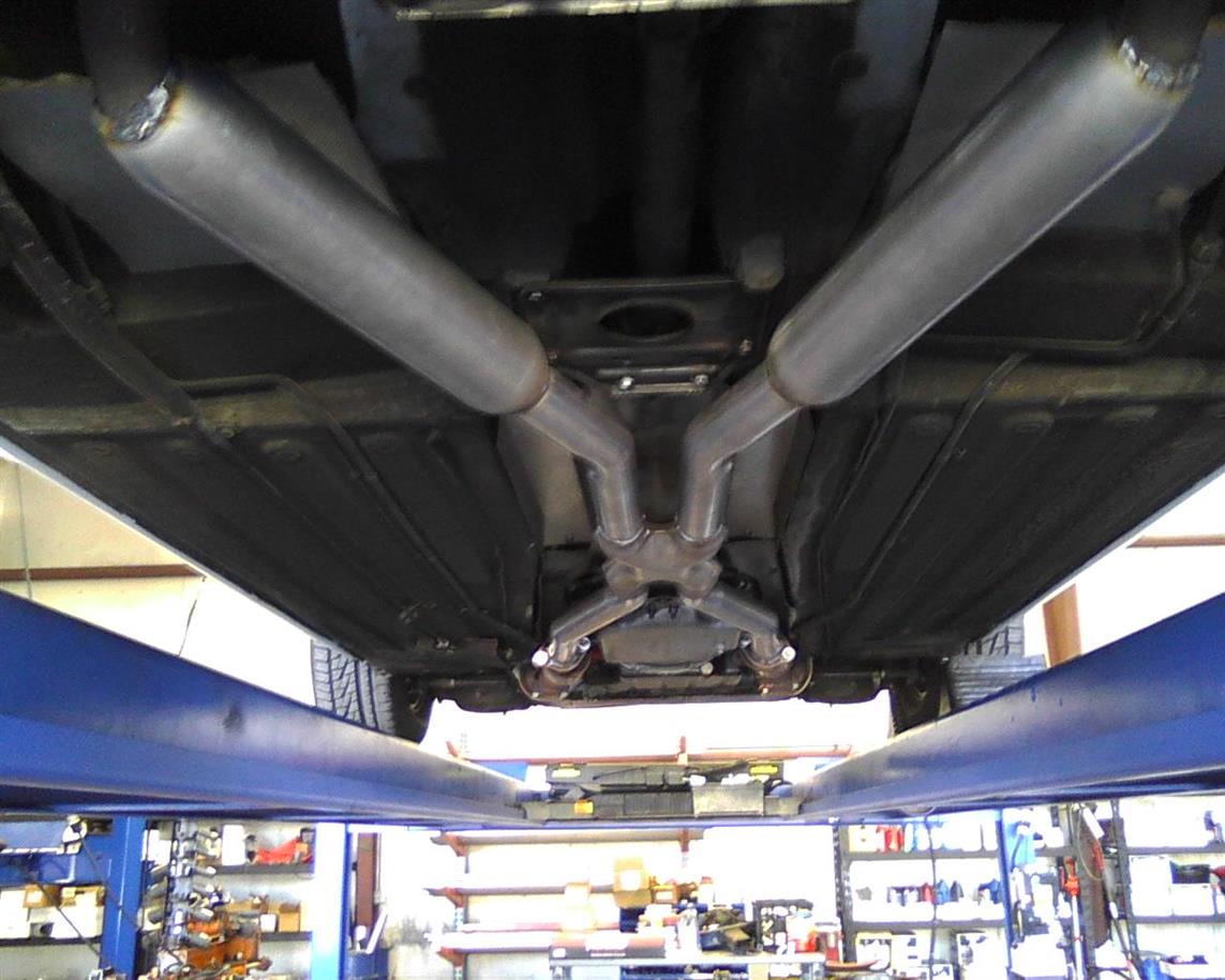

I've attached a pic of the x-pipe arrangement I had built for my V12. Not seen are the rear resonators. I am happy with the sound; much better than my other V12 which didn't have the x-pipe but was otherwise similar
DD
DD
Doug, Carl and Vancouver,
Great input; just what I was looking for. We have a couple of shops there who can do the job. I'll show them that picture; want to try to get the "right" sound. Don't want anyone complaining about the loudness, just a nice rumble.

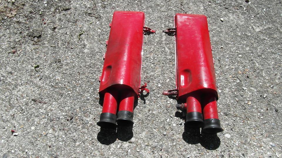

Mine has the centre boxes removed and TWR quad tailpipes; not add ons but proper silencers (mufflers) with twin pipes.
Sounds really good but not loud enough to annoy the neighbours.
I also have twin intake air filters which give a slight increase in induction noise.
Attached Thumbnails Poor performance-100_3201.jpg   Poor performance-100_3431.jpg   Poor performance-2014-07-10-001-1.jpg

That's a bit lairy, is he running on slicks?
I reckon that setup could be done whilst retaining the factory tail pipes, no? I'd love to hear it running if you have a video.
Thanks!

I'll see if I can a decent recording device; last time I tried it, it sounded more like a lawn mower when I played it back!
