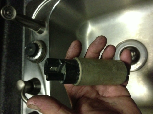

I just (this last week) replaced the fuel pump in my 1995 XJS, and it did not look anything like the one that you pictured. Picture attached. 1.25" diameter, about 5" tall.
I replaced it with one supplied by NAPA made by Delphi ($144), took me about 4-5 hours to replace. Replaced fuel filter at same time.

Oops, you're quite right, I goofed and posted a pic of the fuel pump from a MY94, the pump for MY95 is as you've shown. (Sorry to mislead Taso )
