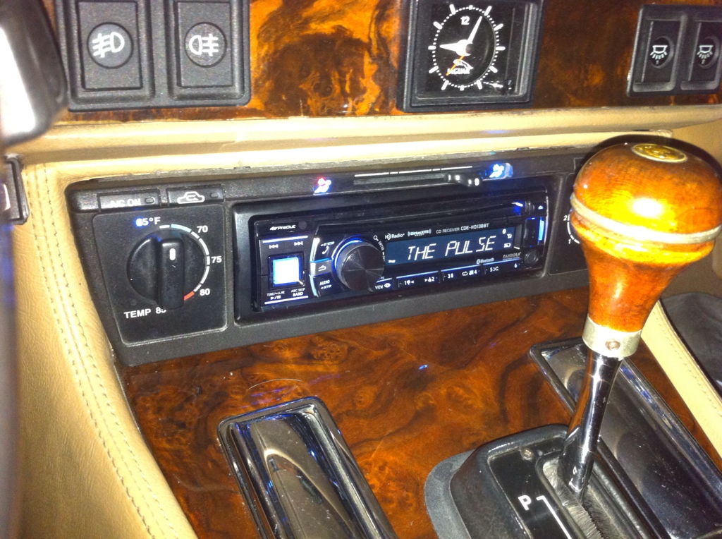

It was very easy. I found that the original OEM unit had an adapter from it to the main harness, so I was able to remove that adapter and solder the wires to the new head unit and power pack portable alpine amp that just piggie backs from the same wiring. Great Sirius XM, Bluetooth , HD radio, auxiliary ports etc, but does not look very complimentary with the car IMO:
Attached Thumbnails Installed new CDE HD 138 BT Alpine head unit on 95-262b6a52-6bb1-4286-a02e-226448a92391-2298-0000024283f2bce7_zps57e3363f.jpg   Installed new CDE HD 138 BT Alpine head unit on 95-ee999a68-50e8-4efa-9bf2-5e3e879a8ef5-2298-00000242a09930f1_zpsb1750564.jpg   Installed new CDE HD 138 BT Alpine head unit on 95-2a8ff2dd-d9b0-4015-8502-7a1a45c13744-2298-00000242e83e9fe0_zps19520837.jpg

I like it. It's very difficult to get a system that looks at home in the XJS. I've had about 4 different units in there over the years. The one that looked the best match was a pioneer system where you could adjust the back illumination colours through 64000 different combinations to get it to perfectly match your car. So, I adjusted it to the sickly green glow of the rest of the dash and it blended in, ie
Unfortunately, the stereo itself wasn't very good and was missing some key features I needed (bluetooth for one) so it had to get swapped out before long.
Glad you got the feature set you were looking for

Thanks. I think it looks much better with the lights of. At least it was not that difficult to install and has all the capabilities I want

Got the new unit early !
It's got everything the old one has, only difference is the I can change the display color, it's got a nicer display (no crazy disco effect) and the AUX and USB outputs come from the back, which means I have to find someplace to run those cables to.
I was thinking putting them in the ashtrays.
Thoughts ?

I ran my 3.5mm auxiliary jack into the front lip of the black plastic basket at the armrest. You won't even know it's there, until you need it!
You'll need to buy the jack from Radio Shack and splice an aux cable to it. Basically run a double ended aux cable from the back of the radio, down into the ski slope area all the way into the armrest. Then drill a small hole (I forgot what sized bit I used) in the lip and...well, the rest is easy to figure out.
It's best to get an aux cable that has a 90 degree jack, this way, the wire won't interfere with the window controls.
As for the USB, I'm not quite sure why you would need that anymore. I used to plug in a flashdrive, but it's really more trouble than its worth.
Maybe to recharge devices? That might be best left to the ashtray.

That's a great place for it, Vee.
I probably will go ahead and try to do it inside the ashtrays, although I don't know how difficult it will be to drill thru them to get the cables inside. Ill do the aux on the right and the USB on the left. I won't be able to install until next week when I go by the body shop or I might just wait until they give me the car back in a few weeks.

I did that before I did what I did.
There's large enough gaps in the ashtray assemblies to snake in cables without cutting any holes.
It's a great idea. I swapped my ashtrays out for the cup holders, so that's why I needed to come up with a new plan.

For anyone wondering how this turned out, the new radio works better with the car and my aux socket is in the cubby, much like the new cars:
Attached Thumbnails Installed new CDE HD 138 BT Alpine head unit on 95-null_zps9e50ff19.jpg   Installed new CDE HD 138 BT Alpine head unit on 95-null_zps658975d1.jpg   Installed new CDE HD 138 BT Alpine head unit on 95-null_zps310c3274.jpg   Installed new CDE HD 138 BT Alpine head unit on 95-null_zps9f436050.jpg
