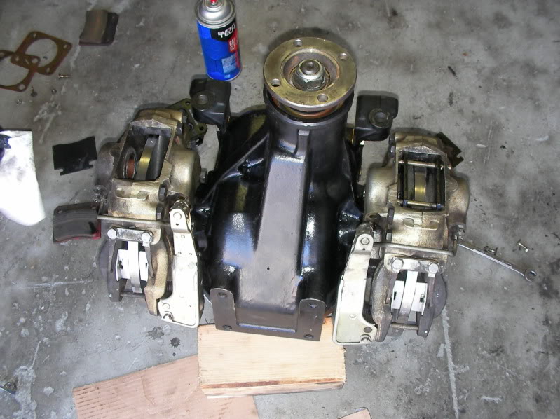

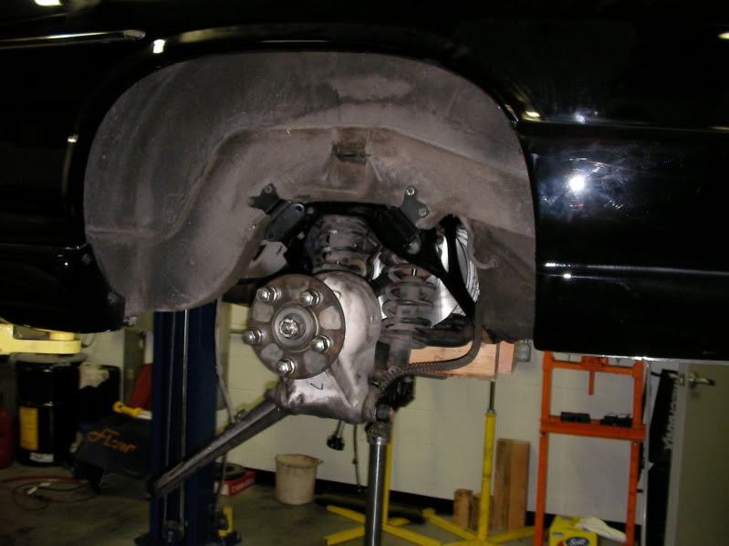

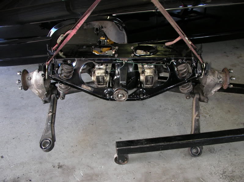

Look what we did today!

Man, that looks great! You are really getting this done fast. I'm doing the same rear-rebuild on my 84 XJS. I started way before you did but mine is still in pieces...lol!
Good job man, keep it up!!

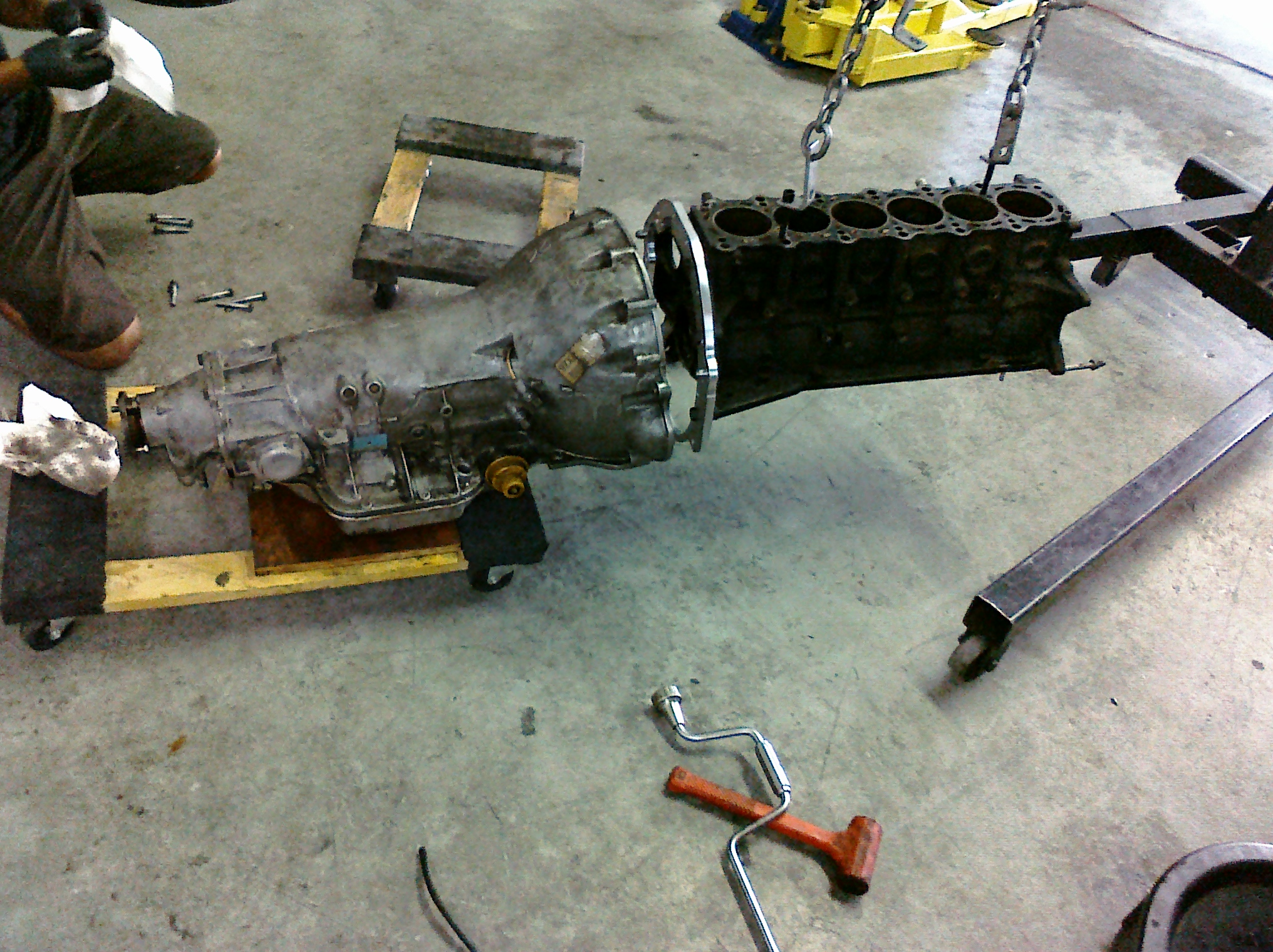

Finally we got the transmission adapter! We started mocking it up in the engine bay with an old 1JZ block and a rear sump Supra/Soarer oil pan. Everything is going to fit nicely! There's tons of room in the engine bay, it's going to be great for a single turbo setup!
Flexplate for the torque converter. (doesn't look like it will flex much!!!
A match made in heaven? We'll soon find out!
In this pic the transmission is completely bolted up to the factory bracket, and the pan clears the steering rack like the JZ engine was made to be there!!!
It's getting there.....

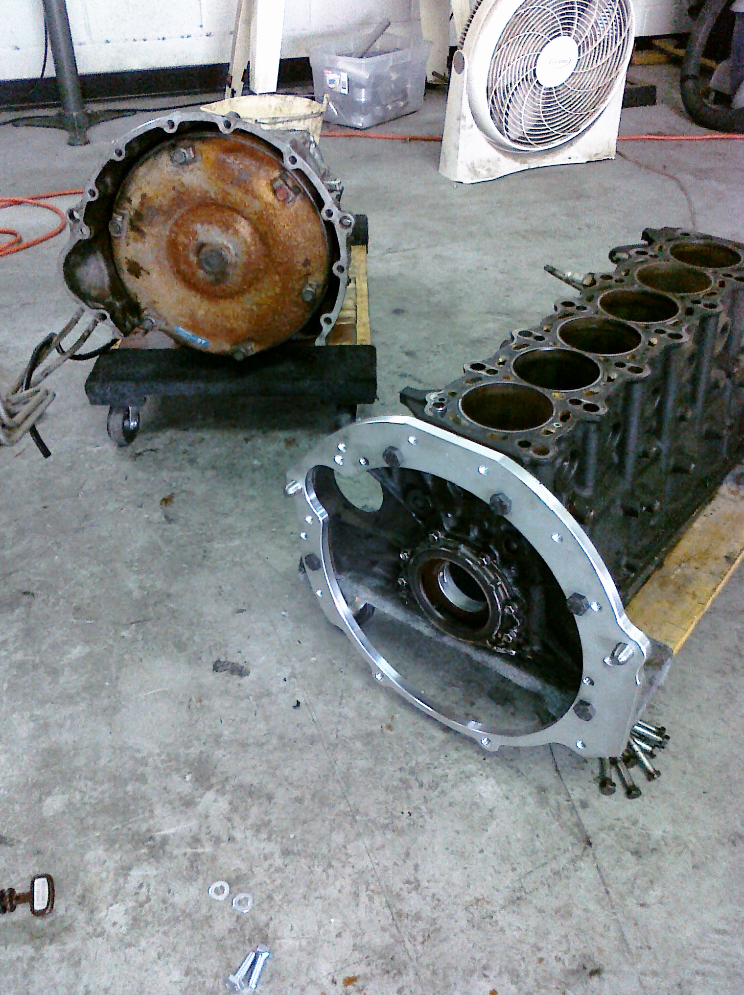

Well we finally got the oil pan and installed it. The new 2jz-gte I am using for the project now is super clean. So we put the flywheel on, and go to install the torque converter, only 3 of the 6 bolts have the correct pattern! Then we try to just mock it up with 3 bolts on the torque converter, and we go to put the trans on the engine with the torque converter installed, but it will not go on! The bell housing bolt pattern on the adaptor plate is 1/3" higher then what it should be in relation to the engine bolt pattern! They made a big mistake in making the adaptor. So they are going to make another adaptor, at their cost obviously, but now it's taking even more time to get this thing put together. Oh well, **** happens I guess. If it wouldn't have taken 5 times longer to make the f-ing adaptor in the beginning, it wouldn't be so bad!
I contimplated just calling my credit card company and disputing the charges on the transmission adapter and parting out the car and selling the engine..... for like 5 minutes..... but then I thought "I can not fail! The project MUST go on!!!"
The Jaguar WILL live again with 2jz power!
