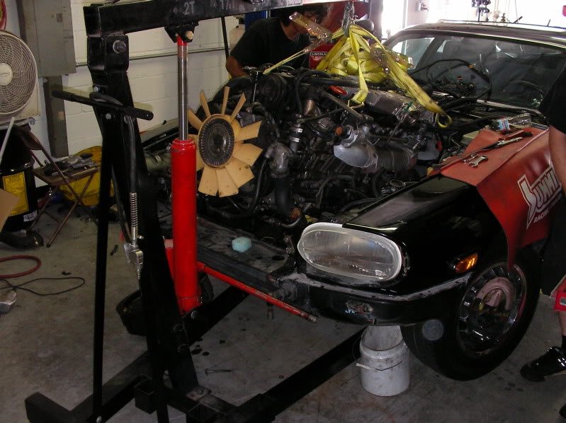

The engine was out of the car in a few hours.

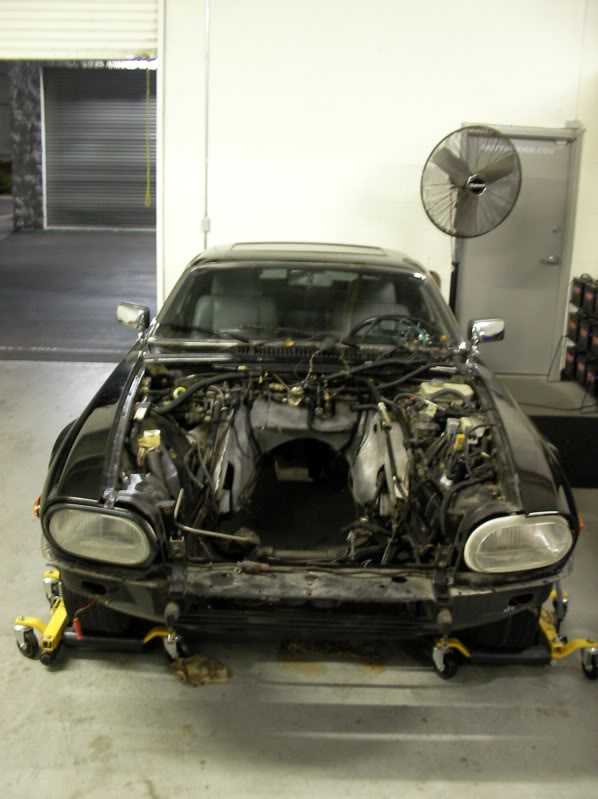

Wow, that V12 engine is HUGE! If it didn't get 11-13 mpg to make 300hp, I would probably fix it and put it back in! LOL I think the engine we're installing will be a better way to go, around 375hp and hopefully somewhere around 18-20 mpg (it's a heavy car after all). It's a twin turbo 2JZ from a Japanese Aristo, and we're most likely going to put a big single turbo kit on it sooner then later.

Here's where we're at as of tonight.

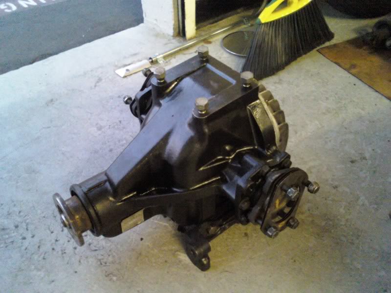

Unitrax called me on Friday about my diff. It looks generally ok, but the bearings are slightly loose in the carrier on one side for some reason.
I guess isn't enough to make it spin in the carrier and cause damage, but they are supposed to be press fit yet right now it slides in and out by hand.
They are going to replace the bearing and put some lock-tite on the outer shell if it's still not tight to keep it from becoming a bigger problem, plus they are replacing all the other bearings and seals, and new clutch packs for the LSD.

I got the diff back today! Now it's fully rebuilt with all new bearings, o-rings, and seals!

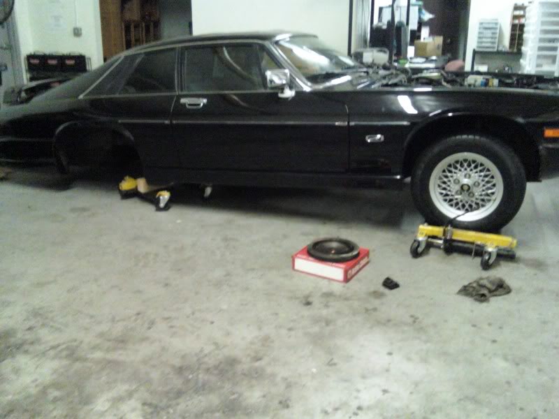

The Jag is sad with no rear end
