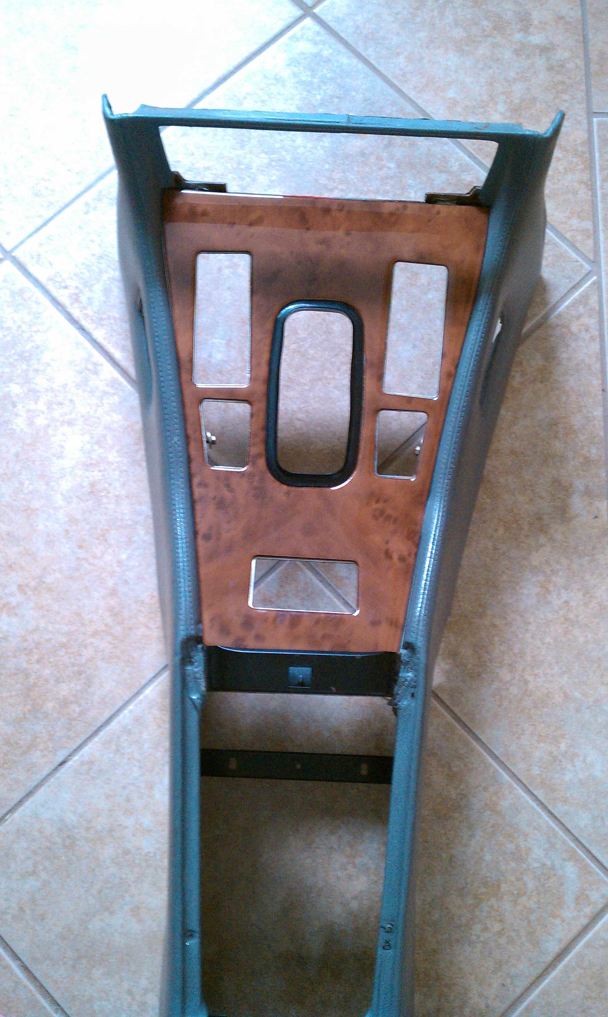

Here is today's project.
eBay woodgrain kit!
