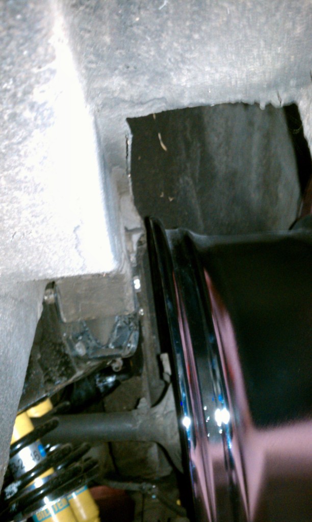

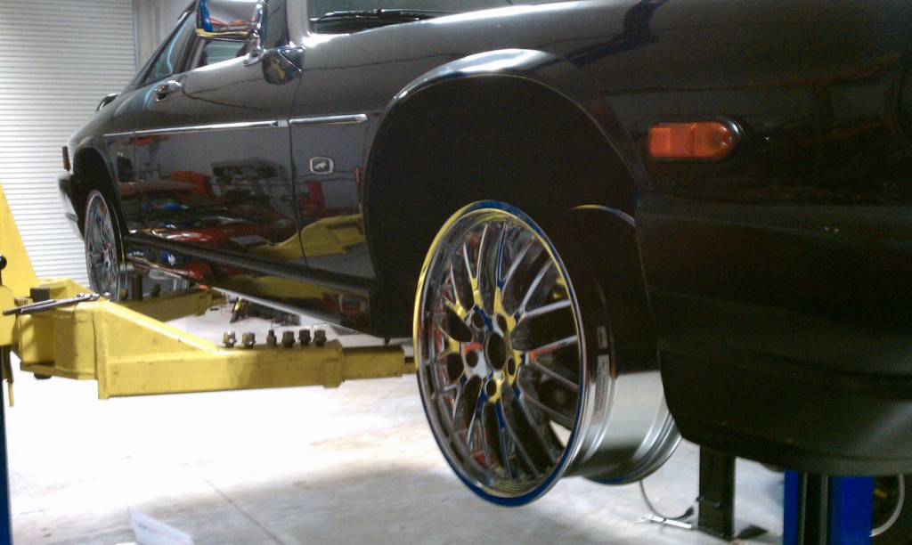

We just moved to a new shop, so the Jag sat in my back yard for the last month or so. Just a bit of an update on the car....
Got the new wheels, and test fitted them on the car! These wheels only come in 120mm lug pattern, and the Jag is 120.65mm, so just to be safe I had a place that does machining modify the hole pattern so they would fit properly. These wheels already have an unusually large 76mm center bore and low 20mm offset, which is needed to fit over the stupidly huge XJS front hubs. I think that with all the chrome trim on this car, the chrome mesh wheel is really going to look nice!!!

Rear wheel sitting at ride heaght. I am going to lower the rear about an inch, and raise the front back up about an inch, to help level out the car.
9.5" wide wheels on the back of a XJS?!? But wait, I read that only an 8" wheel would fit.
Looks like my tape measure didn't lie!

New wheels were finally installed today with Nitto NT05 tires!
235/40/18 front, 265/35/18 rear. I lowered it about 3/4" in the back so now it sits exactly like I had envisioned when we started working on the car. I love the way the car looks so far, what a difference wheels make!

Looking good, from a previous picture did you have to do any more mods to prevent the tyres rubbing on the inner edge at the rear?
