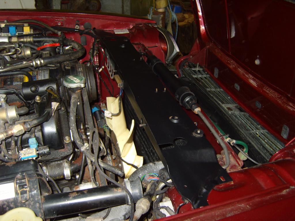

Hi Bro
It's not that hard to take the Rad out, once you have got the bottom hose off, especially the one on the passenger side, which has a second smaller hose coming off the main one and also the bottom oil pump hose on the drivers side of the Rad (UK Spec)
Having struggled the first time, if I had to do it again, I would cut through that double hose with a bread knife, because the smaller hose that spurs off it, invariably gets jammed up, when you get to the stage of lifting the Rad out.
Don't do the same with the oil pipe though!
Get a spanner on that one! You cannot see to undo it, you have to undo it by feel, the good news is not much oil leaks out but some does, so do have something to catch it standing by.
Its not that hard to lift out on your own but much easier with two people, also it is not bolted in at the bottom, there are just two metal pegs dropped into two rubber doughnuts.
If it feels like it won't come out, its that smaller hose getting jammed, which is why cutting it through makes things much easier.
If the Rad feels unusually heavy, its because its full of 'Crud' and once its out check the beam it sits on for any rust damage, clean it, paint it and pump it full of 'Wax Oyl'
Its would make sense at this stage to give the front of the engine bay a really good clean out and check for rust.
Also I wouldn't waste money having it washed out, I would go straight for a re-core like 'Greg from France' suggested because in any event the Matric will be full of Crud and dead flies.
So what can go wrong? You can very easily damage the fins of the Rad when you take it out or put the re-cored one back in.
And that also goes for the Alloy Rad that is in front of that one.
Also take the bottom brackets off of the Fan Cowling, because otherwise it will get jammed up, when you try and get the Fan Cowling out.
Although you don't have to take it out, its one hell of a lot easier all round if you do.
Also note where all the wires connect to, there are lots of them but shouldn't be a problem to a Pro electrician like you.
The whole job looks more daunting, than it actually is but not something that you would want to take up as a hobby, so if you go for a re-core you won't have to revisit the scene of the crime later on.
You don't have to take the bonnet/hood off and I'd recommend that you don't although of course others may disagree on that.
But you do have to take the gas struts off, so you can get the bonnet/hood up nice and high. (that bonnet/hood is much heavier than it looks) so preferably tie it up so it can't fall down.
One of the most awkward jobs 'Could' be undoing the Gas Struts believe it or not!
They either undo very easily or if not are a PIA.
Other than a Case of Beer, Antiseptic and a 'Big Box of Plasters' and you should be good to go.
Unless you want to treat yourself to a 3 ton Trolley Jack, which on these cars is going to be worth its weight in Gold!

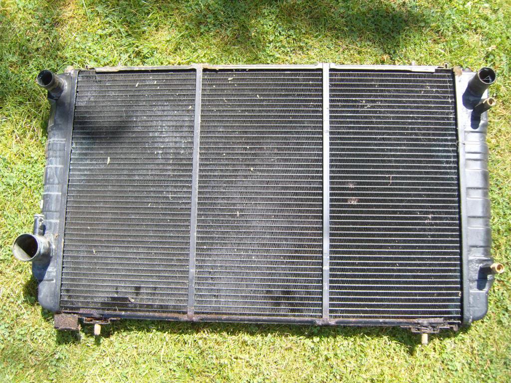

Its isn't really the kind of job, that any 'Normal Car Owner' would really want to do but XJS owners arn't what you would call normal, instead we are obsessive fanatics, who won't let any job beat us.
Back to the Rad!
The Rad is basically two radiators in one, with the 'Big Bit' cooling the Water to the Engine.
But on the Drivers side of the Rad (UK Spec) on the Left hand side, if you stood facing the bonnet/hood.
You can see a Couple of hydraulic hoses screwed into the Drivers side of the Rad.
At least you can see the top one but probably not the bottom one, which is some distance beneath it.
It certainly isn't obvious that there are two Rads in one, as apart from the two Oil Conections, it looks like a normal Rad.
Removing the Top hydraulic hose is easy but as far as the bottom one is concerned, you can hardly see it as your hand will be blocking the light, so this is the one you have to do by feel.
The only good news being that you know what spanner to use, its the same as the top one.
Its not that bad, its just a bit of a fiddle, which is where those sticking plasters are going to come in handy!
I wound up in A&E just so you won't have to, so beware of all the sharp edges you are going to come across.
The fact that the Rad is Two Rads in one, is what make a 'Brand New Replacement' very expensive and a re-core that much Cheaper because it is very unlikely the Oil Side will be Screwed.
So they will leave the Oil Side as it is (after testing it for leaks) and just re-core the Water part, which forms the main part of the Rad.
So cost wise 'ball park figure' half the cost of a 'Brand New' replacement.
(UK) £200-£250 re-core
(UK) £500 ish! Brand New.
The re-core should be every bit as good as a new one, so save the extra £250 to spend on other Stuff.

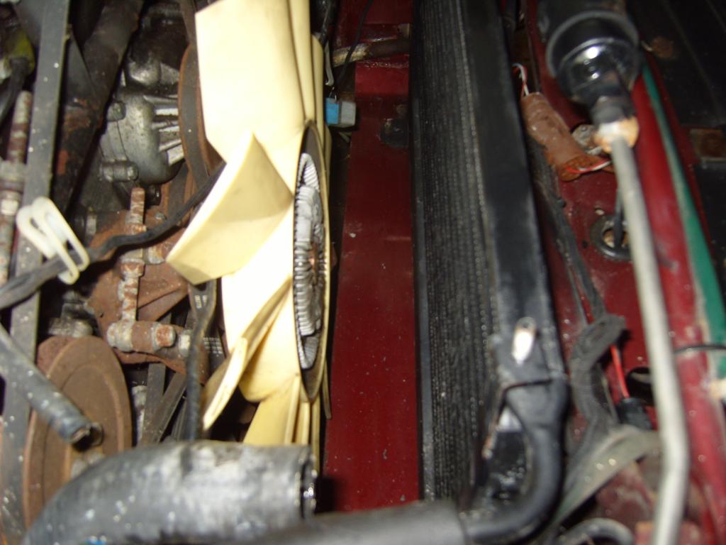

But before you start to pull it apart, when you turn the Engine OFF that Big Yellow Fan (the mechanical one) Should stop dead!
If it seems to Spin on for a bit, the gizmo that's behind it needs replacing and just in case your wondering, they don't give those away in packets of Cornflakes!
With the bonnet/hood Shut and the Engine Running, that Fan should kick up a Storm and if you are on grass, you will see the grass moving, at the side of the Car.
As 'Greg in France' has said before, it really blows a Gale so if you need to dry your hair now is your chance!

Either get the Rad flushed out, where they might be able to do it in Situ or go for the belt and braces option of a full re-core.
That of course is up to you but I would go for the re-core if it were me, which in point of fact is what I'm doing on my own Car.
By the time they have re-cored the Rad, if you go that route, it will probably take a week all in to get the Car back on the road.
Which will give you the chance to clean up the engine bay and fit the new speedo etc.
Also check the Steel Beam that the Rad sits on, as this also holds the front wings together@'Greg in France' which was something I found hard to believe but it does!
So now is the chance to clean it off and give it a good coat of paint and fill it with 'Wax Oyl'
Don't be frightened of doing the Job, all on your own if you have to, as I've probably got less mechanical skills than many people on here and so if I can do it so can you.
It looks a lot more daunting than it is!
I'll try and put a pic up of the Rad if I can find one, so you can see where the oil connections go.

I knew the other lugs on the Rad, carried Oil from somewhere but couldn't remember if it the was gearbox or power steering, so thought it was better left un-said than to leave Paul scratching his head in case I got that wrong.
So thanks for clearing that up 'Greg' aka ('Greg in France')
As for taking the bonnet/hood off, I wouldn't want to risk it, in case I graunched the paint work, or the person/s helping me did, although there must be a Safe way to do it, that is unknown to me.
But if the Engine needed Major work then that could be a very different story.
With the bonnet/hood tied up in the Air just on the point of balance, I found I had a lot more room to work than I first thought, so for that reason decided that I wasn't prepared to risk removing it.
Cardboard or even a blanket, laid on top of the engine, then one person on each side to carefully lift it out, then turn it over flat side up and lay it down on the blanket or the cardboard you put on the engine.
Avoiding any linkages connected to the throttle in case they get bent.
Then either lift it out of the way, or else walk the whole thing right off the back of the Car.
You can see the 'Gearbox' oil connections just on the right of the Pic, with the brass connections (though yours may be push on ones@'Greg')
Also get at 'least NEW Bottom Hoses and NEW Stainless Steel Hose Clips.
On the Far side of the Photo you can see the Rad Hose with another one coming off it, get the Bread Knife out and Cut it off! or you will be there for ever unless you are very clever or get lucky.
After a good clean up She looks a lot better.
Take care not to damage the 'Skinny Rad' or kiss your Air Conditioning 'Good Bye!'
Quite a bit of room to work with the Bonnet/Hood tied up in the Air.

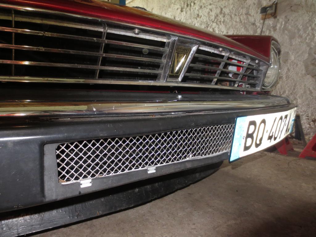

And rather than take the Grill out (which is the preferred option) instead I was very careful and decided to leave it in place as the screws that held it in place, were far too corroded to get out.
