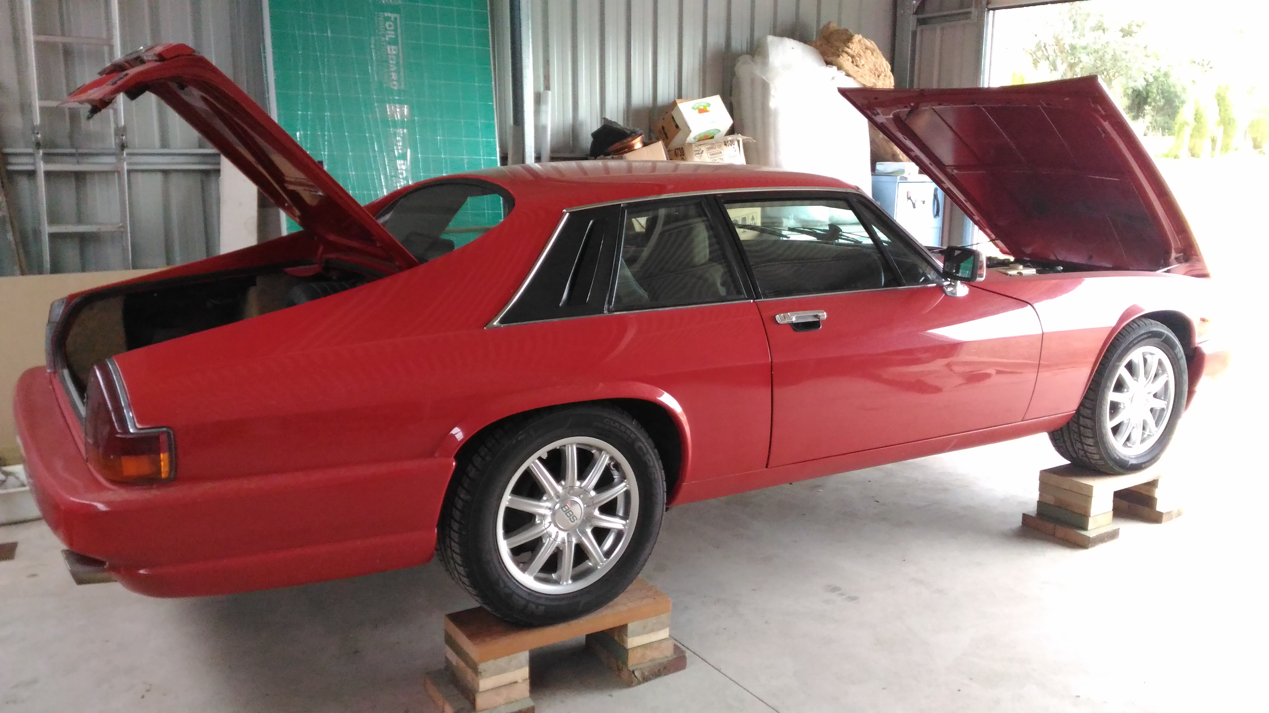

I jack under A but do not use jack stands, I use 250x50mm hardwood planks under the wheels. This gets the up very high 1m or 40".
This is cute. Not sure if I will have enough patience to build it up like this. Maybe some day...
Took about an hour to make this with a drop saw. I already had the timber left over from my house.

Originally Posted by JagCad
But, your system is OK, unless you need to remove the wheels.
Carl
If I need to remove wheels I have 3.5ton jack stands, and if I need to get under the car with wheel/s removed I also leave the jack under either the front or rear subframe. I never remove all 4 wheels and get under the car so I always have the platforms at the other end.
