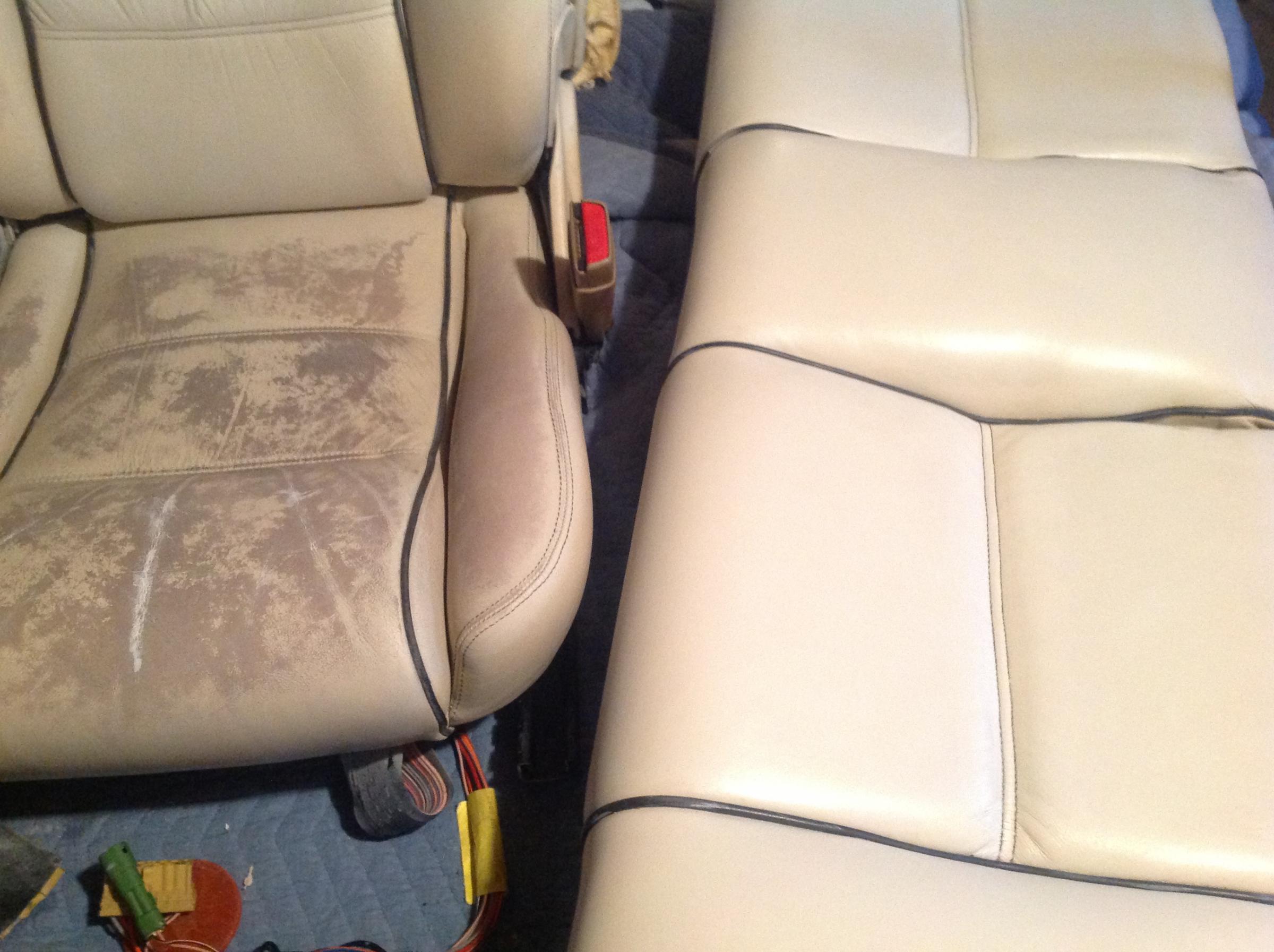

Been working on the seats when the temperatures in the basement aren't too cold. The rear bench seat was in the same condition as the front passenger seat.
Attached Thumbnails Ready for the cruising, anything new on the cars?-re-paint.jpg

Wow!! The back seat looks Great!
What did you clean it with to get that result?
Or did you make new covers?

Thanks LnrB.
I started out with some wet 600 and 800 grit sandpaper to remove the old paint. Then, over the course of a week, 4 or 5 applications of Leatherique Rejuvenator. Cleaned it all up, filled in some cracks with the Crack Filler and "painted" it using the wipe dye technique (from the Leatherique website).
