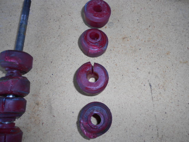

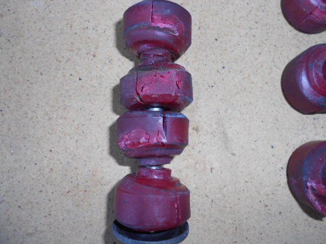

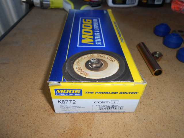

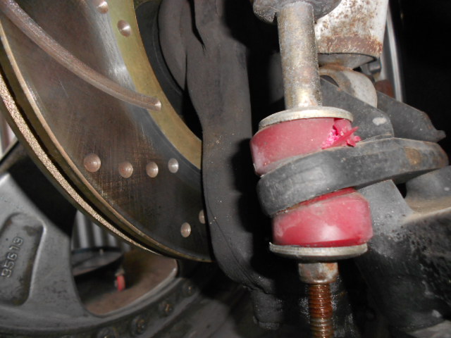

i posted this a bit ago, pix of bar bushings poly type about 2/3 years old!
i now use MOOG parts for bushings!
Moog is pretty widely accepted as good stuff.
There are loads of poly bushings, silicone cooling hoses, and other 'trick wazzoo, double throw down' parts being sold that are junky. Originally, ages ago, a lot of this stuff was legitimate but suffered the fate of 'becoming all the rage'. When something becomes all the rage you can bet your bottom dollar that every shyster and his brother will start producing a low-grade version.
