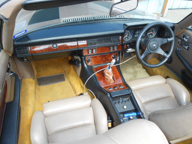

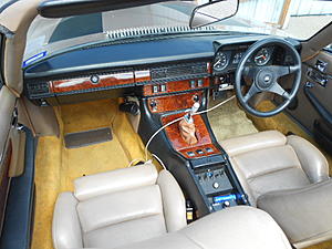

Forced air , is your car a 6 cylinder,no engine pix?
my James Bond panel,LOL,LOL
control panel in center glove box, engine start white button , 1st switch on right is power up the center panel and pilot lite .
far left is fuel pump on,injectors priming.
next going right , is computer on.
next is ignition on.
next is auxialary fan on, large elec fan is automatic temp controlled.
push start button, engine starts.
kinda fun and great conversation, small rear box has knob to control RICH OR LEAN MIXTURE , visual by AFR gage to left of center panel! tune while you drive!!
all this 24 years back.
if we were closer ,we could race our cars, some great OPEN hiway in west Texas , run out 130/150 MPH, for like 1/2 hour steady, see if you run out of NOS, or run out of engine 1st.
only kidding, but late at night the local fast guys , are runnin over 200MPH.
things are getting tricky with the law tho, old fashioned street racing is getting dangerous with cars that are TOO fast!
You have made your cockpit a very unique one and so are your highly convenient headlights, considering how poor the stock lights are on the XJS cars. -- In regards to my engine it is the straight six AJ6 motor. I wouldn't be sure what the car would do at 150 mph for 30 minutes. One thing to keep in mind is that nitrous is mostly used to add acceleration for 1/4-mile drag stints because its acceleration from zero is brutal. It is not used for longer races, except (if the rules allow you) to use it for the crucial moment when you want to pass or to cross the finish line. I haven't heard of anybody attempting a sustained long run using nitrous, not to mention that in longer races the bottle is not going to last long enough. But, besides nitrous, the kitty has the head ported and polished and wide open exhaust components and an alternate air filter route to the intake, all of which become alive at higher rpm's, so the kitty's higher speeds behavior would be interesting to be tested...
Yes, around here (SoCal) we're having lots of bad accidents reported almost on a daily basis from kids running their highly tuned machines at night and at very high speeds for the street. They all believe that they can safely emulate Paul Walker and Vin Diesel movie role guys.
I wonder if yours and mine are the only XJS cars with an engine start/stop button... I designed, built and installed mine from scratch, except for the button itself, but that I still had to internally modify; fully self contained, interfaces with the OEM security features. Great conversation? You bet it is. You asked for an engine pic, here's one. The blue and red little devices are the Wizards of Nos (UK) nitrous and fuel pulsoids, i.e. pulsating solenoids that allow for control of the injection signal via modulation from the nitrous digital controller in the cockpit (pic of which attached), all UK items that I never saw with this technology from US nitrous mfr's back when I acquired this system. It works great and it provides one heck of a lot more than just a smile in one's face... The kick on your back is stuff of (XJS) dreams, as it no less than matches my XJR's 5.2 seconds.
The red and blue little cylinders are the fuel and nitrous spulsoids (i.e. pulsating solenoids)

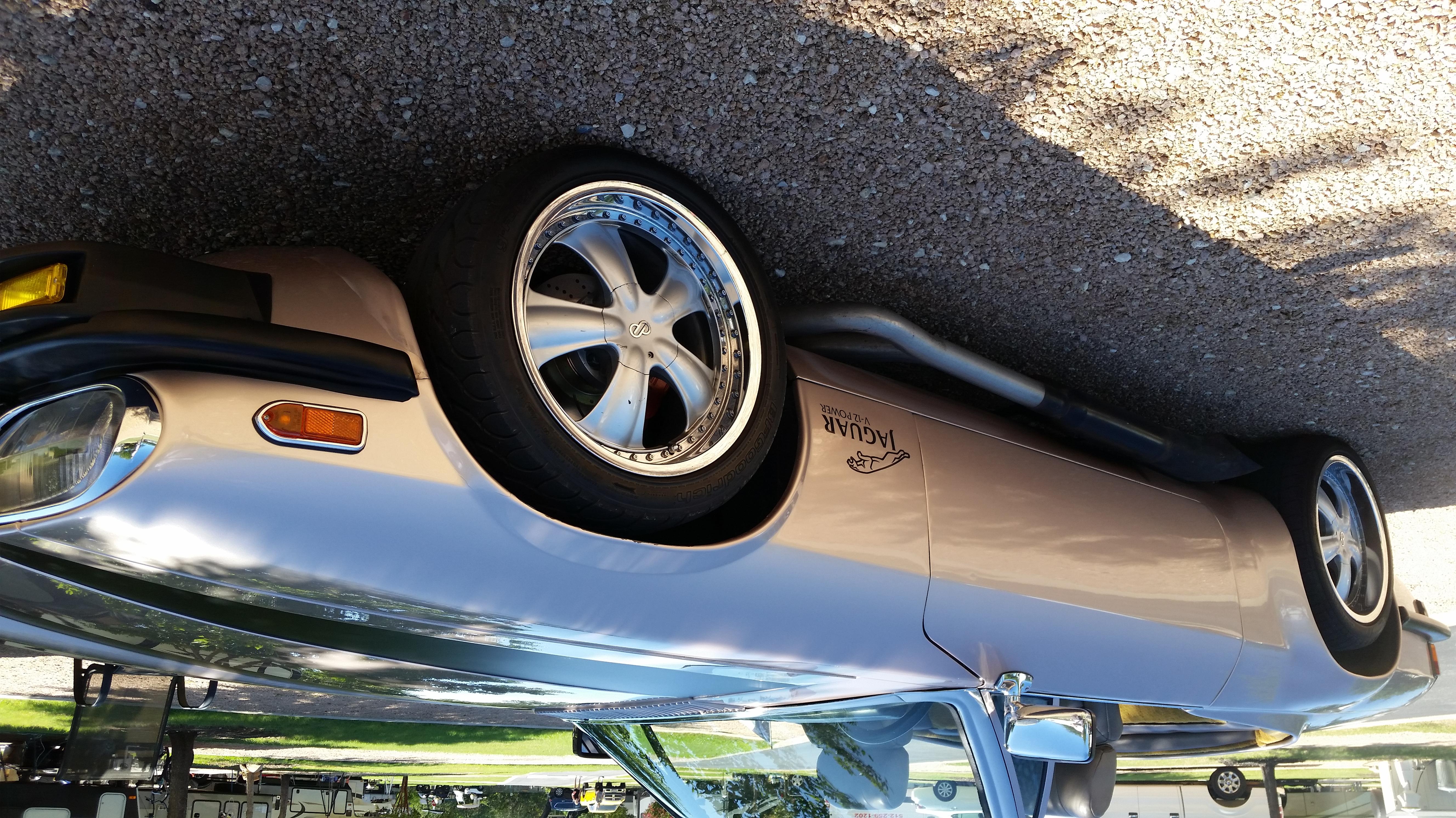

this precludes any soft music, LOUD exhaust side pipe, 5 inch diameter!

very odd thing about this site,, if i sign off JF , my pix come out right side up???
i go on as guest, and it works!!
But why? That doesn't sound right to me, especially turning an attachment 180 deg upside down? Perhaps a moderator may be able to resolve the issue for you.
BTW, those wheels look really cool on your XJS, very nice.
