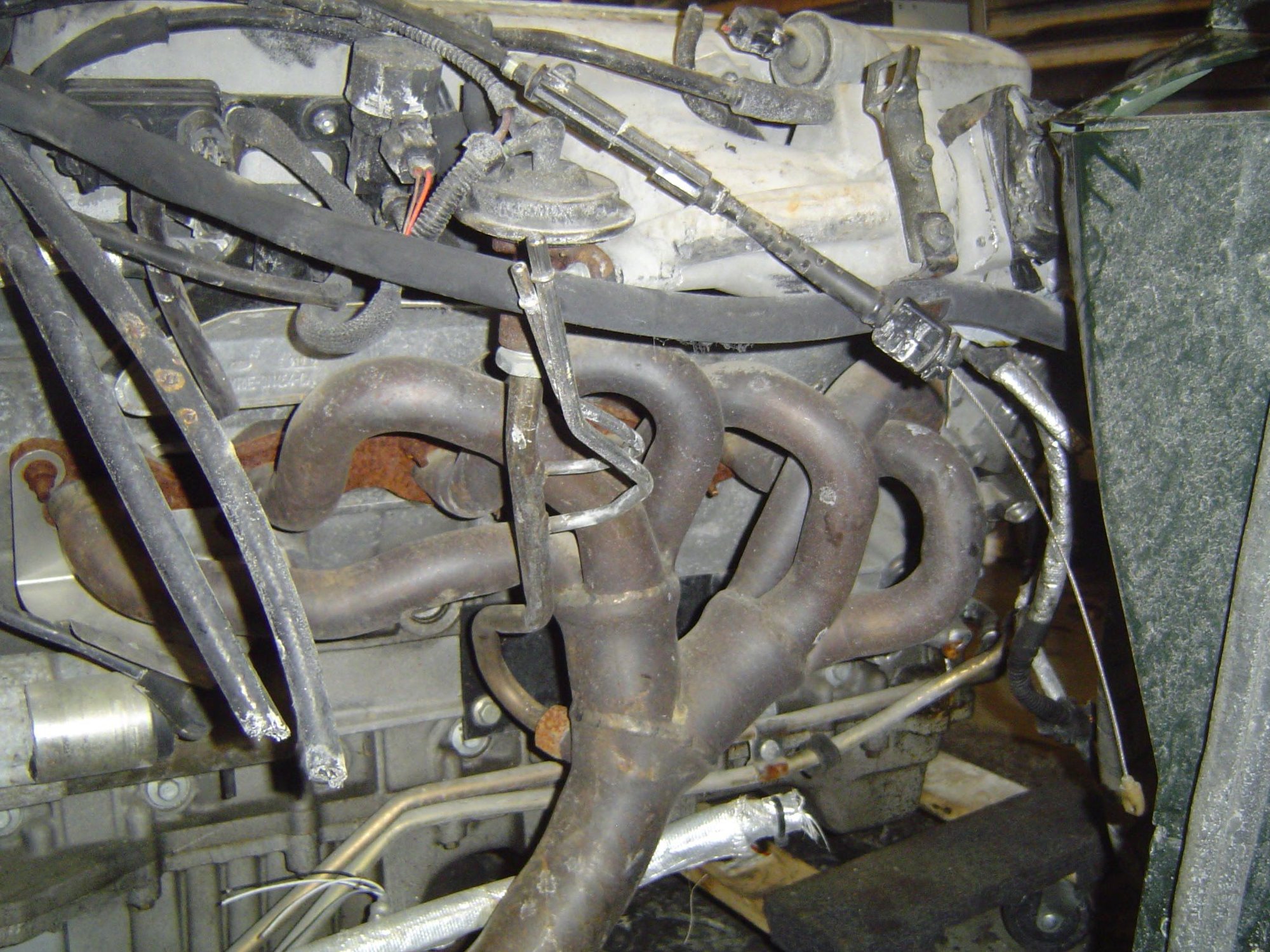

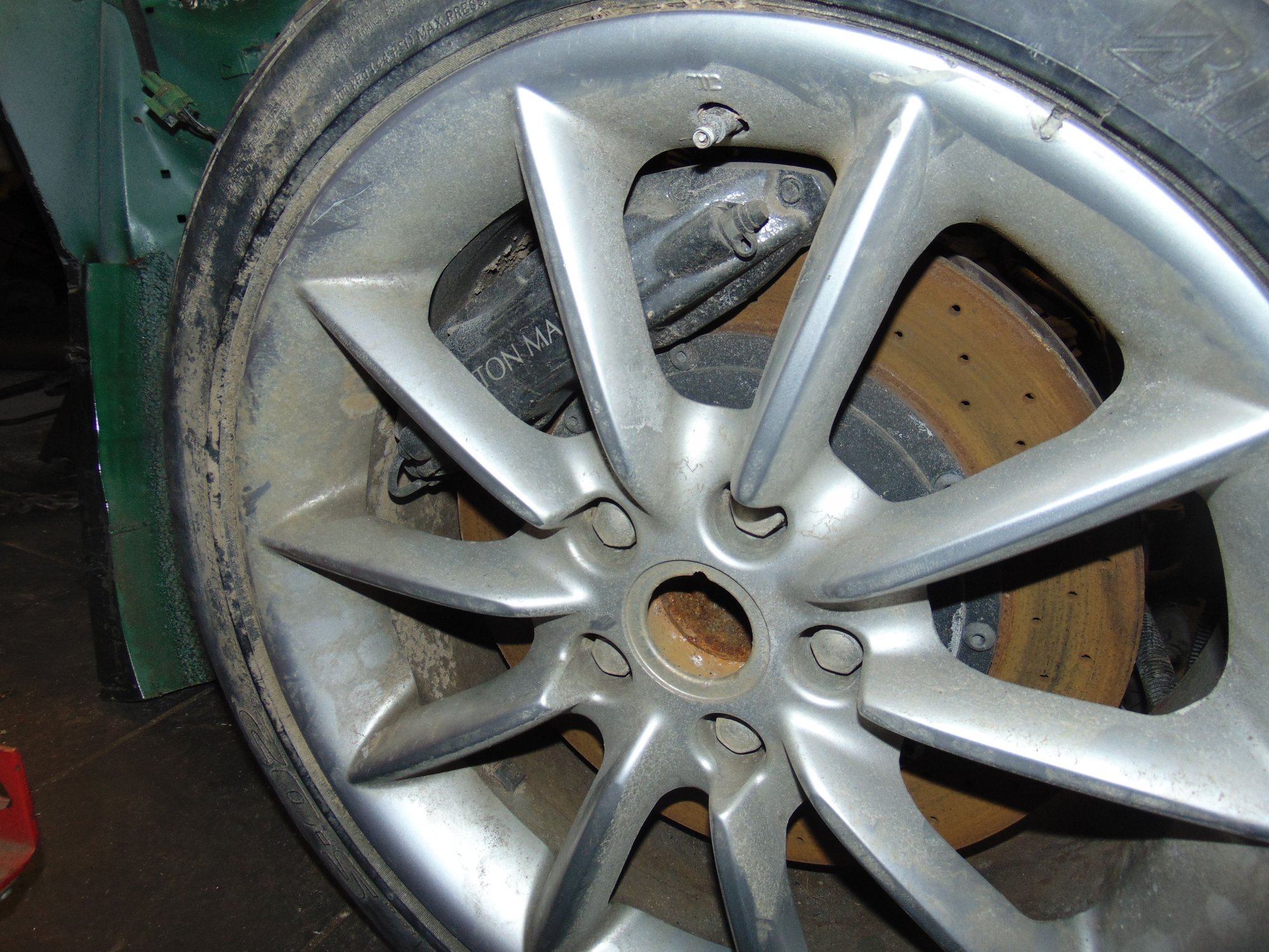

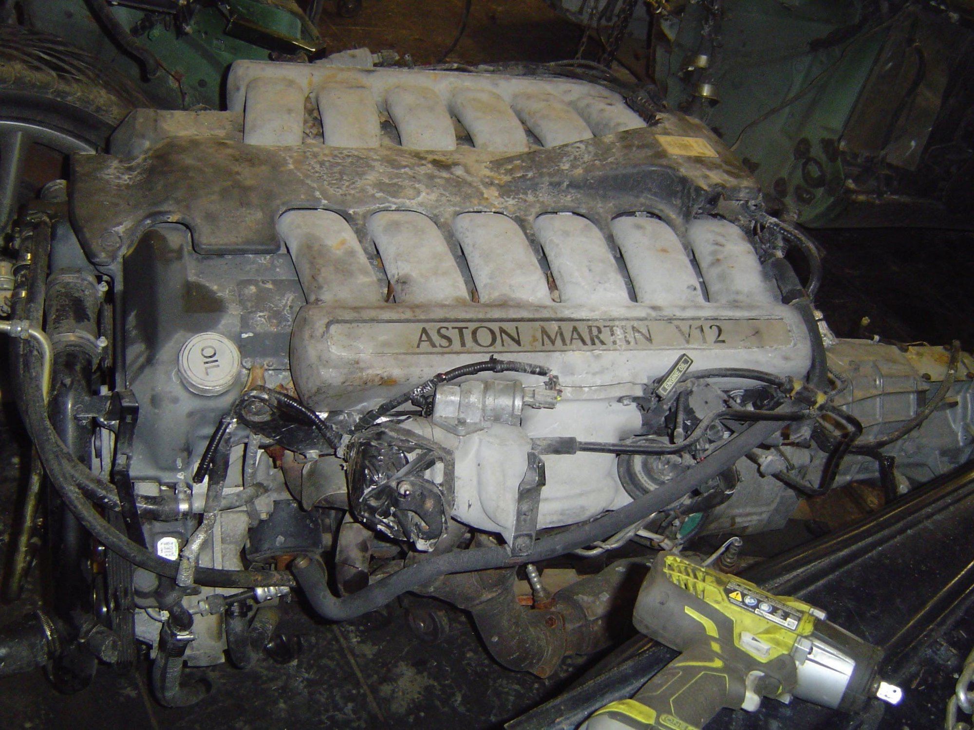

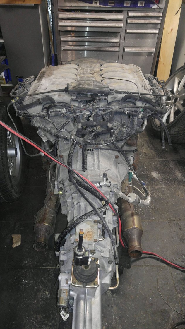

I think I got this one covered. I bought a badly crashed Aston Marton DB7 with 5881 miles. There was a battery fire in the trunk so the FD covered the car with soda. It will all clean up and I'm still dismantling. Has all the good stuff... but I don't know if it's all going in an resto-mod XJS or XJC at this point. AM was owned by Ford at this time so I'll be using 2 Ford Mustang V6 engine control units just like Aston did. This will interface well with the existing sensors. It will have sequential injection and coil on plug ignition. And... its all gonna fit becasue XJS, XJC and DB7 all use the same platform. Gonna be a hoot!
5.9L v12, 48 valve with equal length headers.
T56 Six Speed
3.73 rear gears.
Brembo Brakes with 14 in Alu hat front rotors.
2.5 inch dual exhaust.
Sport rack
Locking Diff
Bilstein Shocks.
18 inch wheels
I've done retrofit ABS, chassis stiffening and NVH abatement on other coupes, so that will be proforma.
I've learned a lot about high end auto construction too. The Db7 is a XJS on steroids. I got to learn how and where they reinforced the chassis and saw the techniques and materials used to assemble the car to a very high level. I will apply all this to my next and current XJC project.

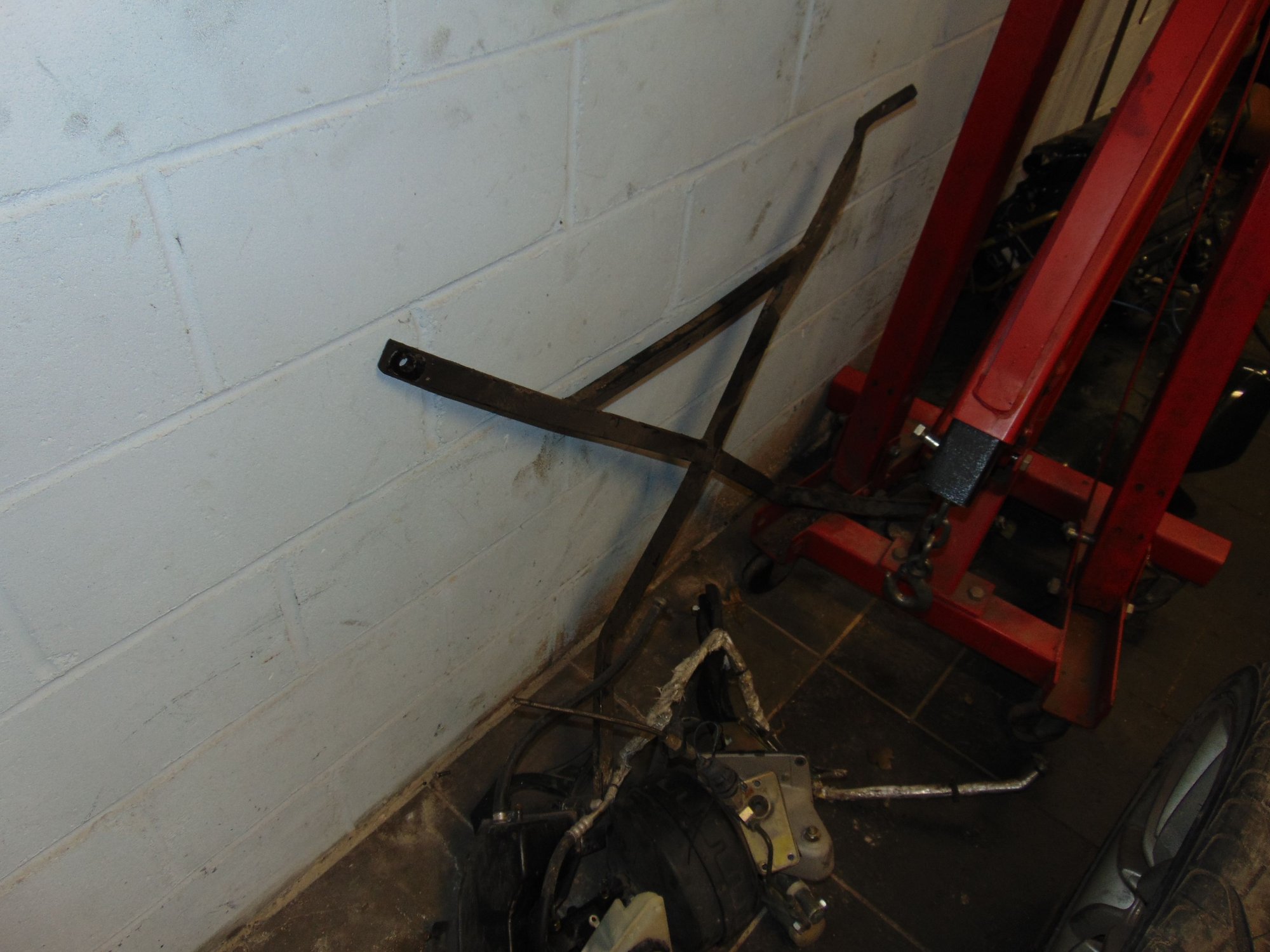

Mangled front brace. Will use as a design template. 1 x 0.5 x 16ga rectangle tube is on order and will make one for my red coupe's up coming track day.
T56 is from a Viper, known to be a good variation of that box.

@icsamerica do you have a build thread for your project? Holy cow! That's the V12 that's 2 Fords welded together? or a Jag development?
Those headers!!! It's gonna sound GOOD.
Sound good...I think so. I've got a bi-mode exhaust planned too.
I think it is 2 Ford's but I don't know which one. Perhaps it's the 3.9 V6's front to back or two 4.0L I6's side to side, and destroked. That would make sense from a manufacturing stand point becasue modular engine design was all the rage at this time. I'm fairly certain if Jag continued on with a V12 it would have been this engine. Kind of like the Audi S8 had the detuned Lambo V10. No way for me to know that fore sure, though.
I dont have a build thread yet becasue I've not made up my mind weather it's going in a XJS or an XJC. I already have another XJC in a sorry state but was considering an XJS becasue the chassis structure is way better to start with and that would get the car on the road sooner. The chassis of an XJC with 400+ HP will need lots of work to feel right and that takes lots of time. For now, I will wait and see what opportunities present themselves as it's not a desiccation I need to make at this time. I'm still working on my other Series 2 coupe / XJS hybrid and will need lots of time to get v12 the engine running as it sits.
The whole donor car was very cool and assembled in a hands on low production way. For example there are many place where an item would have two fasteners and one side would have more nylon washers than the other so it fits in a perfect way. Lots of black tape, wire ties and black silicone, and black windshield ribbon holding everything together. It's all very personal and aspirational and clear the designers and assemblers were struggling to make a great car out of what they had available to them.

The Aston V12 is two Ford Duratec V6s welded together front to back. Great engine.
Old Feb 9, 2018 | 10:52 AM
  #40
icsamerica's Avatar
Posts: 2,291
Likes: 1,466
From: New York City
ICS
Thanks, good info, so it's a AJ30 too. Good to know. That opens up some performance and parts options for me. I read on the interweb that a fully dressed Durtec V6 is 365 lbs, so if we add an estimated 300 for an additional bare durtec we can extrapolate 665lbs. Add 200lbs for a t56 and clutch... and at about 900 LBS as a package it's reasonable considering it's an exotic.
